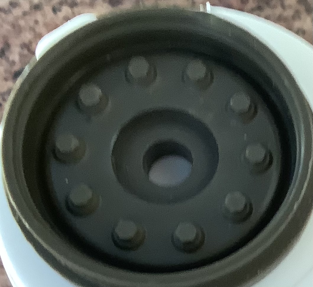

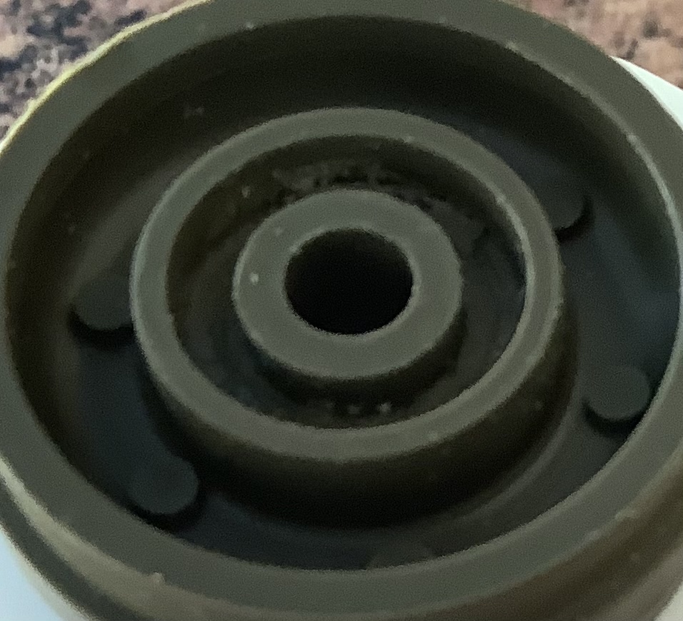

Can we see a picture of the item, with the hole you need to enlarge.

Thank you, indeed by successively drilling different diameters, maybe less risk of breakage? that's what scares me a little, especially if the forest has teeth? I think it is preferable to proceed at low speed with a strawberry system, lest the plastic heat up and it will jam again, thank you for your advice.
