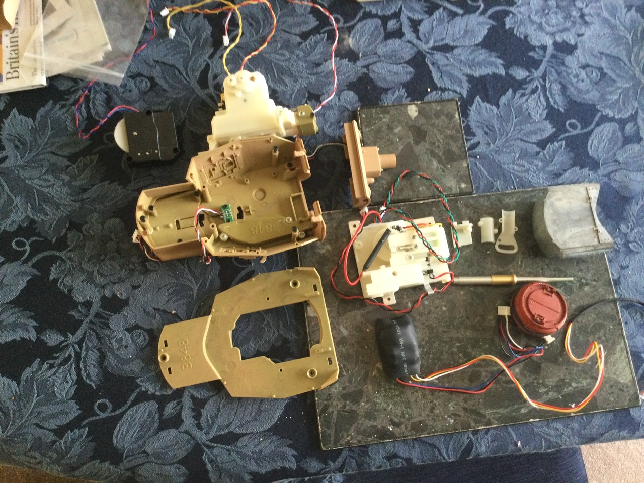

Well, finally managed to get my hands on a recoil and flash unit along with a scale L42 barrel, the problem is no instructions and I can’t find any posts where someone has fitted one. There is a picture on the Welsh Dragon website but I think it shows a butchered bb unit as part of the build, has anyone fitted one and can offer a guide? Save me working it out for myself and possibly ruining something expensive!
I’ve got the hull sorted and painted, just need to build the turret, pic shows the dismantled turret plus the bits to go in. I am ok with the turret bin but how the recoil unit fits is eluding me

take the bb feed channel out also the ir receiver plug might foul the motors and it looks like the recoil unit has a metal plate on it ?
Also your bb gun looks like its for a heng long v6 ?

You are right it is a ver 6 tank. It looks like I’ve been supplied the wrong kit as I can see on other sites that there should be some trunnion mounting brackets supplied that don’t match the item I got. Have gone back to Tankzone to see if I can get it resolved. As it stands the unit is too large for the turret, but if comes down to it I can still use the new barrel and I can squeeze the HL elevation motor into my metal turret bin

That looks like a Taigen recoil/elevation unit which will not work with an H/L V-anything MFU.
You have the flash and connection parts to go from barrel to recoil, but without the rest of the compatible electronics, it wont work.

The recoil units are all the same they just come with different fitting depending on what tank you order it for the 1 you have looks like its for a tiger. They will work on a heng long v6 you just need to rewire it a little

Hello
https://www.rcuniverse.com/forum/rc-tan ... r-3-a.html
Explanation mounting (mechanical) Asiatam recoil, on a PZ III so ditto Tauch Panzer, only concerns the modifications made? for the wiring on a new plate, repeat what is said above. On the other hand, am not sure that the flash is housed in the end of the barrel? see diameter? Personally I had put a Led flash
