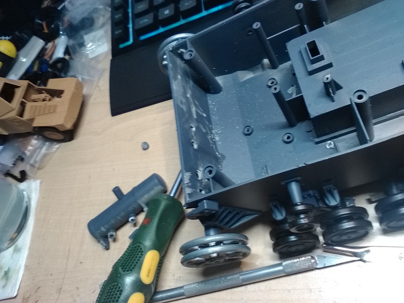

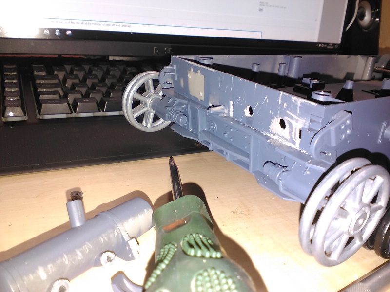

Re: That Pesky Panzer IV Muffler
I was about to suggest secret option B - Razor saw, scalpel and a large flat bladed screw driver, just took me all of 10 mins to cut one off and clean up:

Thanks chaps. I wish I had had that razor saw. And a special thanks to the Tiger for serving up his own Pz IV as a guinea pig. As for the debonder remedy, it has worked for me in the past, but I swear, H-L soldered that muffler in place. Thanks again, chaps.

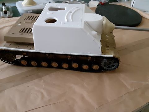

Now you've thrown a monkey wrench into this build, Tiger. I wasn't planning on repositioning the idlers, but I believe the drive sprockets are too low on the chassis, and Mr. Jarndice is going to have a fit unless I do do something to the slope of the rear deck. But, yes, the battery box will be lopped off, one way or another.
Here is the beast in question.
Thanks again chaps. Your input much appreciated.
