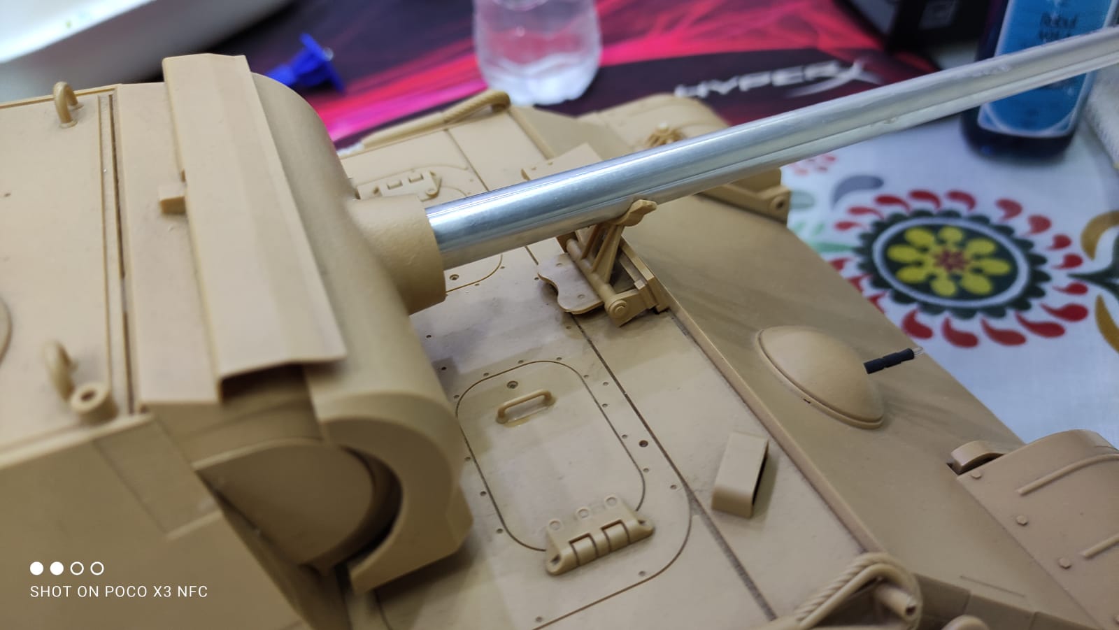

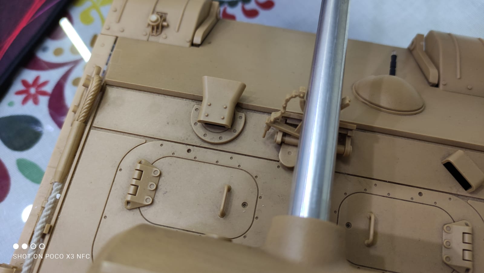

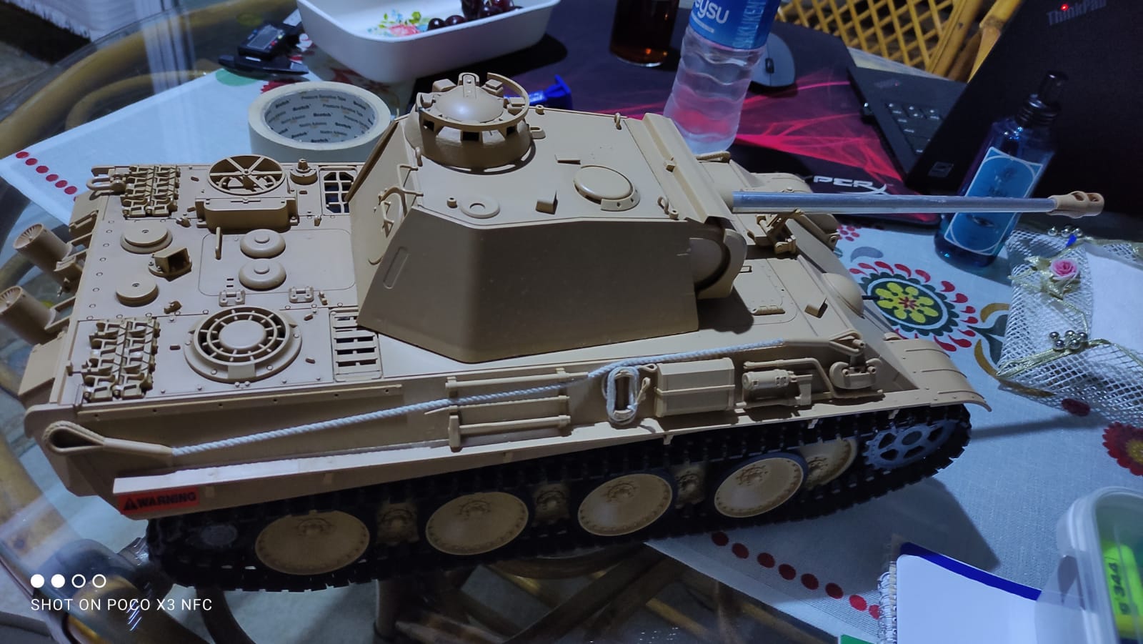

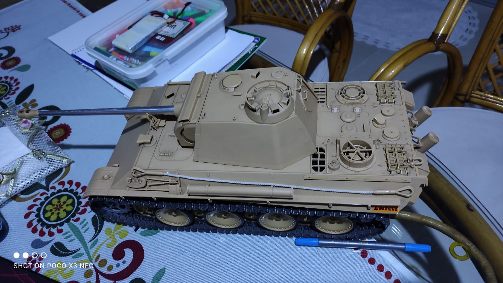

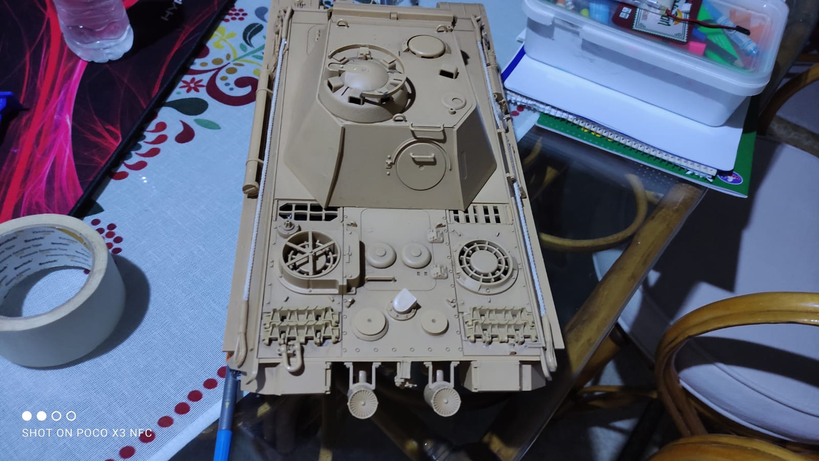

Here are some photos of the upper hull.
STHV
Posts: 273
Joined: Thu May 17, 2018 9:47 pm
Location: Hertfordshire, UK
Re: Tamiya Panther restoration questions
Post by STHV »
That honestly looks fine. The only broken parts I can see are the gun travel lock, the barrel cleaning tube, the spare track holders and the headlight as well as missing hubs on the sprocket wheels. Other than that the previous owner has put the muzzle break on sideways or the barrel is just loose and has covered the rear air intakes with spare track both of which would not end well on the real vehicle.
Fitting a Heng Long or Taigen upper hull would just be a downgrade overall.
