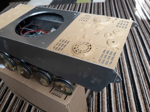

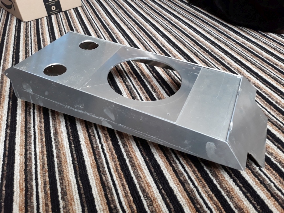

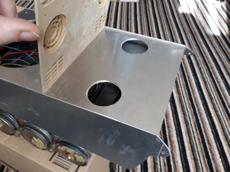

I have three RC tanks, two 1/24 tanks and one 1/16 tank. The latter is a King Tiger by Tamiya that I'm currently building an aluminum upper hull for. I like customization, making something unique, so I decided that I will give the finished KT a new look. I've accumulated mostly everything for the project and look forward to sharing it.

WOW and welcome!
It certainly looks like you've got that Tiger by the tail! :thumbup: Very nice work sir.

Thanks! I think the Tiger got me. Was not easy cutting the turret hole with a Coping Saw haha. England, UK.

yes, the hull is coming together rather well despite the lack of tools for the job.

Whoa! :O Now that's sprezzatura: I'm new to this, so I think I'll try something easy, like a whole aluminum hull.

The good thing about the King Tiger upper hull is that it's made up of 5 straight panels. Cut out the panels, bond them together with some epoxy putty and you have good sturdy hull to match with Tamiya's sturdy aluminium chassis. Tamiya make a great sturdy aluminium chassis and then put a flimsy plastic hull on it, that's a shame. However, I didn't waste the plastic hull and integrated parts of it where there is detailing.
