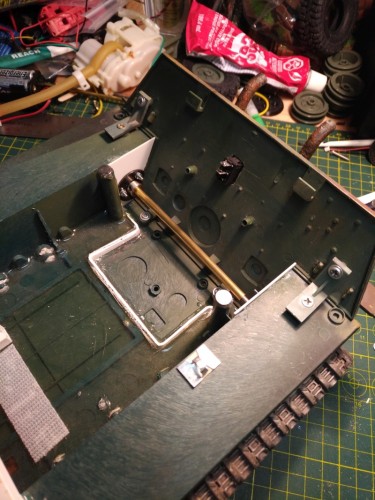

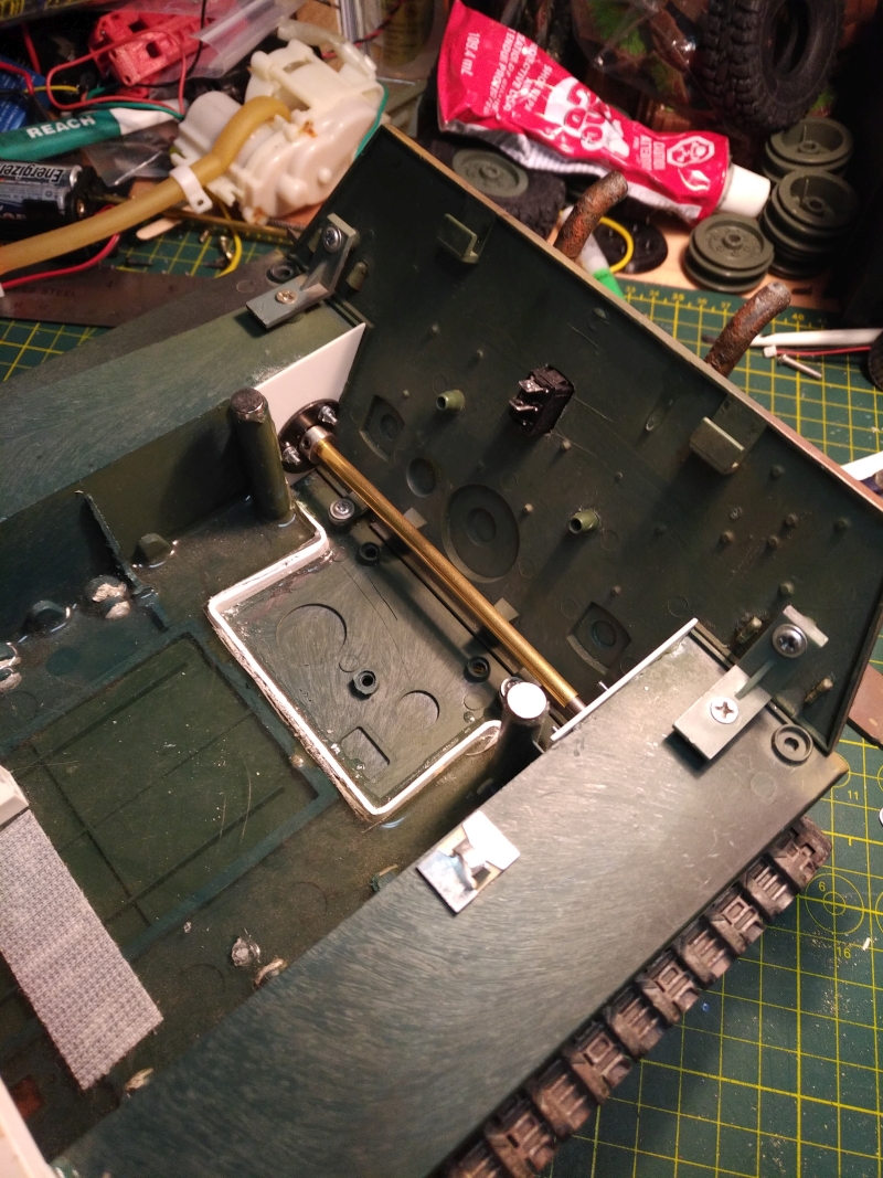

I just finished installing an aftermarket set into my son's KT.
It was bought used and has battled for nearly 3 years with plastic gearboxes and driveline.
Low and behold it was starting to throw tracks because the screw mounts were starting to crack and flex.
Metal tracks just speed up this process.
Newly installed Henntec
