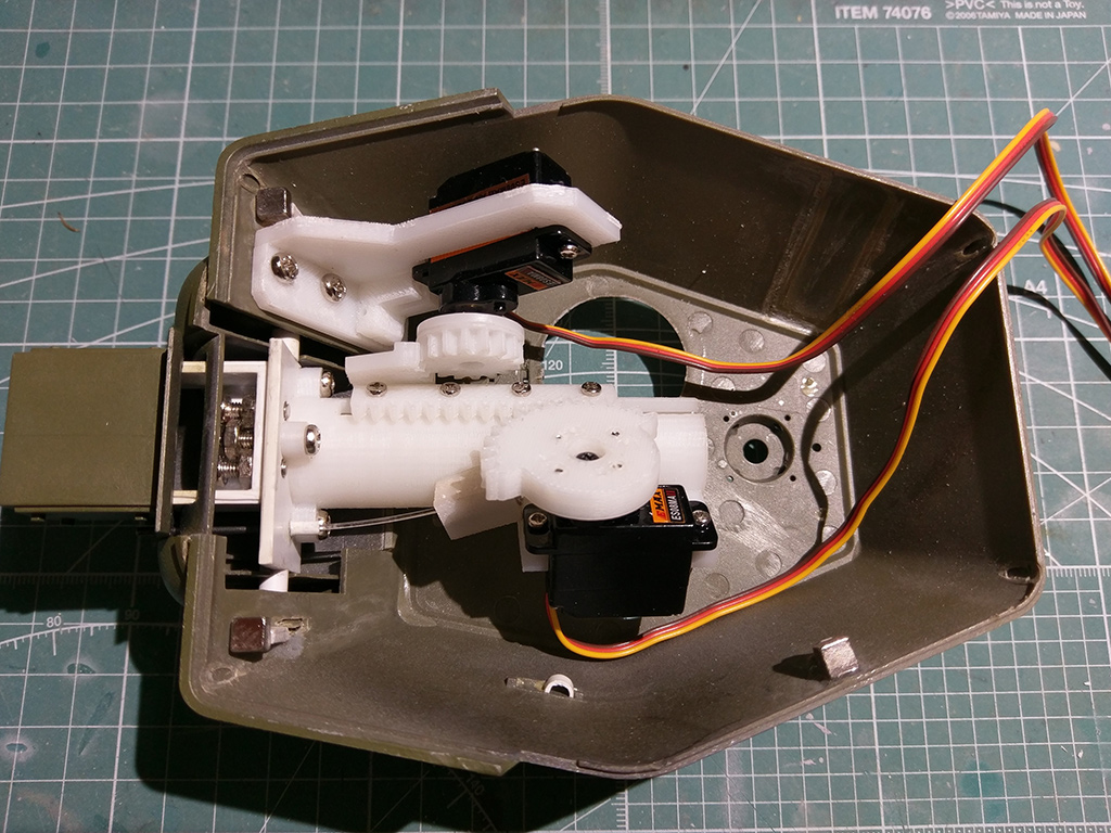

Most aftermarket boards (and even some of the newer RTR offerings) will support servo recoil and elevation. There are a number of manufacturers that do servo recoil and/or elevation units. This is one of Clark's (actually for a Tiger) that I've repurposed to use in a T-34 controlled by an Elmod Fusion Pro board:\
I've found that linkages often end up with slop in them, geared sets fit a lot tighter. They move more smoothly and don't flop around as much when the tank is on the move.

My apologies General, I'd missed your comment about the adjustable suspension rods. You're right that those would be great, I was thinking of the bent-wire linkages with stock servo attachments that I've used and seen others around here using.

Thanks guys for all your input. I especially appreciate Raminator's photo, as that is exactly the installation I need.
