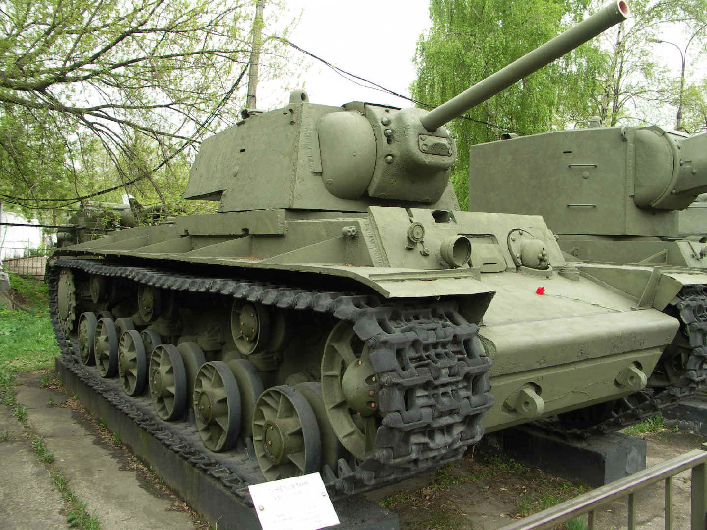

I have a feeling that some of you may be wondering what the hell is up with the large bolts I used. :haha:
I was remembering the initial KV turrets:
But now remember that the sight was bored through the mantel and its missing that little box under the barrel so I will have to fix this. See we all make mistakes :P
I have to check myself on Russian armor as I have been building German stuff almost exclusively for a few years now... :think:
These were also known as the "cast" turret as they were cast and smaller with a curve in the rear. My question to any of you who may know: were there any pics of this type of gun mantel used on this later type turret?
I found this:
and this
Most of you may know this but these tanks were thrown together at great hast during this transition period, they almost all rolled out of Leningrad and sometimes straight into combat.

I've seen a cast mantlet on a welded turret before, I think you'd be free to make whichever combination of parts you like the look of best. As you say, the exigencies of the war during the siege would have meant that everything would have been thrown at the front line and any manner of parts could be put together to repair and reclaim lost tanks.
I believe the bolted hatch under the gun barrel is to service the hydraulic recoil buffer.
