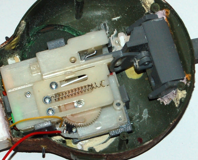

by Bassetus44
Here’s my unit, bought for my PzKpfw IV BB to recoil & flash but I fitted a full recoil / flash turret instead. It has elevation already included.

by john1970
woz has it on his website scroll down through his pictures
https://warrenhudsonmodelling.blogspot. ... build.html
Re: Heng Long Sherman recoil & flash
Posted: Sat Jun 26, 2021 9:30 am
by General Jumbo01
The build in that link shows the same unit as mine but there doesn't appear to be any elevation fitted. That's actually the tricky bit if you use the system in that unit as you must use the same pivot positions as the original position, simple if you use a separate servo with link but not so if using the Taigen components because if the limited space.
Posted: Sat Jun 26, 2021 4:20 pm
by General Jumbo01
Yes, been there, done it! It can still work with a separate servo but you'll need to use the Taigen leads that connect to hobby standard radio system and then use a spare channel for the servo. You can then link the channels to add the sound. Flysky i6 is a good, economic route but if you persevere with the geometry and slim down your fingers you'll get there either route.
Posted: Sat Jun 26, 2021 11:34 pm
by john1970
There's elevation within the unit ?
