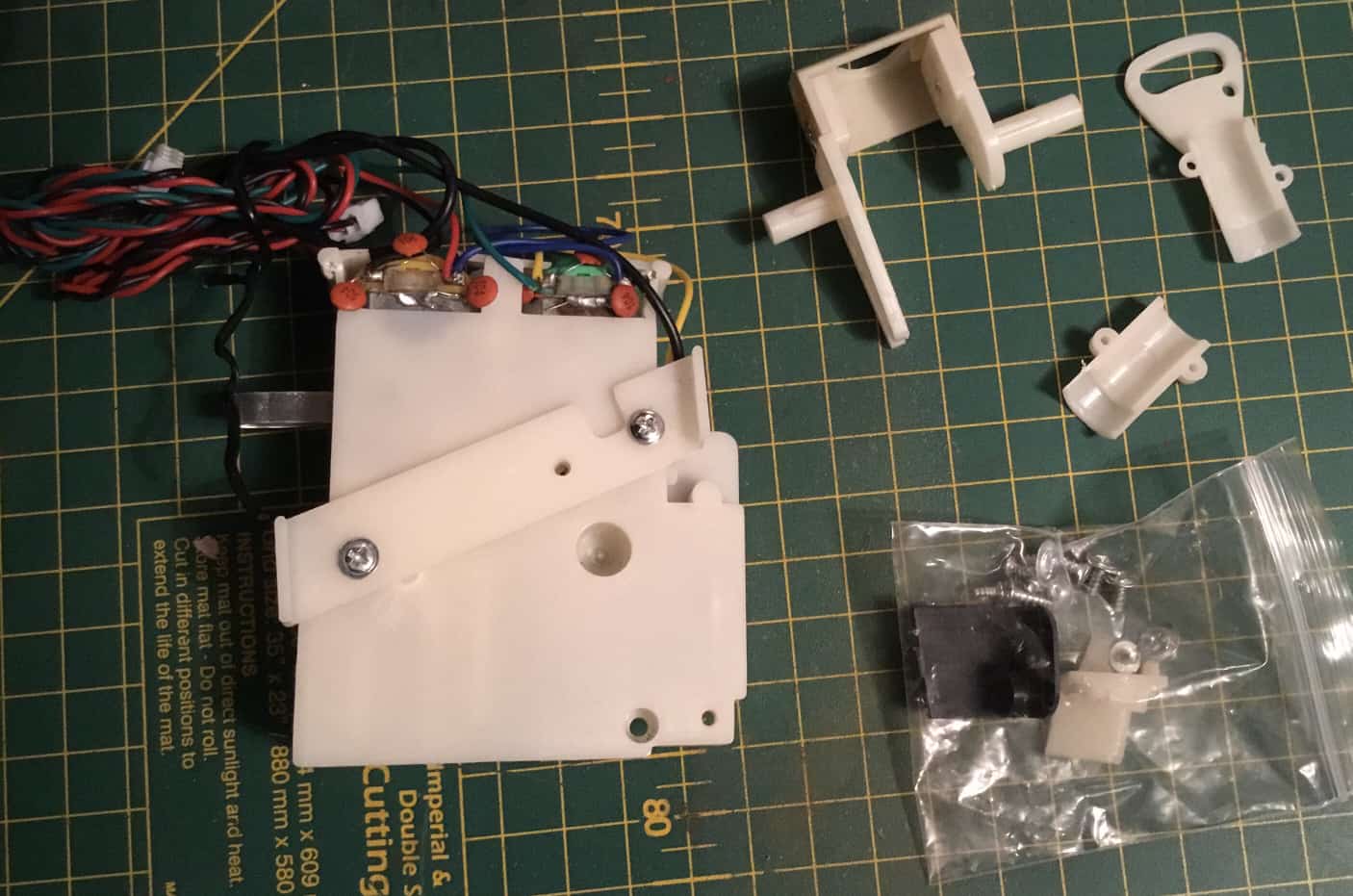

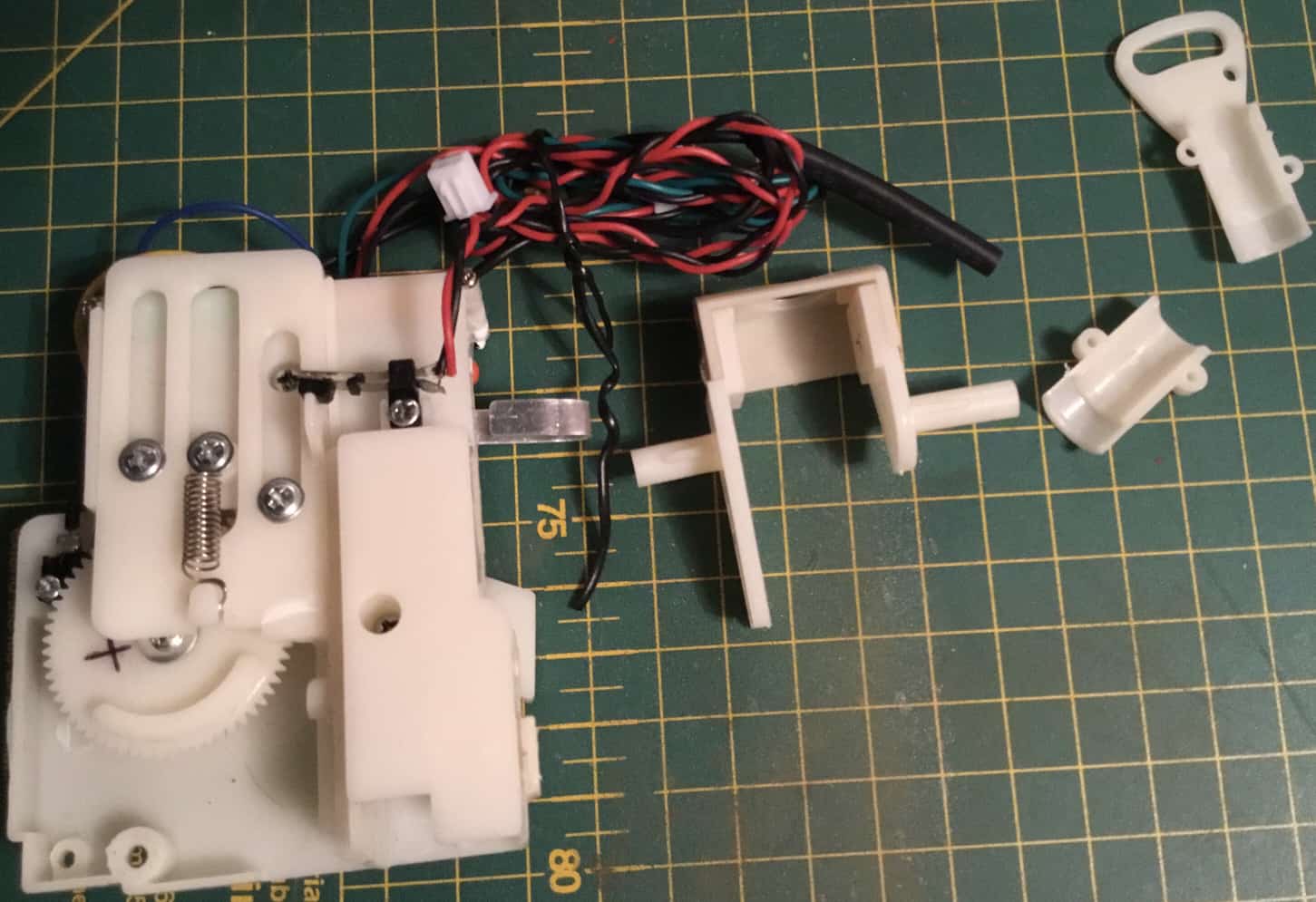

Here’s my unit, bought for my PzKpfw IV BB to recoil & flash but I fitted a full recoil / flash turret instead. It has elevation already included.

woz has it on his website scroll down through his pictures
https://warrenhudsonmodelling.blogspot. ... build.html
General Jumbo01
Posts: 1780
Re: Heng Long Sherman recoil & flash
Post by General Jumbo01 »
The build in that link shows the same unit as mine but there doesn't appear to be any elevation fitted. That's actually the tricky bit if you use the system in that unit as you must use the same pivot positions as the original position, simple if you use a separate servo with link but not so if using the Taigen components because if the limited space.
