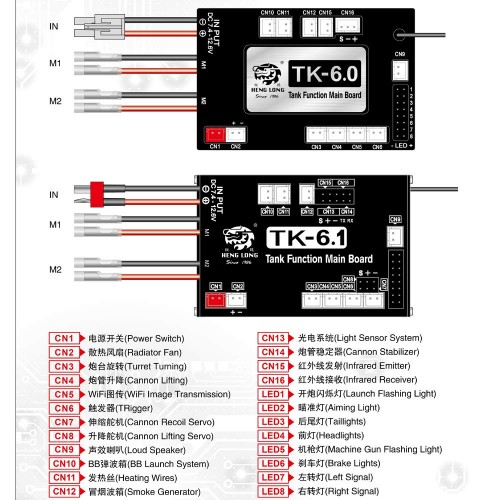

HL Electronics upgrade will not be plug and play. But if you can solder, you can make a new set of wires by yourself (cheaper and better option), or buy a ready-made set (it will be more expensive and some wires may be too short - for my requirements).
TK 6.0 (as opposed to 6.1) does not support / does not have recoil servo - so you get recoil only with a mechanism with an electric motor (usually type 130). As far as I remember, Taigen offers one, but it will require changing the connections - re-soldering the wires.
The remaining ones in this smoke barrel can be easily obtained on both.
The RX18 transmitter is not compatible with anything newer than the RX18. You need to buy the RX and TX 6.0 / 6.1 kit

Trueblue1415 wrote:My first question for all you veteran rc tankers is this.I have a H.L tiger 1 with what I think is a TK18,its got the HL dragon and multifunction unit printed on it.I would like to know if replacing it with a 6.0 unit would mean I could then upgrade things like recoil barrel,smoking barrel and all the other must have shiny bits you can buy,i understand it won't be just plug and play.Oh and do i need another remote controller or can I bind it to my existing one.That's all for now,the first of many.Be gentle with me,thanks in advance
Hey True. It sounds as though it is the 27MHz controller as you described.
All the connection to the older MFU use JST-XH connectors. So you will be needing to redo the motor connections if upgrading.
If you are wanting servo recoil, you will need to get a TK-6.1 at least (6.0 does not have servo recoil option).
HL TK6.0 vs 6.1
HL TK6.0 vs 6.1
HL RX18 - 27MHz
HL RX18 - 27MHz
