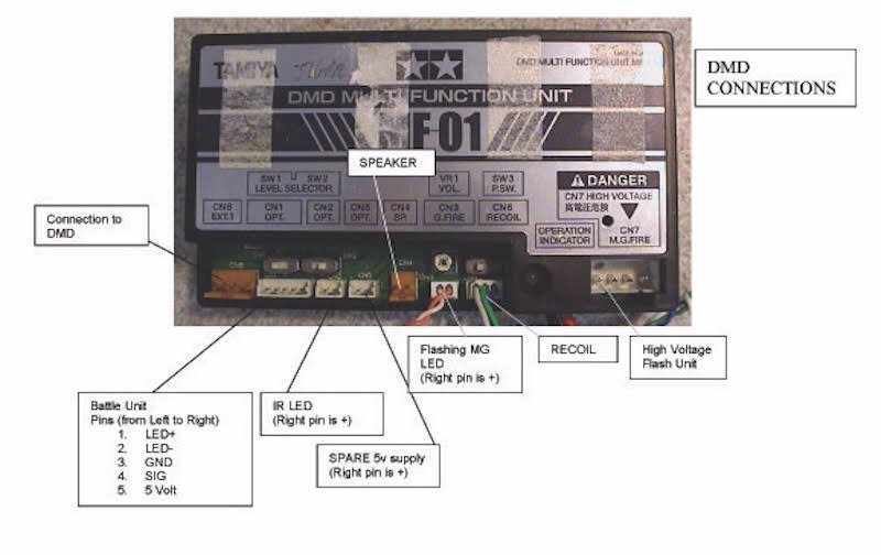

and then analyze (and maybe take measurements) the DMD circuit around CN7 - there should be 2 capacitors (including one electrolytic 300 -400V) and a diode. I have never noticed whether the LED above CN7 only lights up during the shot ... maybe it could be used as a relay's trigger in this situation? I don't know - I never paid attention to it.

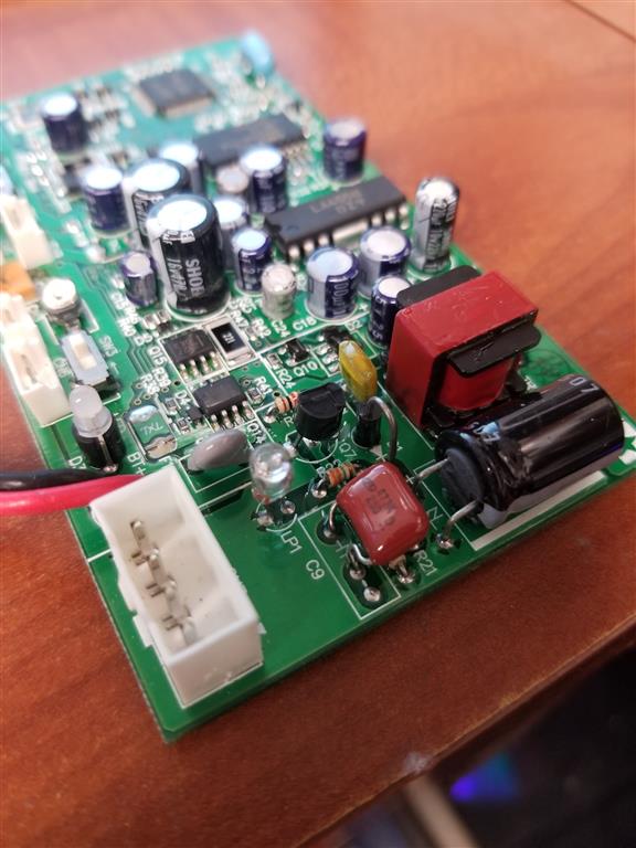

Thanks again for all the info. Looks like the LED you speak of is actually one of those high voltage Pilot lamps. I don't have the board wired up but my guess is it either lights when its charged or lights when it fires. Honestly barrel flash isn't a huge concern for me, neither of my HL have it since they are Airsoft versions. I do plan on adding the battle system to the Pershing so I can tangle with my HL tanks, is there any reason I can't hide the IR in the barrel instead of the clamp on mount?

indeed, I am of the opinion of friends, and would not take the risk of passing the HT in a slip ring? memory led esr green when the flash is OK and then flashes orange (it seems to me?) when recharging the capacitors. Attached photo with various information I doubt that it is possible to modify the existing system? or have a remote flash, controlled by a relay and synchronized with the existing firing signal ??
it exists for the Leopard Tam. this system which can be deported and uses the same flash, but absolutely does not know if adaptable, just for information
