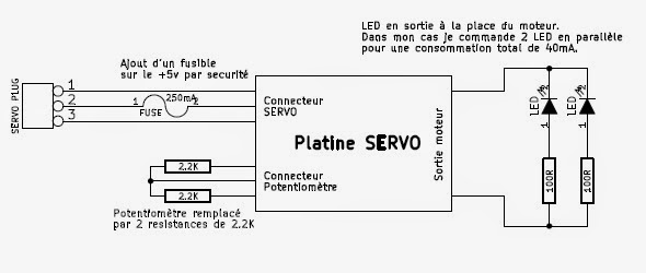

Re: Tamiya Early Tiger 1 lights
Hello
m
also this solution, a servo function bypass, removal of the motor and installation of 2 LEDs, connection to a free channel of the RX
