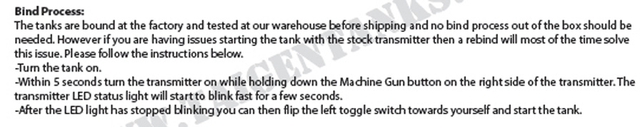

Here in the US, Imex importer of Taigen, put out these corrected instructions for binding the transmitter to the board. Maybe this will do the trick.

@Herr Dr. Professor - Yes, those are the new instructions for the new controller, but they still don't work. The tank just sits there with its headlights flashing.
