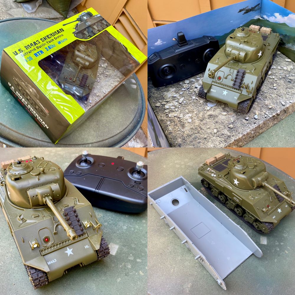

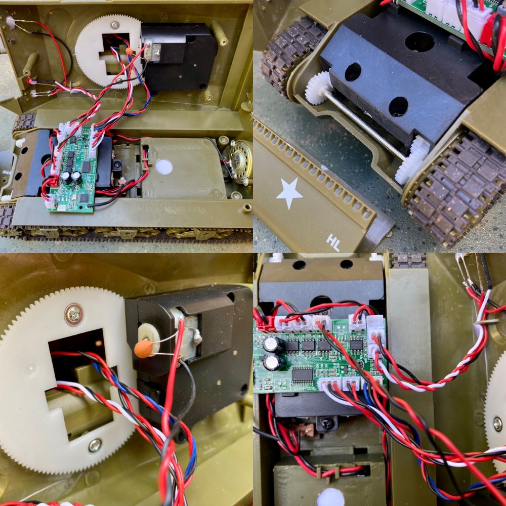

First, some photos of the Heng Long Sherman to be "repurposed".
The box it came in and it's size relative to the Panzer hull. The Sherman dissected. Upper left; the overview. Upper right; closeup of the transmission. Lower left, the turret ring and motor.. Lower right; the main board.

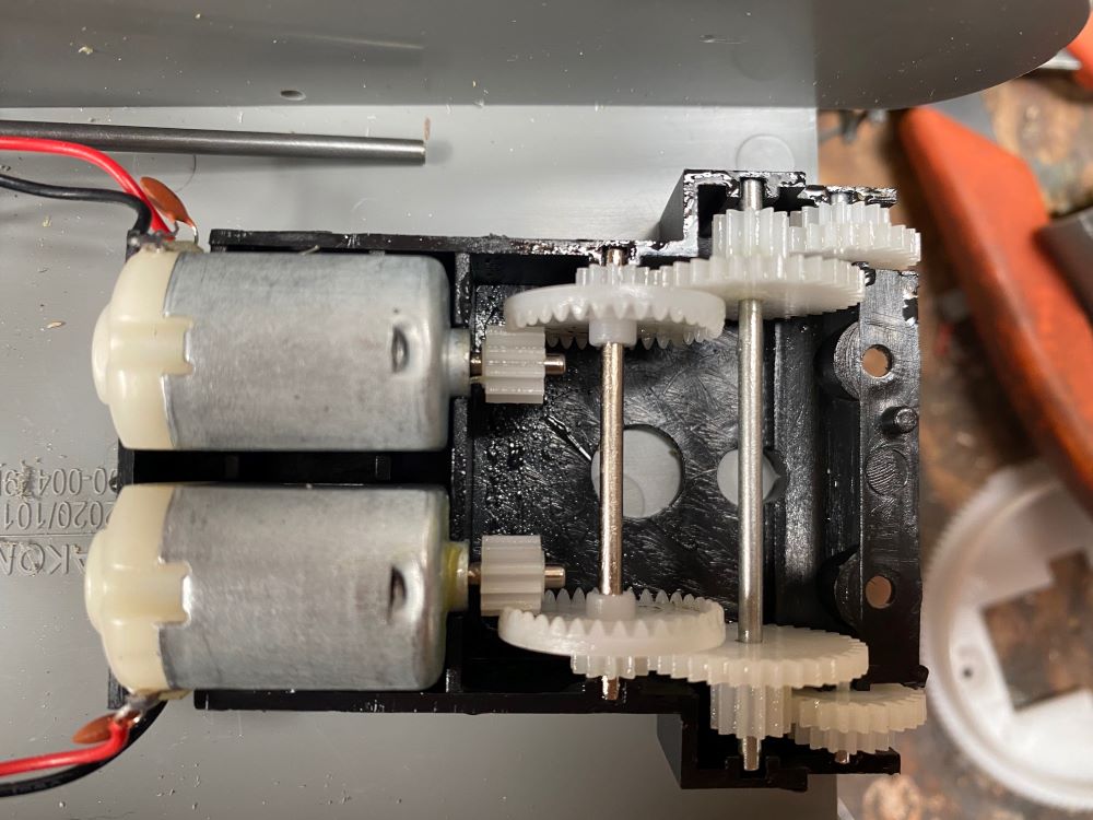

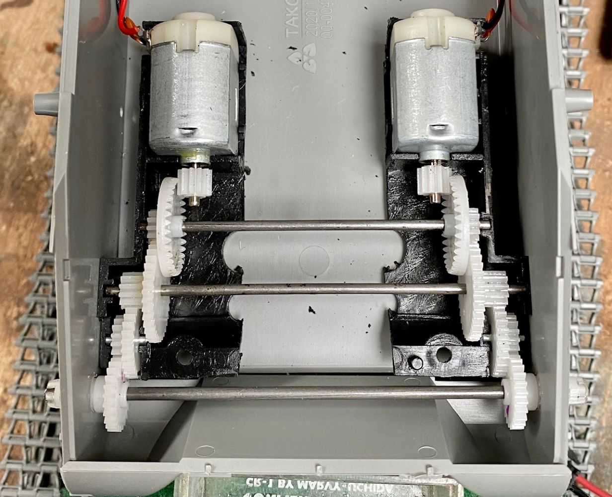

The largest task was to adapt the Sherman transmission to the P1B. The front axle is freewheeling. Each motor runs a gear train down to the last gear which is attached to the sprocket wheel.
Here is the transmission with the top off, sitting in the P1B hull. Too narrow! My solution was to split the transmission in half and make longer axles. The tops of the transmission halves were replaced later, as they are required to hold the gear axles in place.

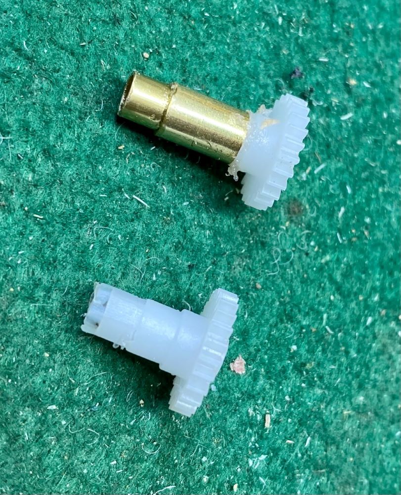

Ok, the biggest headache was to mate the now separated transmission gear trains to the P1B sprockets. In the Sherman the final gear goes through the hull wall and has a hexagonal shape on the outside which the Sherman sprocket press fits onto. This had to be altered. I did this with brass tubes of descending diameters, pressed and glued onto the final gear. I sanded the hexagonal shape off for the brass to fit over. A bolt was run through the sprocket wheel into the brass fitting.

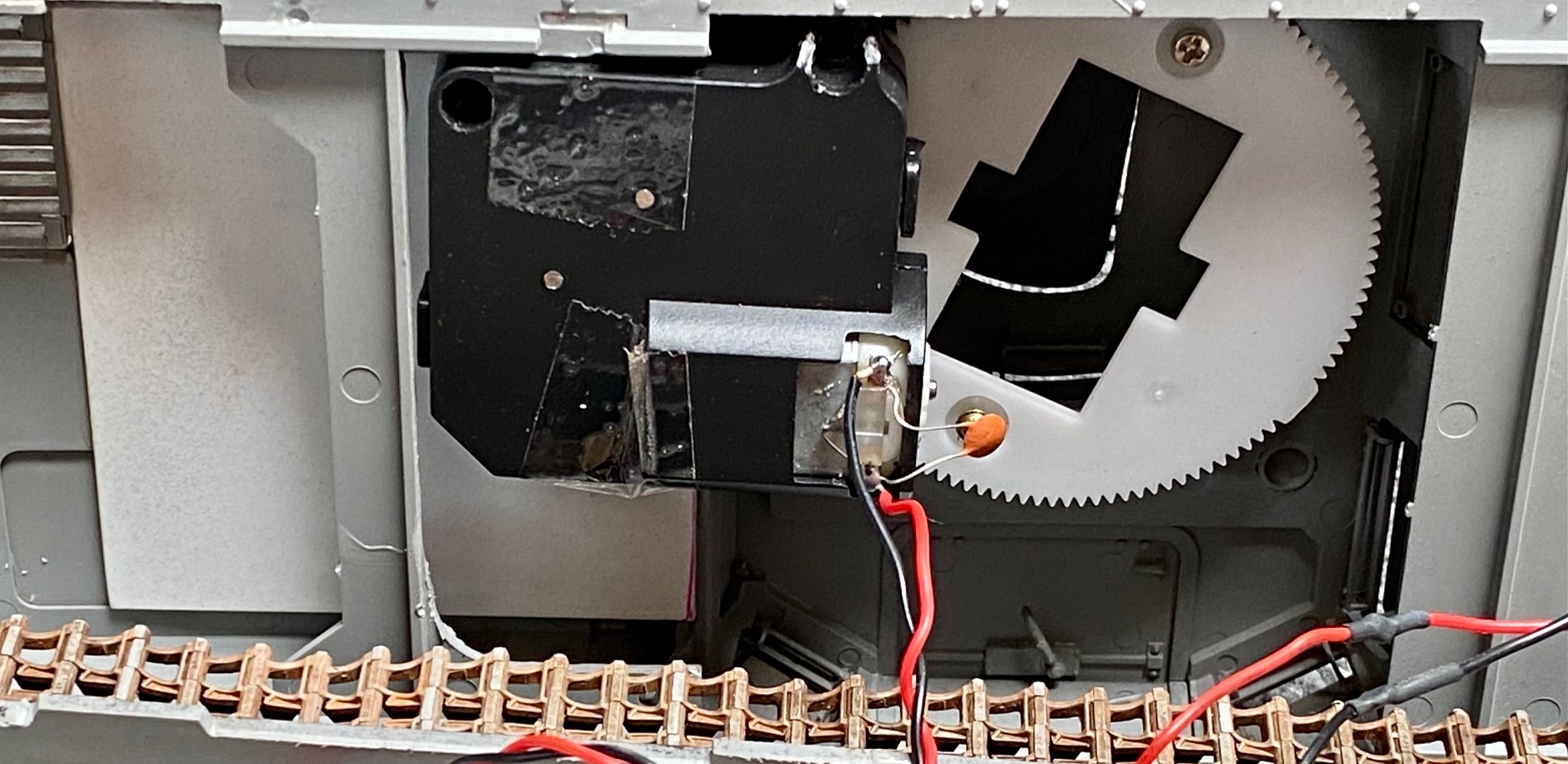

The last major segment of this build was the turret rotation. Up to now, I'd managed the project using hand and bench tools, and general hobby supplies. So now I had to adapt the Sherman turret rotation equipment to the P1B. Fortuitously, the Sherman ring gear was the right diameter to fit into the P1B turret ring.
However, to get the motor and ring gear to mesh, two things had to be done. The motor unit had to be made level with the ring gear. Because of the sloped rear deck, the motor had to be lowered to be made horizontal. Plastic sheeting was cut and formed to do this. This put the motor pinion gear too low to meet the ring gear. I have a friend who is very knowledgeable and equipped to design and fabricate a 3D printed part that allowed the ring gear to sit at the same level as the pinion. I don't know how this could have been done without that resource.
Here is the file photo of the part. Although the 3D "extender" part is hidden, here is the mount.

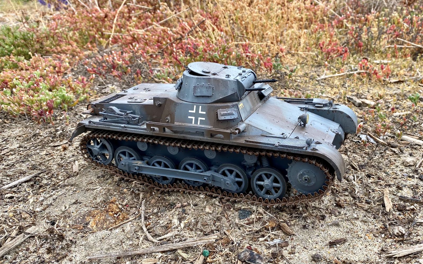

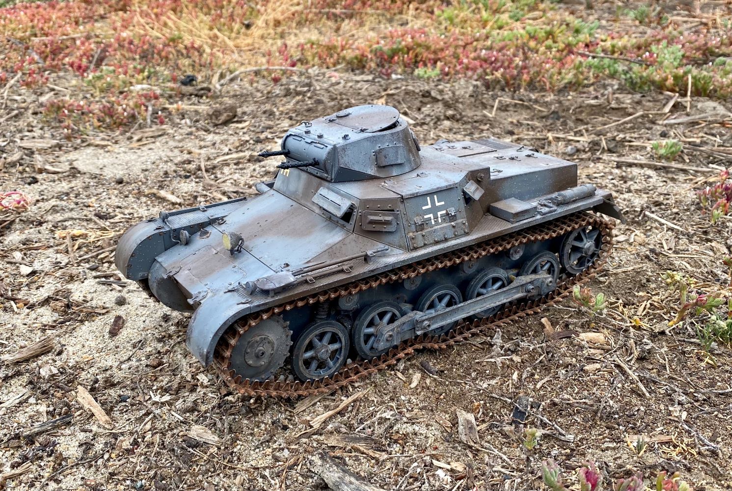

Quick and dirty thread, I know, but here is the final product:
And here is a short video clip of it running outside:
https://youtu.be/DSREPJ_uUjA
I know I've left out a lot of detail, but questions are welcome! As I'd posted earlier, this was to be a simple, low budget project. It runs, that's the point of it all!
