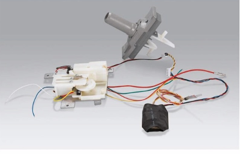

You can get a good look inside the Taigen Turret with the airsoft recoil feature here:
Layouts will also differ depending on which recoil unit is fitted. Taigen used the Asiatam style all-in-one unit: There was another unit shaped like the airsoft gun, that was designed to be a direct replacement..
Anyway, this will get you started, I hope.
