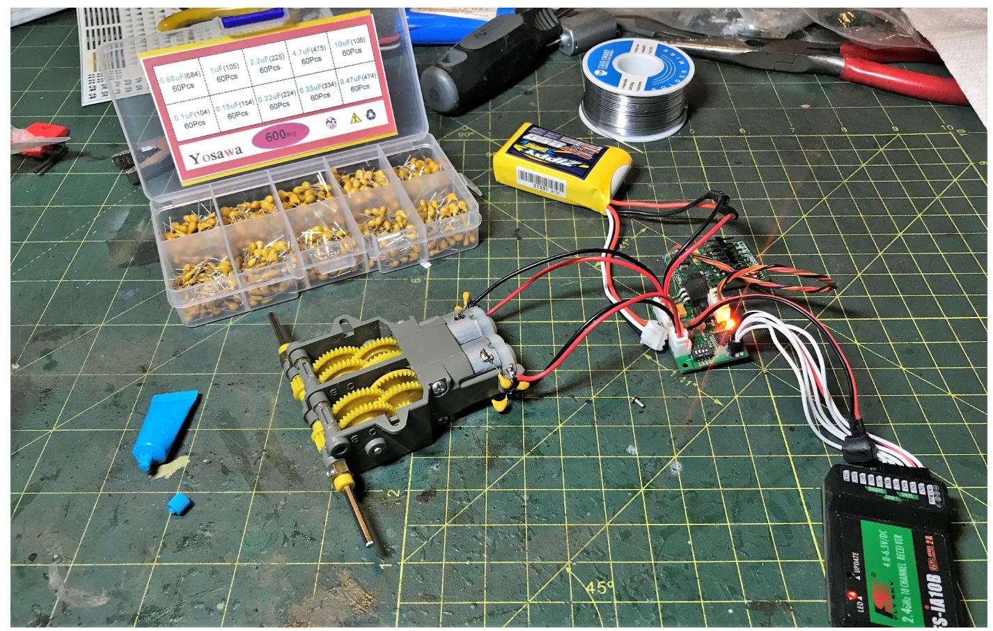

Motorization will be provided by an inexpensive DIY Tamiya twin gearbox with 130 motors, good enough for the size of this vehicle and a nice little kit to assemble. The MTC-2 control board and ACU units from 35RCTANK will be used with the Tamiya gearbox.
1/16 RC Wiesel 1A1 TOW - Armored Weapon Carrier - Build

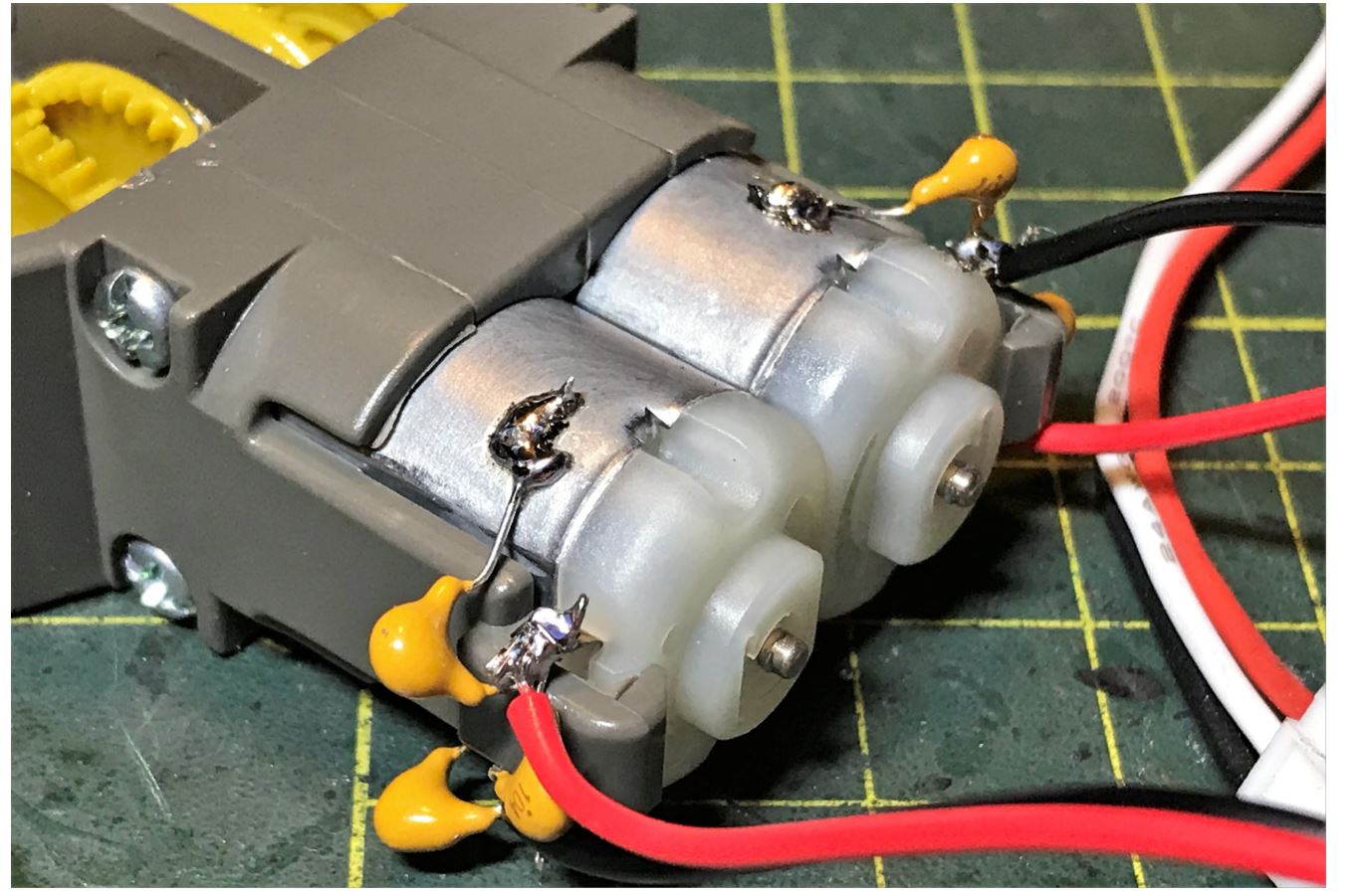

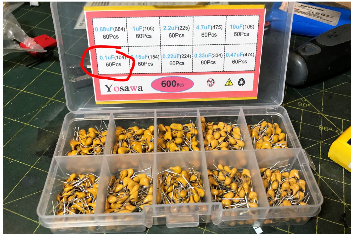

In order to work correctly, the motors need to be equipped with ceramic capacitors. Not knowing the right configuration to use, I purchased this set on Amazon for a few dollars. Without capacitors installed, the motors do not operate with speed control and would likely be damaged.
After evaluation of a few categories, i determined that the optimal setup is to equip each motor with three 0.1uF(104) capacitors.
One capacitor is installed between the + and - connectors, and then between each connector and the metal casing of the motors.
With this setup, the motors are extremely responsive to the speed control stick of the control unit, and the annoying noise is totally gone. Test everything...

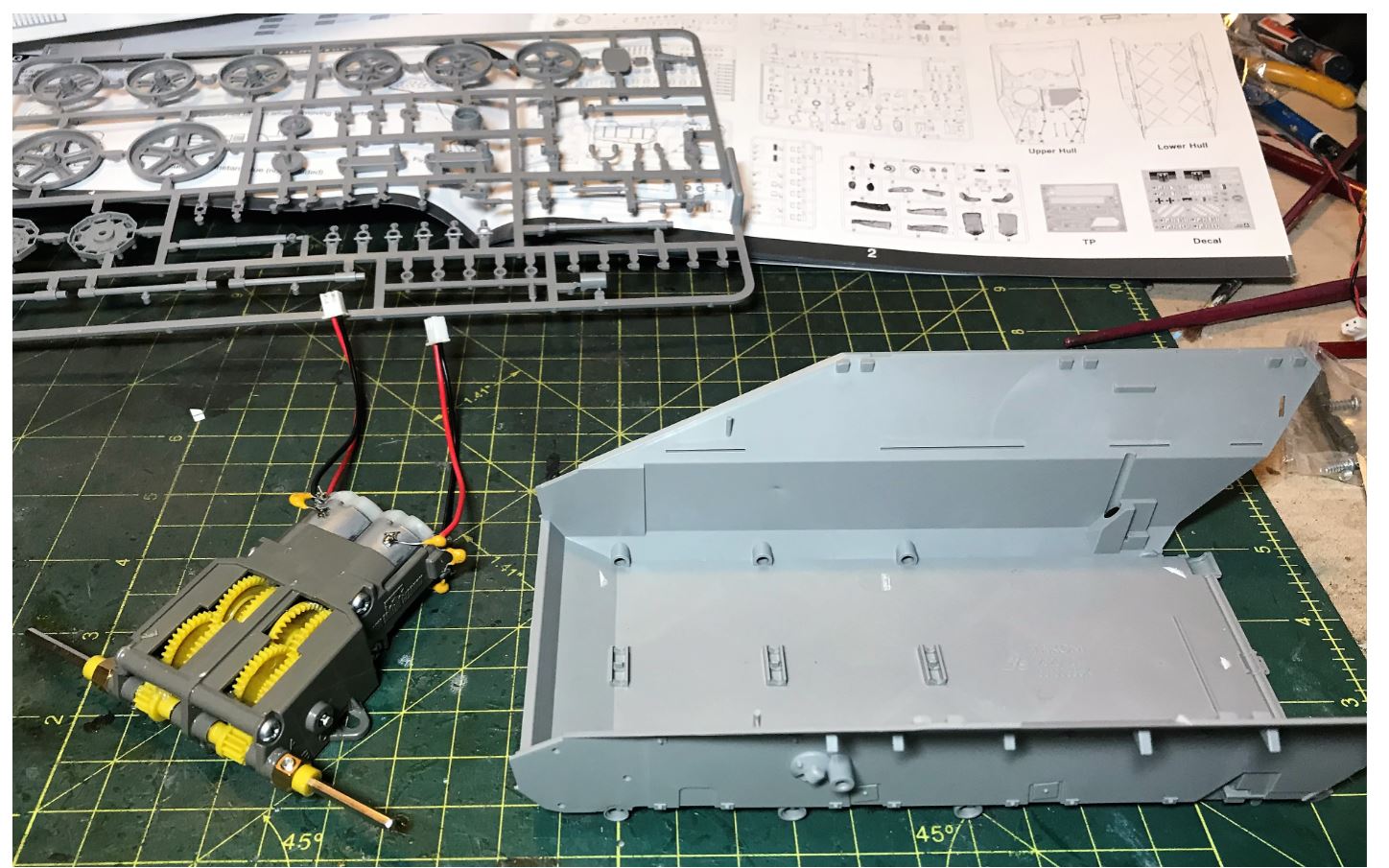

The Takom kit provides a good tub to install the gearbox. Looks like the Tamiya gearbox was designed for this chassis, perfect match. Not even a need to adjust the length of the shafts.

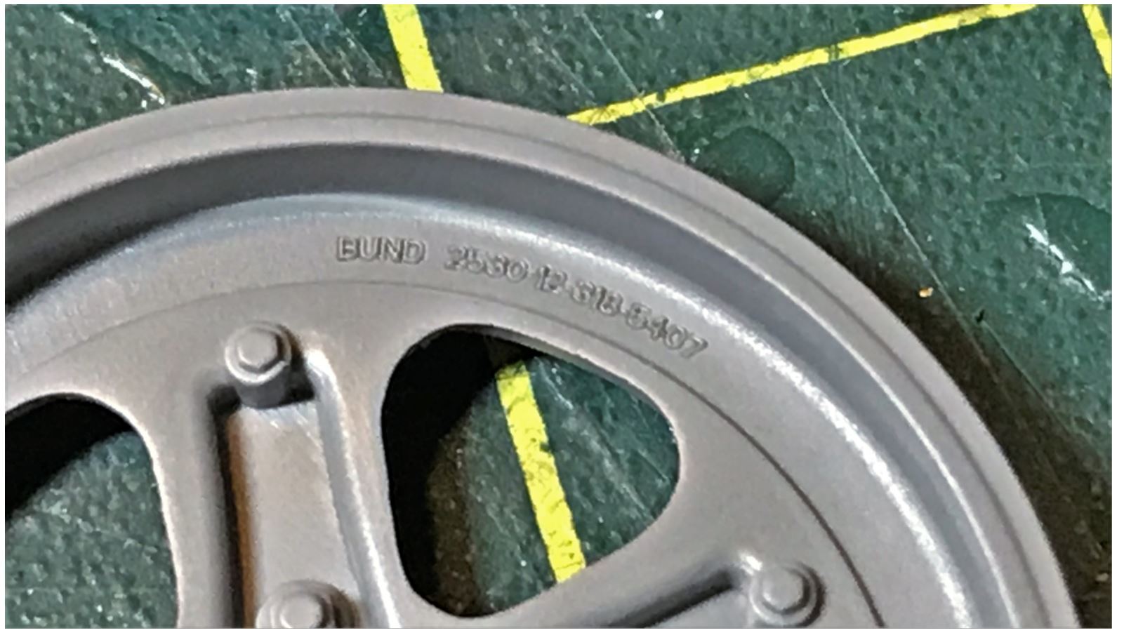

Check out the markings on these roadwheels, extremely small and refined. Needs maximum zoom to read it.

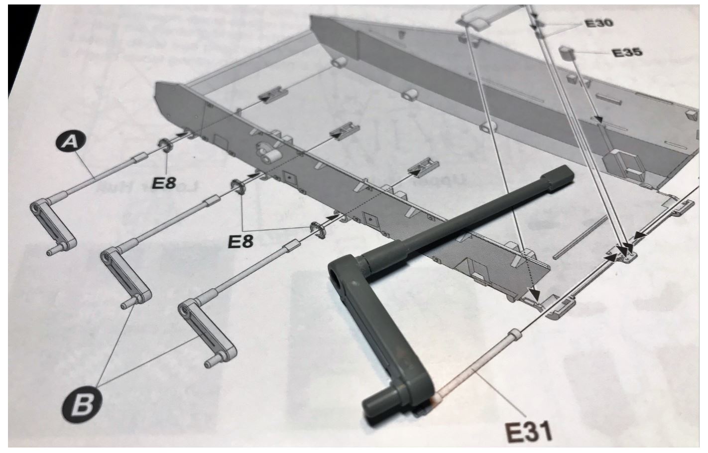

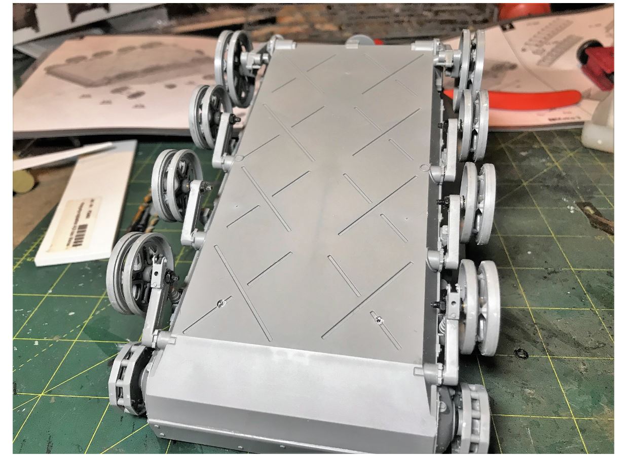

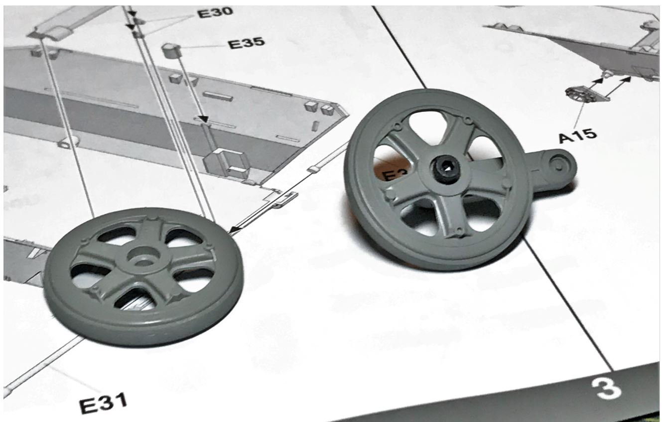

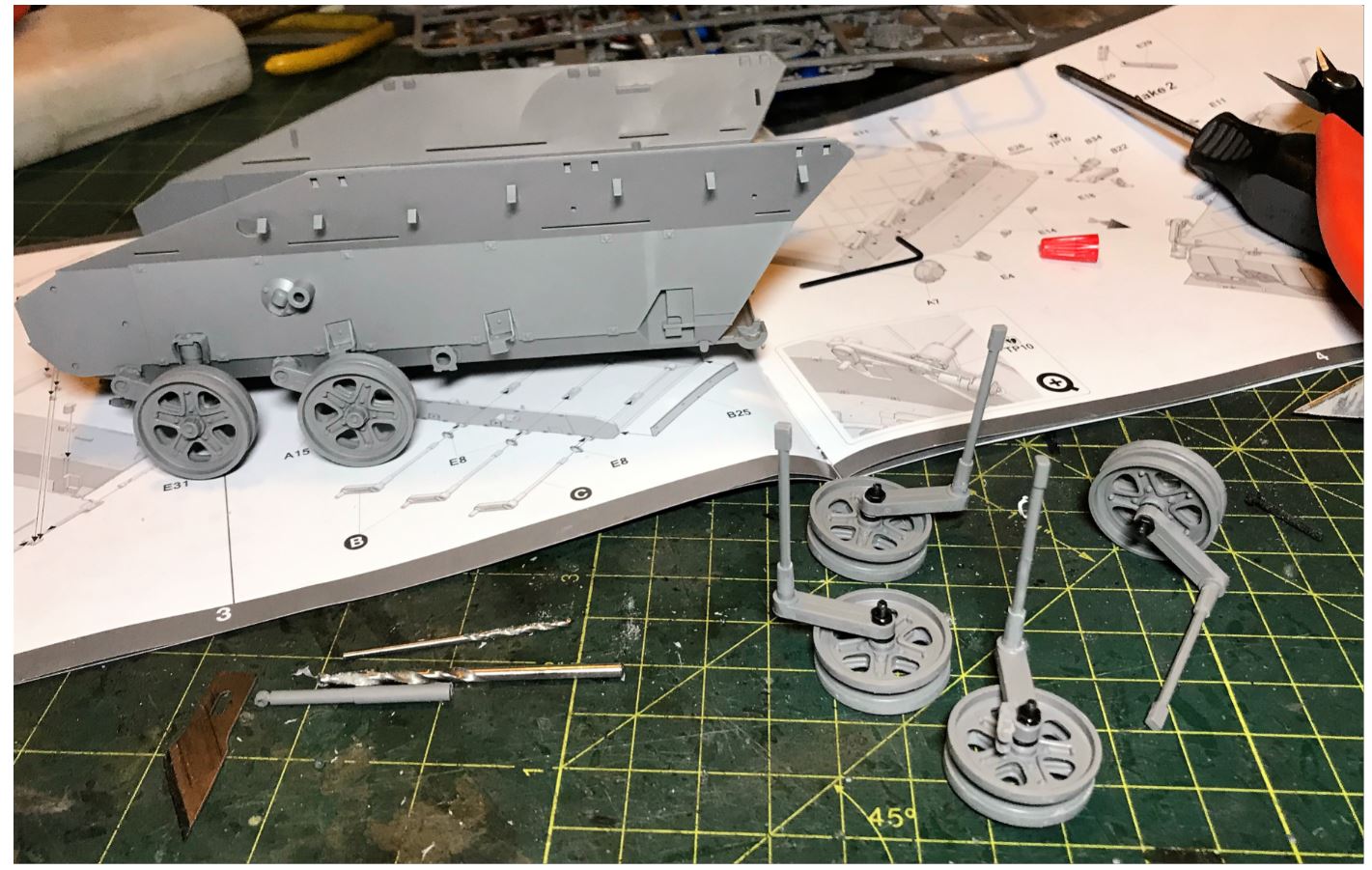

The kit provide plastic torsion bars for the suspension, a great bonus. As the model is very light, this will do.

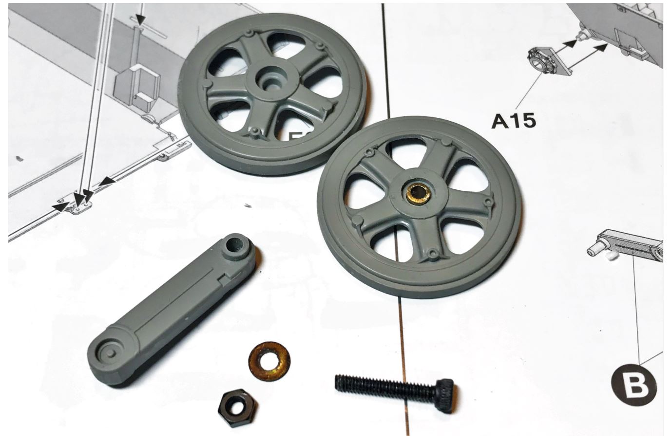

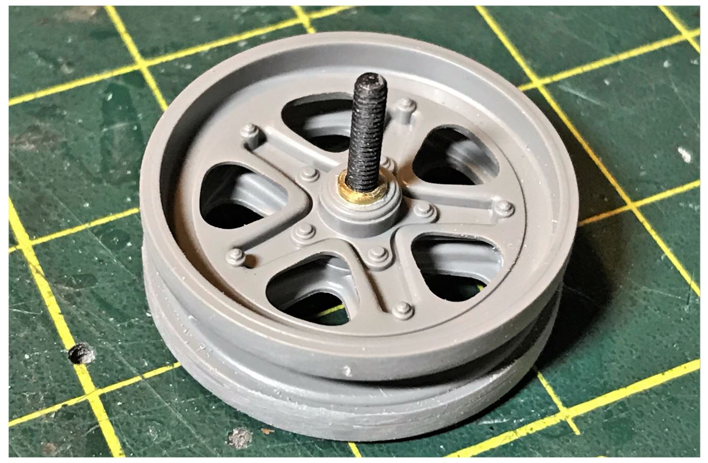

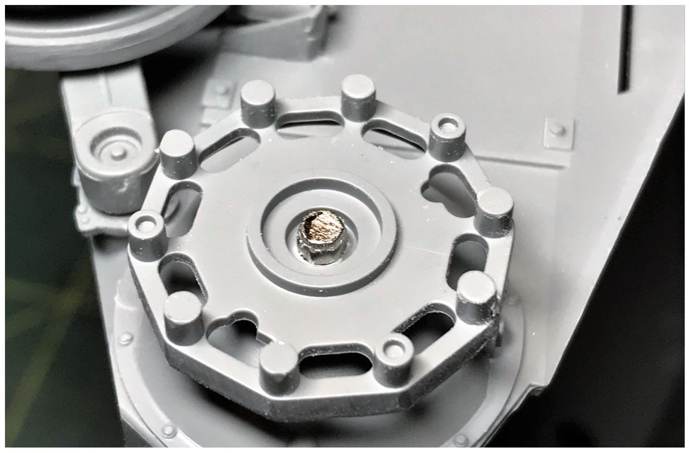

The plastic axles for the roadwheel are simply replaced by M2 hex bolts with a brass rim inserted into the inner roadwheel after drilling the required central hole.
The M2 bolts and nuts are adjusted so that the roadwheels turns freely on their new axle. The same is done for all roadwheels.

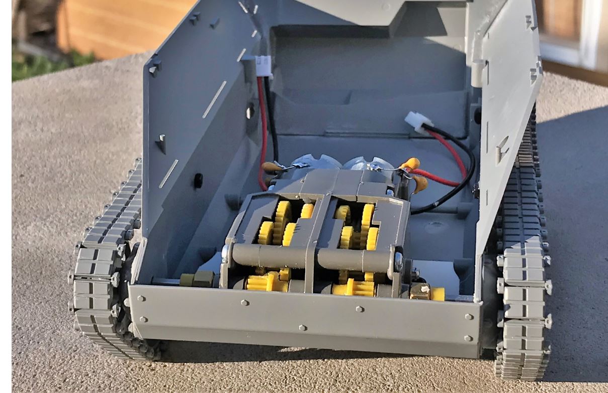

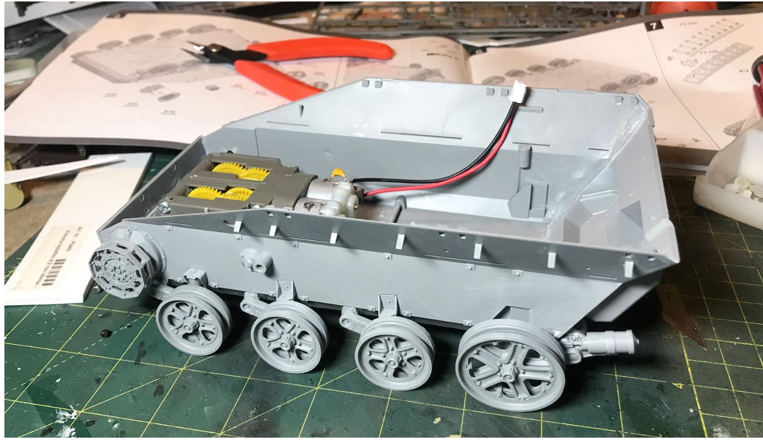

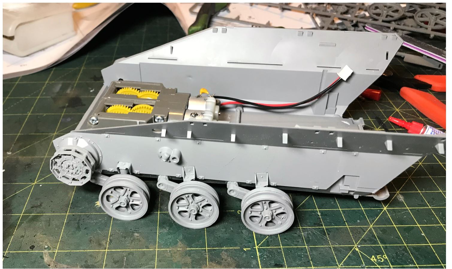

The gearbox is installed on a plasticard plate glued to the bottom of the hull between the two torsion bars, and the gearbox is held in place with two M3 hex bolts.
The sprocket shaft is coming out of the sprocket gear housing at the right length.

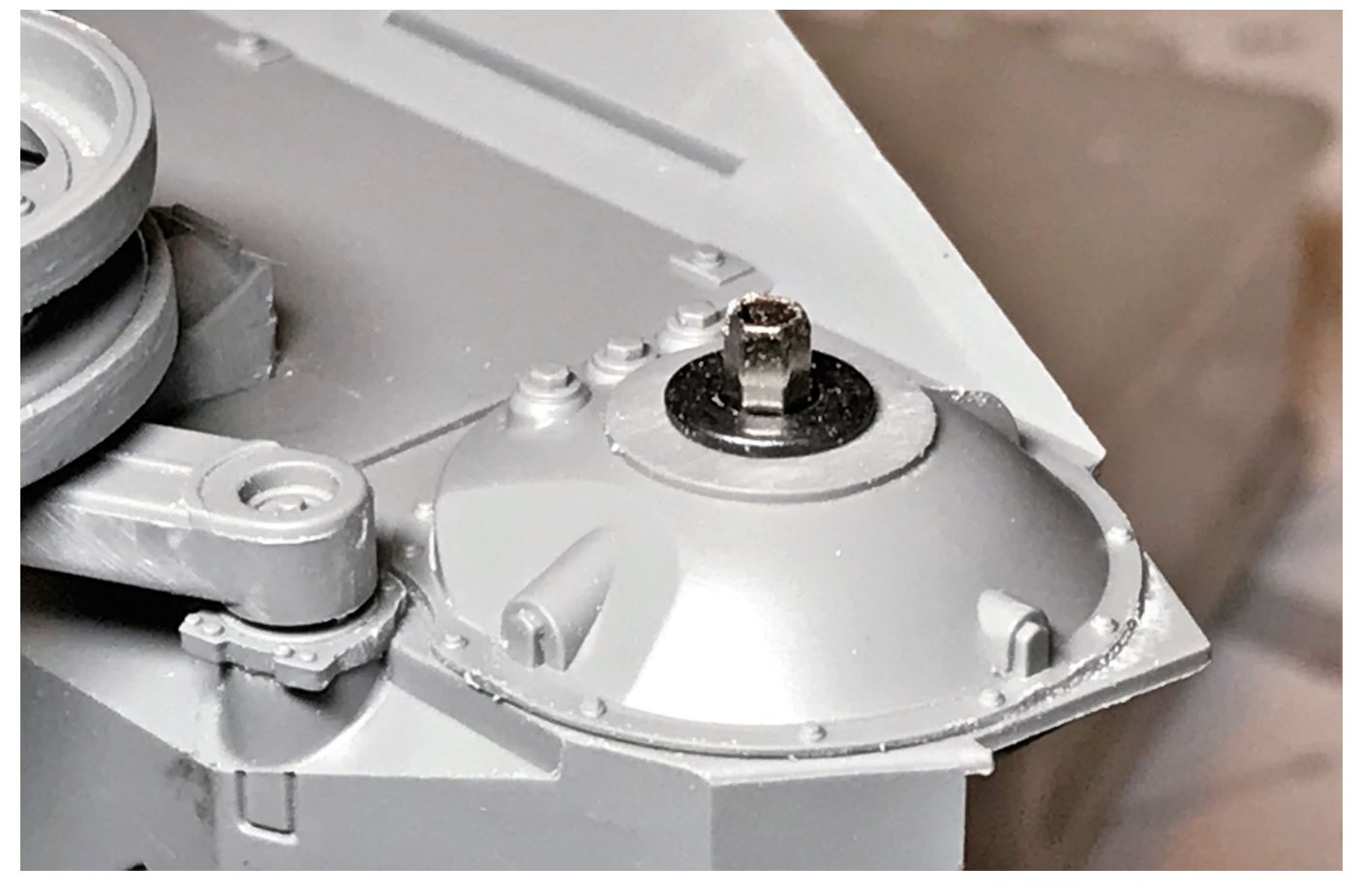

After drilling a smaller hole than the shaft on the sprocket, the sprocket is simply pressed against the shaft for a tight fit, and then glued. This is no King Tiger and resistance is very light. I saw no point in developing something more complicated.
The outer sprocket wheel is placed on top of the inner wheel. Here we go, Wiesel RC motorization for a few dollars...

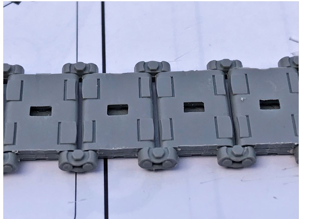

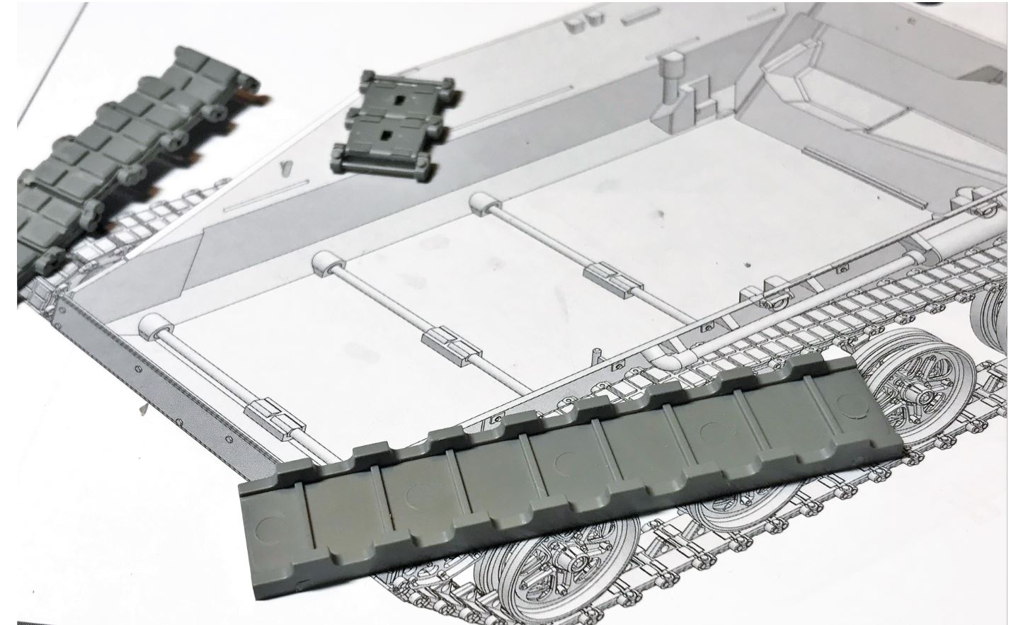

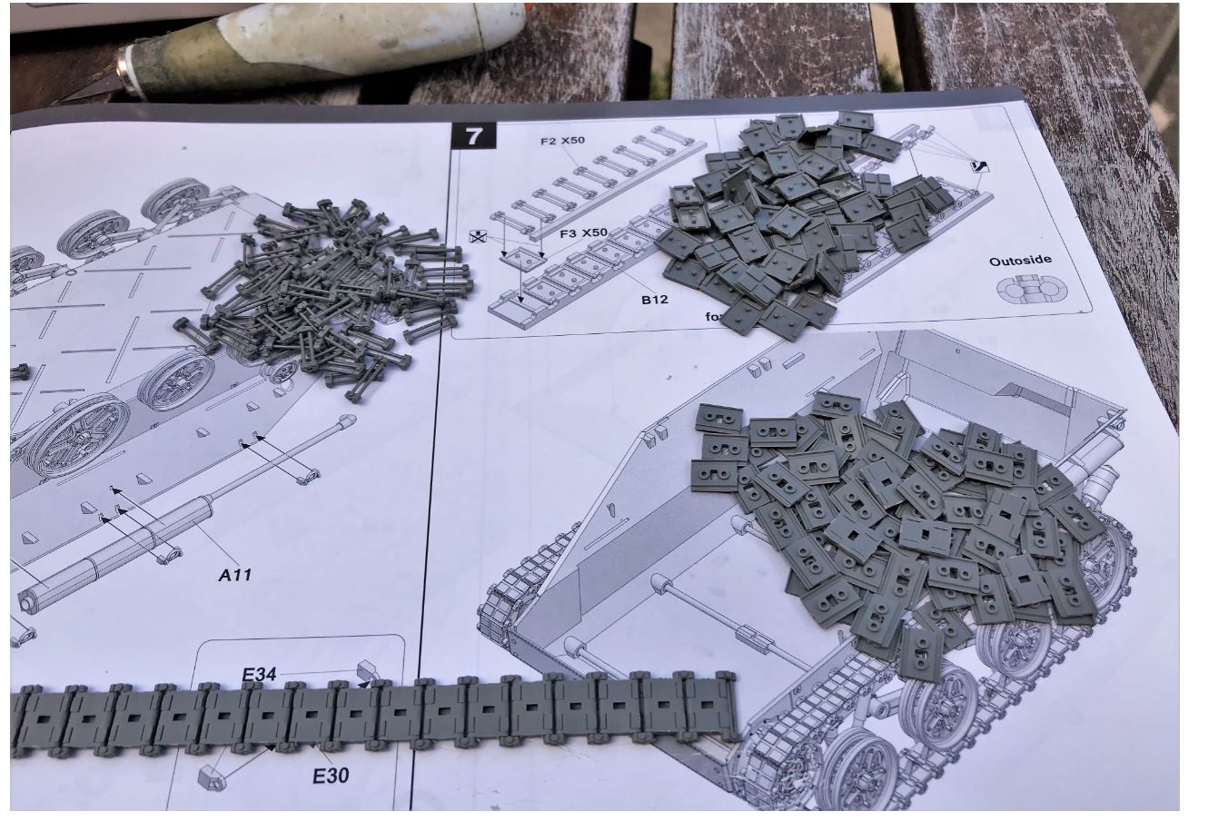

I was happy to see the tracks, similar in concept to the ones on the Stuart. The separate track links allow for RC use as is, 50 links on each tracks.
The jig for the assembly is discarded. As it is critical that each link is properly assembled, articulated and free of glue on the connectors, i recommend that each link be assembled individually. Only apply glue to the two central location pins of the shoes, and then press with plyers. When building the tracks, consistently go back to the previous 8 links to make sure that they are still loose and articulate freely. I had a couple of occasion where glue trickle to the connectors and locked them. Takom only provides about 8 spare links in total so there is not much room for building mistakes.
It takes about 3 hours to assemble the tracks.
The teeth for the tracks and sprocket is a separate part.
But the jig process to install them can be used here and saves a lot of time.

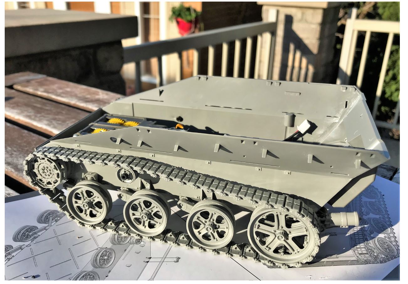

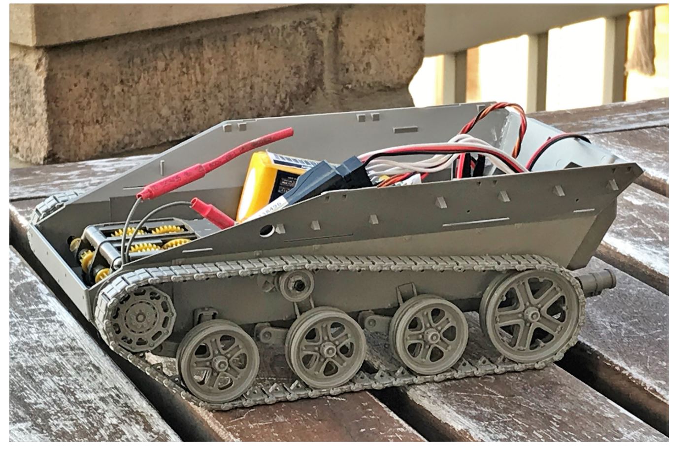

No need for track adjusters, the tracks are tight and at perfect length.
The model is ready for motorization testing, the electronics are simply thrown on board for the testing.
And here are two short videos of the initial testing of the motorization at low speed. Seems i have only two small problems to correct with one of the roadwheel which gets stuck sometimes and the return rollers need to be more sensitive, these tracks are so light...

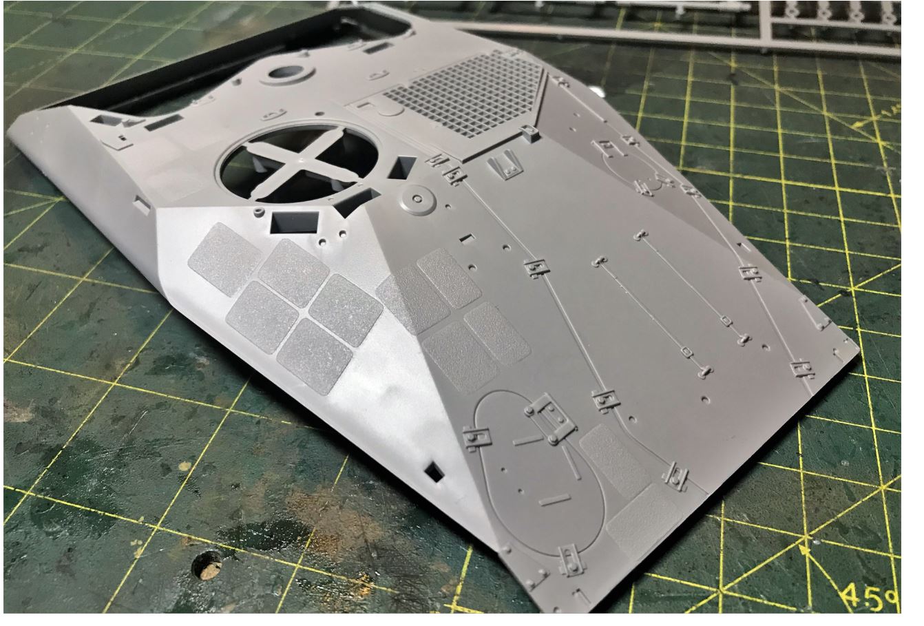

Hi, thank you everyone for your encouragements ! Yeah, it is an easy build. Other than the mods planned, the rest is as simple as following the instructions.

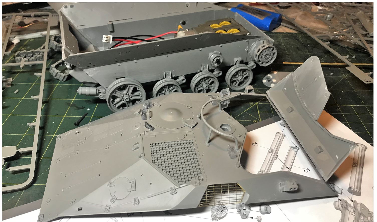

For its size, there is a lot of parts in this kit. What takes the most time is to cut the parts from the sprues and clean them. I recommend taking the opportunity to buy a new fine Xuron clipper for this build, it will be needed. As you can see below, even small parts have between 2 and 5 attachments to the sprues. It is sometimes difficult to determine what is part and what is sprue.

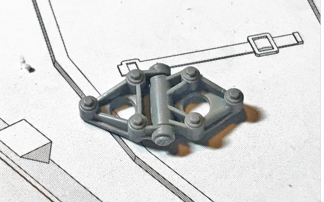

The level of details is amazing, such as this working hinge used on the back upper hull section.
This will provide easy access to the electronics, battery and main switch.

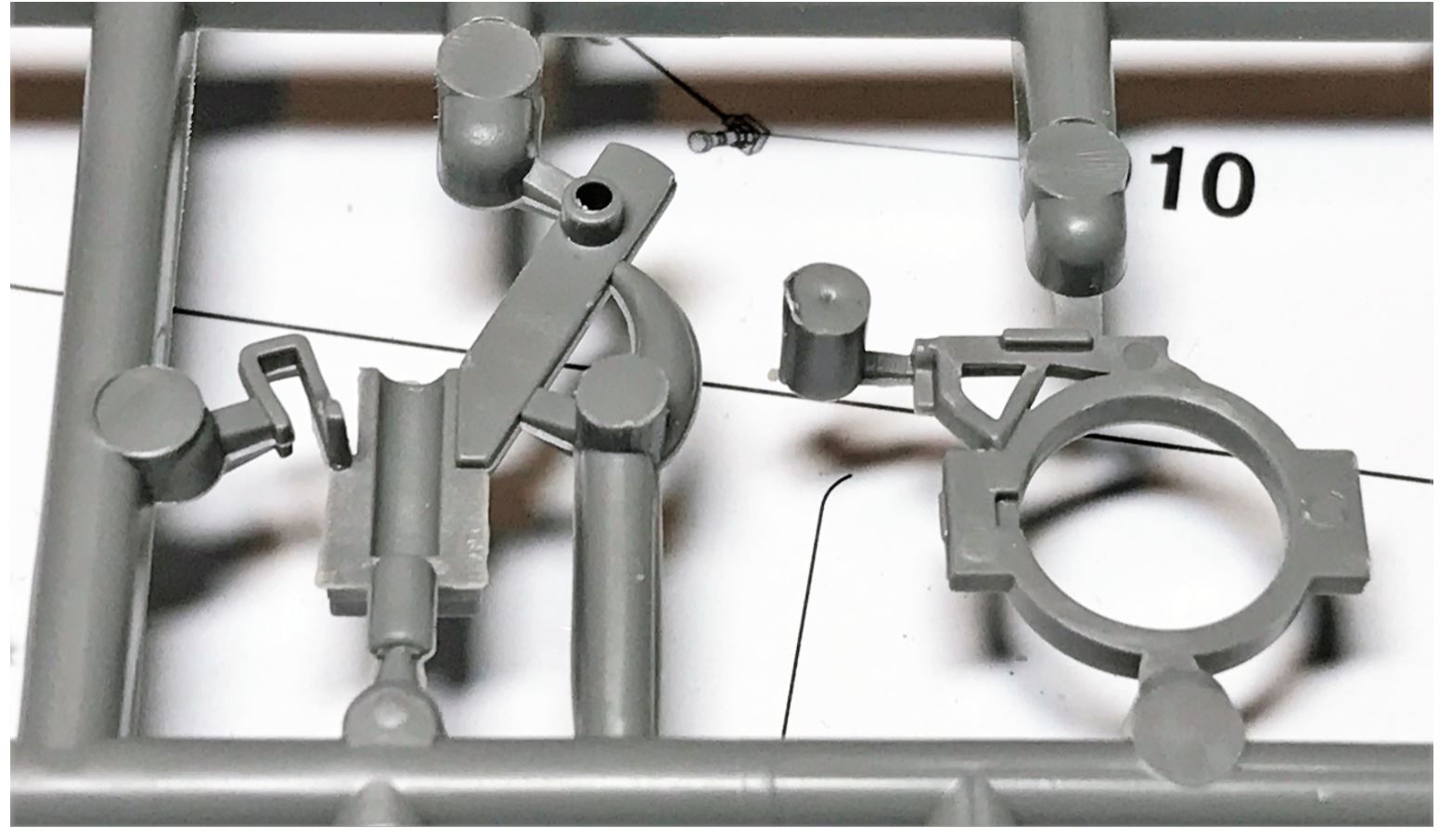

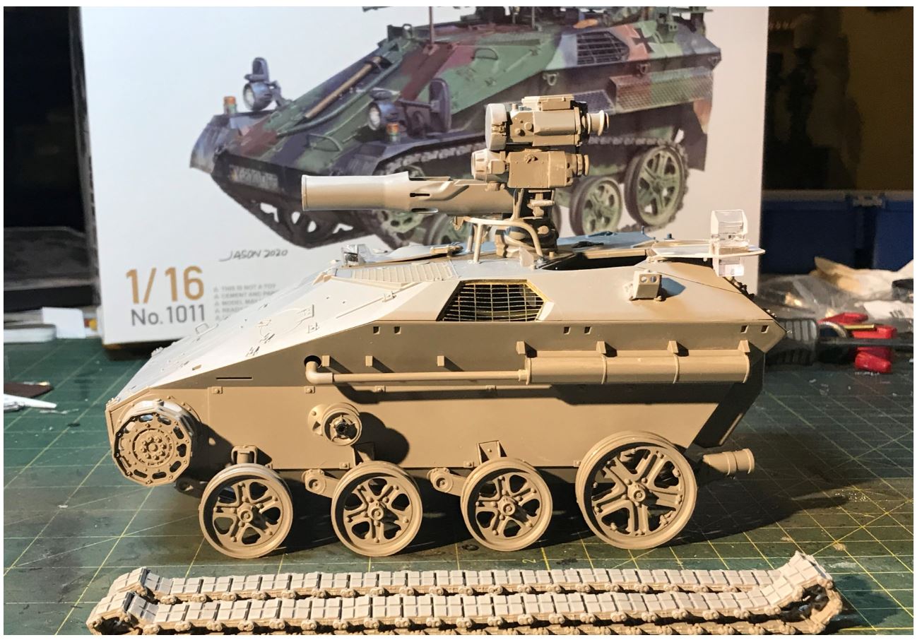

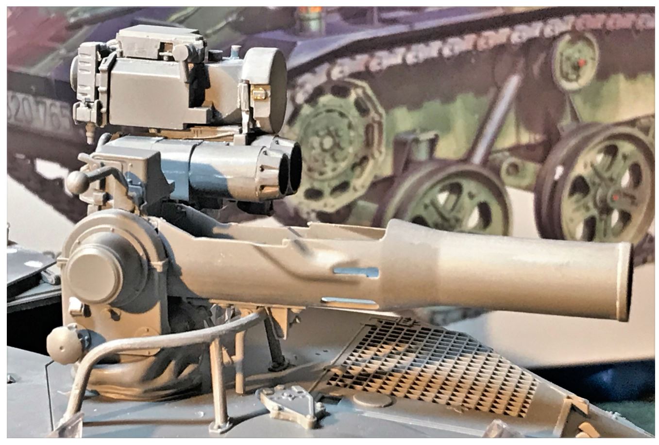

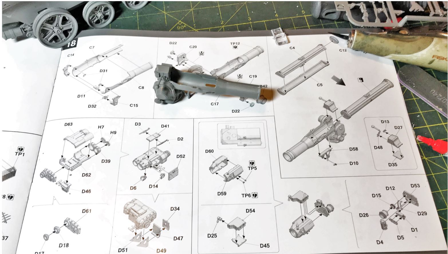

One of the highlight of this kit is the TOW anti-tank missile launcher (short barrel version) and sight with thermal imager. Some will purchase this kit only for this element. Hopefully, Takom will be smart enough to offer it separately on a tripod.
Its construction takes time and is tricky due to the number of parts involved. The sight and its mount alone has 39 parts !!! I think the designer went overboard and could have simplified the construction of the sight without reduction in the level of details. Building this sight will test your patience, the fit is good but not perfect, dry fit everything.
The two halves of the launcher and other parts could have a better fit and needed a lot of sanding to get rid of the seams. It created a lot of fine dust, the model will need a good wash.

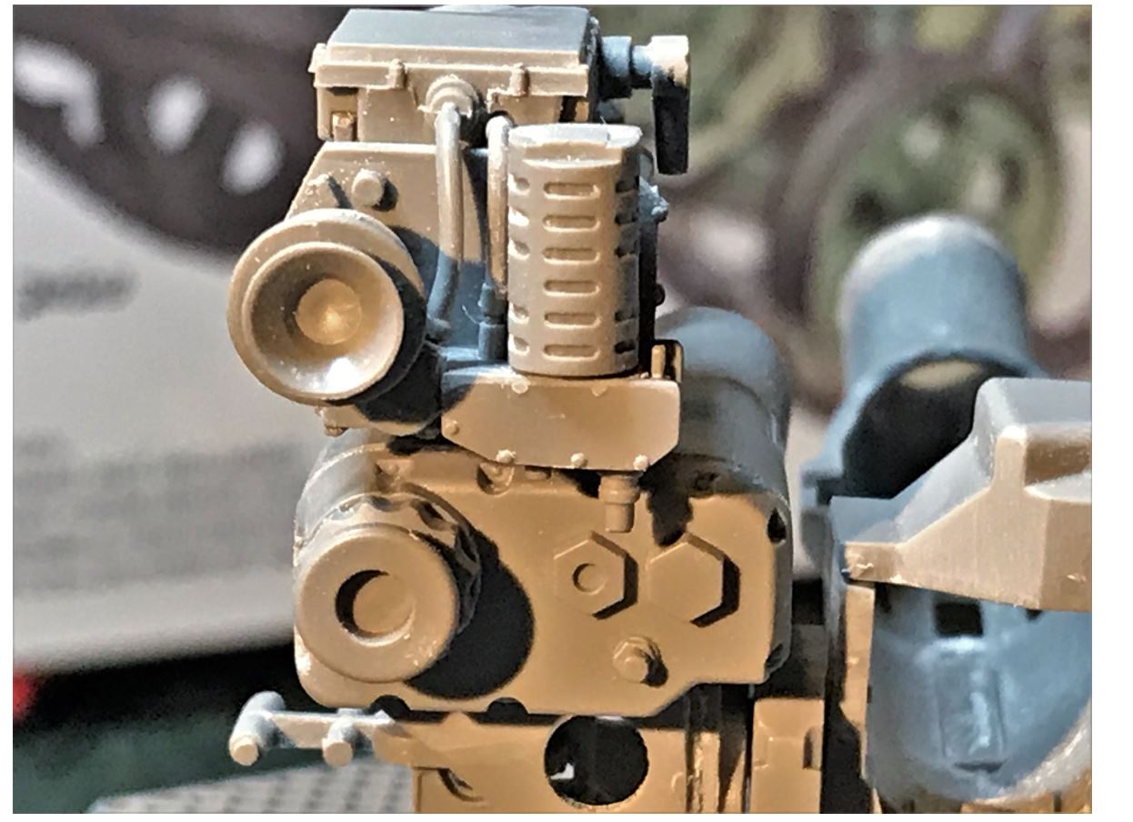

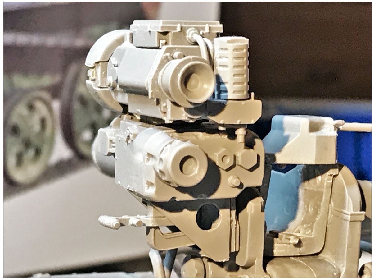

On top of the day sight is the AN/TAS-4A thermal imaging night sight. It is called a long-wavelength infrared sensing system. The night sight detects thermal energy and converts it into electrical signals that are converted into a visible light image, therefore allowing the TOW Weapon System to be used day or night in all weather and all terrain conditions.
The AN/TAS-4A night sight is a new element in 1/16 scale modelling world and is quite welcomed. Verlinden did not include it in its resin kit. In comparison to the resin Verlinden TOW launcher that i mounted on one of my M-113A1 and which had its long barrel version reduced to represent the short barrel version, same as on the Wiesel, the Takom launcher is about 2mm shorter.

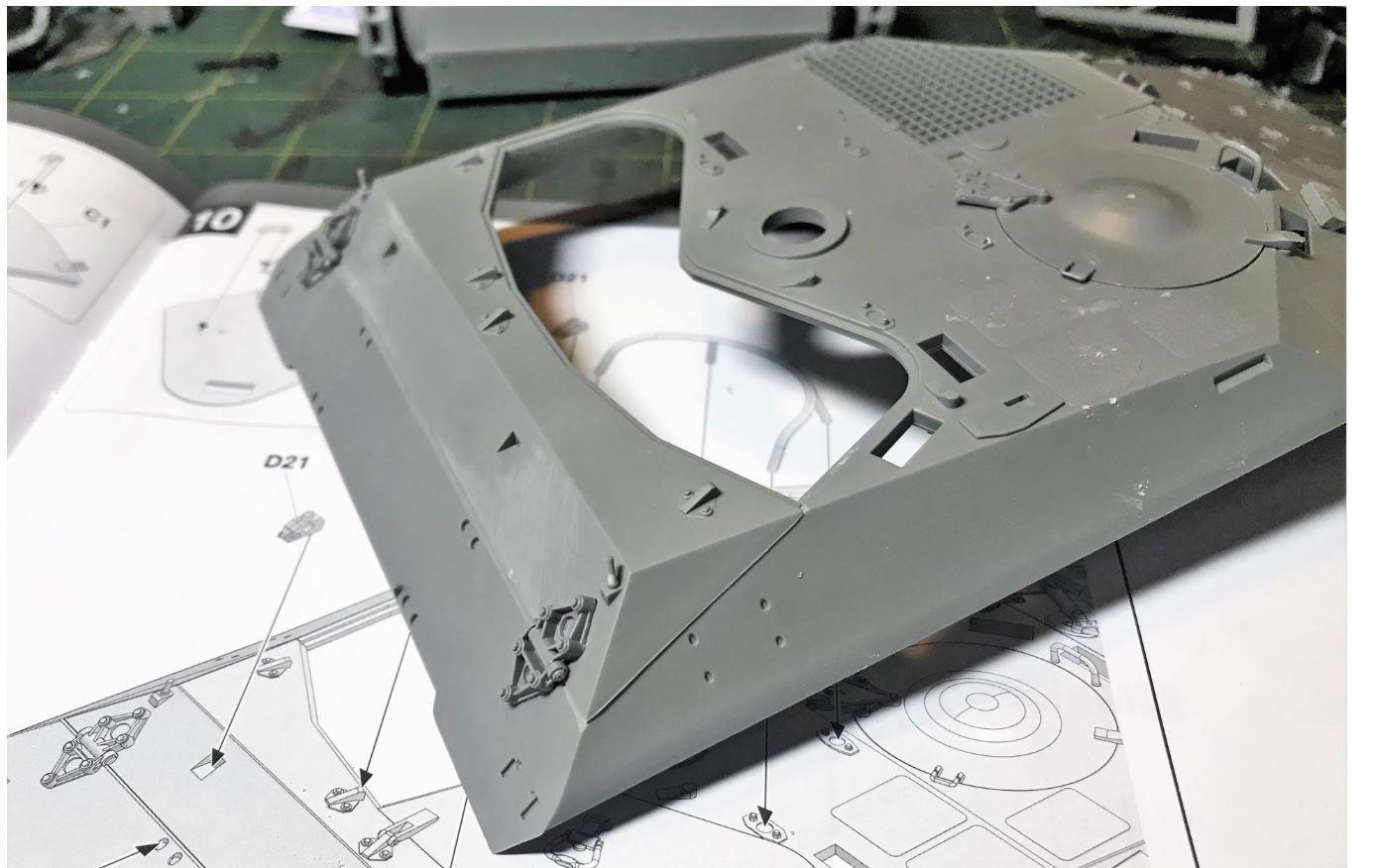

Dry fitting the main parts, the fit is pretty good and the model will look good.
