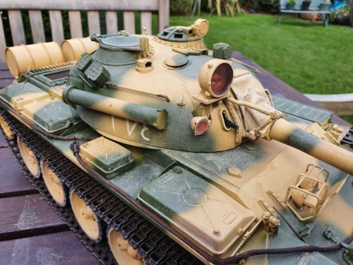

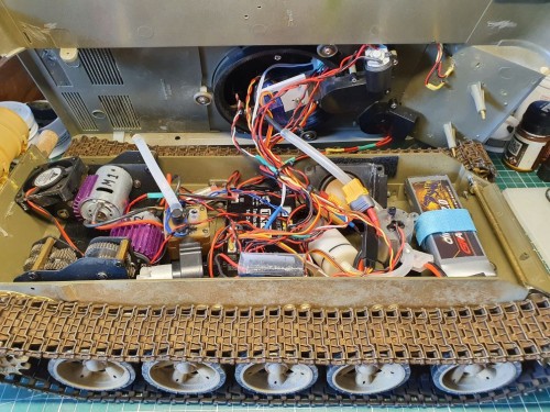

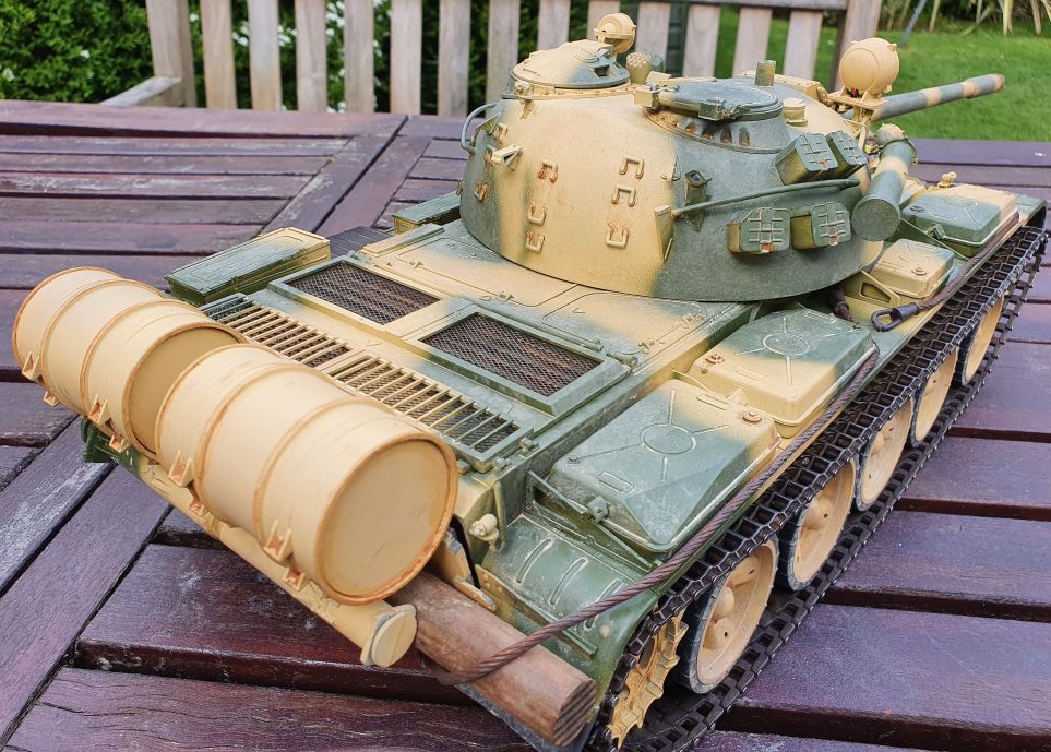

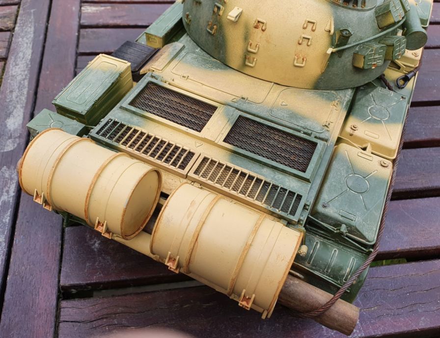

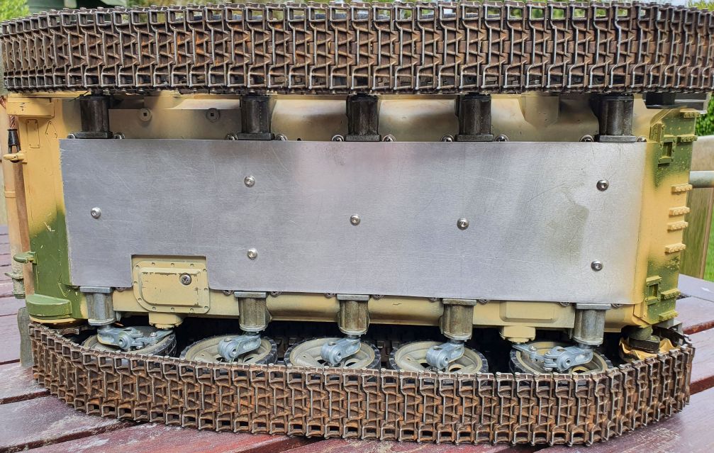

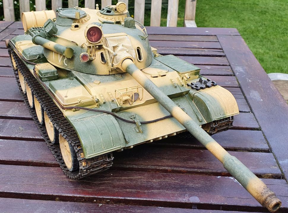

It is complicated, as many have commented on forums and elsewhere, requiring a good stock of tools and materials - plus a bit of experience. (I've been model building now for 60 years, I was horrified to realise recently!) It came with no electrics other than the motors, gearboxes, turret motors and servos, and I've used the HL 6.1S MFU, which was straightforward apart from the recoil servo which needed a reverser circuit. I have also fitted metal tracks, etched and treated with tracks wash, and added some PE brass mesh to the engine vents, plus assorted LEDs in rather random colours for lights. There's also an LED behind a co-axial MG, plus an IR emitter, both behind the turret slots, which were difficult to fit due to the main gun mounts, and a plug under a hatch for the HL IR receiver. I managed to squeeze in a smoke unit, and a barrel smoker and flash, plus a cooling fan, and there's only room for a foam-protected 2S LiPo rather than the NiMH I would normally use. I used Velcro so that I could adjust stuff, which has made for a rather untidy interior - but it all works. I had to cut down the HL speaker to fit, and there's also a Henntec track adjuster added. The upper hull is now secured with flat magnets on L-shaped brackets (not shown in the picture) using 1/8" (old stock!) brass rod glued in the front screw holes for location, and for hull stiffening I machined up an aluminium plate screwed under the hull to maximise interior space - it adds some protection to the underside also. I also replaced the steel cables provided (too stiff to work with, I found) with copper aftermarket cable. It's now my favourite tank, I think, and my HL/Taigen hybrid Tiger 1 and the others are a bit upset!
For painting, I camo sprayed MIG030 sand yellow, with MIG0915 dark green, and weathered down with AK sand yellow deposits, to give a generic Middle Eastern effect. For the purists - yes, I included the turret vent, which means it's probably really a T-54 - but I liked it...

1) You say that you installed "metal tracks, etched and treated with tracks wash." How did you "etch" the tracks? What track wash did you use? I am always interested in more techniques to convincingly weather metal tracks.
2) You also noted that "only room for a foam-protected 2S LiPo rather than the NiMH I would normally use." Indeed, I would rather use a NiMH, but sometimes space is a problem. What do you mean by "foam protected"? Is it just to pad the LiPo, or would this protect the tank in case the LiPo gets nasty?

Thank you for your kind words. Yes - the weathering companies must be making a fortune (mainly from me!) and I've always felt that some enthusiasts go a bit over the top. I've also used the lightest touch with the rust as befits a dry climate tank. I used Mig 2020 burnishing fluid, which make the track too black if it is left too long. so just a light soak in diluted fluid seems to work, and MiG tracks wash adds the slightly brown effect. I also use AK PE etching fluid for brass and copper - again, very diluted. The 'soft skin' LiPo is protected as there are lots of metal protrusions near it, so it's just padded in case of a puncture. I never leave them connected or in the tank for storage - I have a vented metal box for that.
