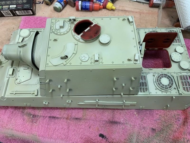

Good afternoon.
Somebody can explain me (if it is possible), to remove the barrel, from the mantlet on a jagdtiger. It was a bb shot, but I need to remove barrel to transform with recoil.
I seen a hole under mantlet, but no bolts in this hole...
Thanks. :wave:

Thanks Michel. But impossible to remove. I can turn it, but I think it is crimped in the mantlet... :think:

There's a metal clip which keeps it in place, the two parts of the mantlet are glued around it.
You have to either some how separate the parts of the mantlet or destroy the mantlet to get the barrel out.

I will try, but afraid to destroy mantlet. I searched for a gun especially for recoil, but no seller sale this part, if I break mine...

Thank you very much for your attention Herman. I really appreciate. But for moment it will be not necessary, because the gun is removed from mantlet.
Tomorrow, I will put picture to explain.
Thanks guys for help. Tom was right, it is a metal clip!!! :thumbup:
