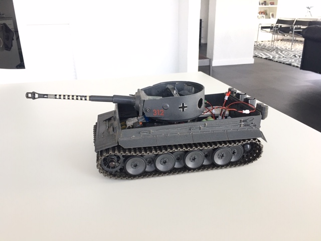

I got this Tank in 1977 as a gift from my Dad during a time after an accident when I was laid up for a good while. This 1969 Vintage Tiger with dual motor wired remote control started my journey into the model Tank world. This Tiger 1 has went through several upgrades over the years starting with a radio control upgrade in the 80's. The original all metal drive line that had dual drive shafts and was very elaborate and worked with a full interior finally wore completely out and of course there are no spare parts available separately. I tinkered around with a hand built unit using some of the original parts but it never worked very long and was breaking down most every time I tried to operate the Tank.
So around 2000, I parted out a Tamiya 1/35 scale motorized remote control Sherman and used the gearbox from that model to retrofit this Tiger 1 and that worked very good but before long that gearbox got very loose and was on the verge of breakdown and needed replacement. These Tamiya 1/35 scale metal gearboxes are rare and expensive so I decided to find something else to work in this Tank. The 1/25 Tiger has wide tracks and puts a serious load on the transmission so It has to be something durable ;)
OK when I get some more time I will continue this post but for now off to work. Here are a few pictures of the newest configuration into a IR battle Tank.

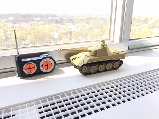

Latest 1/35 Panther build. I will do a post on this Nicimo dual motorized Tank here soon.

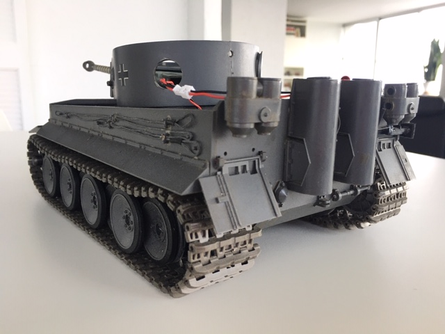

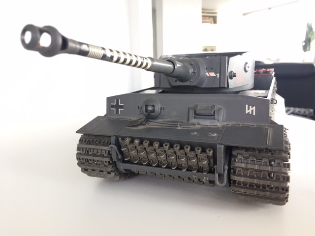

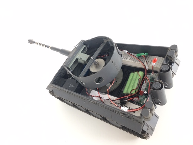

Well the Heng long radio upgrade was a total success in the !/25 scale Tamiya Tiger 1. This tank can now IR battle any 2.4G HL tank. I already had a IR battle with a HL 1/30 M4 Sherman. The HL radio gear used is very easy to work with. Only downside is the "Mode 1 throttle" which I have remedied with a TX Mode 2 conversion.
Update cinco de mayo
This 1/25 Tiger is now perfected with the HD Tamiya Bulldozer gearbox and Heng Long circuit board.
Features:
Main gun up\down with digital proportional speed control.
Main gun left\right with digital proportional speed control.
1 stick forward\reverse with digital proportional speed control.
1 stick neutral turn with digital proportional speed control.
Heng long IR battle system with tank recoil\hit shudder and 4 LED hit indicators.
volume control is via a button on the TX that allows 4 volume levels including a mute funtion.
Tank can be put into standby via Tx control.
Has L\R track tuning function so that tank tracks strait.
Machine gun and main gun firing.
Main gun 1 button firing is limited to 10 shots but can be overridden by 2 button firing.
