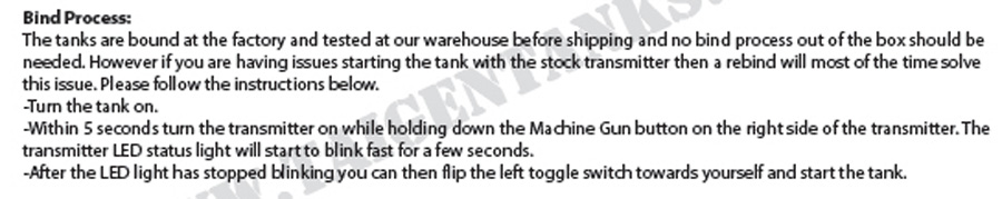

Welcome, Retired Tanker! There is not much I could help you with regarding electronics, for you are ahead of me. However, I see no reason for the dedicated (stock) Torro/Taigen transmitter not to bind with either Taigen V3 board. I have over a dozen of these boards, some from Torro directly, and not a one has given me trouble. I do know that at least a few years ago when the Taigen V3 came out, the binding instructions were incorrect. Here is the process I use:
Taigen V3 Binding.jpg (77.29 KiB) Viewed 2015 times

Herr Dr. Professor wrote:Welcome, Retired Tanker! There is not much I could help you with regarding electronics, for you are ahead of me. However, I see no reason for the dedicated (stock) Torro/Taigen transmitter not to bind with either Taigen V3 board. I have over a dozen of these boards, some from Torro directly, and not a one has given me trouble. I do know that at least a few years ago when the Taigen V3 came out, the binding instructions were incorrect. Here is the process I use:
Hi Professor,
I got your point. Until I decide for a respectively functional and reasonably priced MFU, I will make another attempt to use the V3. But as you know, first impressions last and I do not feel good about the V3 board. However, the same goes for all MFU s, there are people which like and dislike all different MFU types. Perhaps only exclusion is EIMOD.
