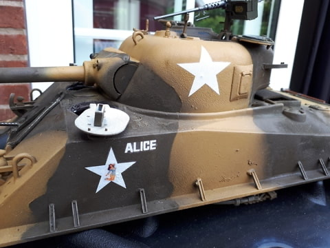

Thanks. It's really informative. I am actually looking for a specific type. Army green and sand colored camouflage that tank destroyer units used at Anizo.
Jofaur86
Posts: 2212
Location: Centre France
Re: camouflage
Post by Jofaur86 »
something like that
Link,forum BTN
https://www.battletanksnederland.nl/php ... f=9&t=8663
