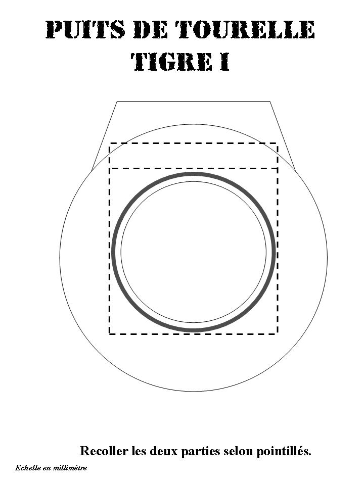

for info, how to refocus the turret on a Tiger I, a bit of surgery to do.

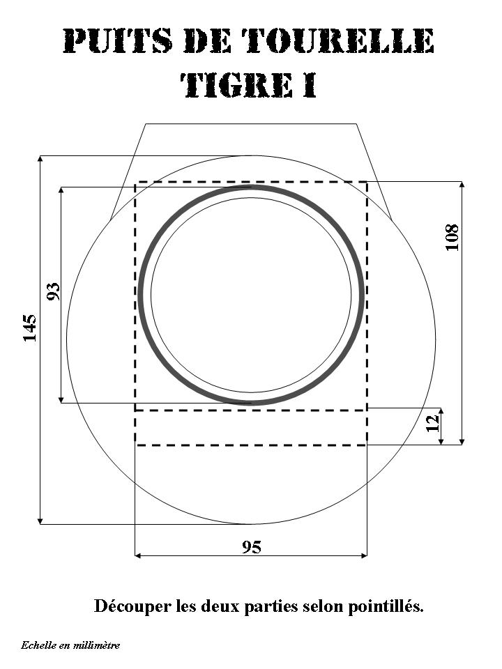

I hope this is not taken as a complaint BUT if the drawings were to the correct dimensions of the 1/16 Tiger 1 plan view of that Tanks body it would be a simple task to print off a template that could be used to carry out the fix.

jarndice wrote:I hope this is not taken as a complaint BUT if the drawings were to the correct dimensions of the 1/16 Tiger 1 plan view of that Tanks body it would be a simple task to print off a template that could be used to carry out the fix.
Désolée 8O

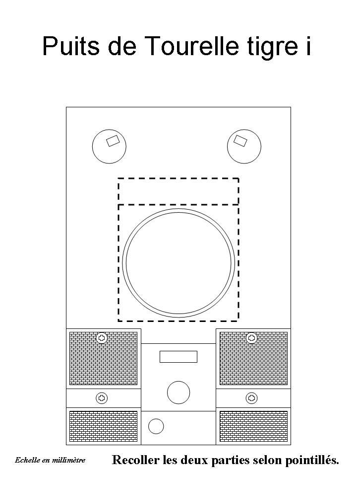

not drawing to scale, but I think sufficiently explicit with the dimensions, to make the midification without worries, it is simply necessary to cut a strip of 12 mm on the front of the upper frame and transfer it behind, to do the same on the base of the turret

:'( apologies, I was wrong, on the upper frame, you have to cut behind and put in front
