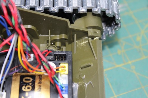

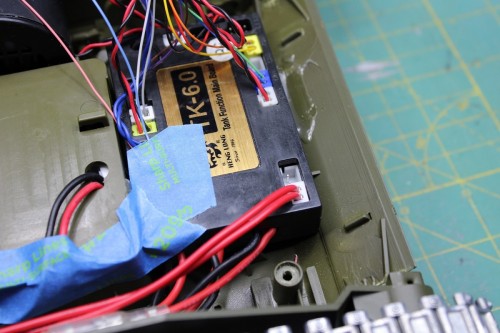

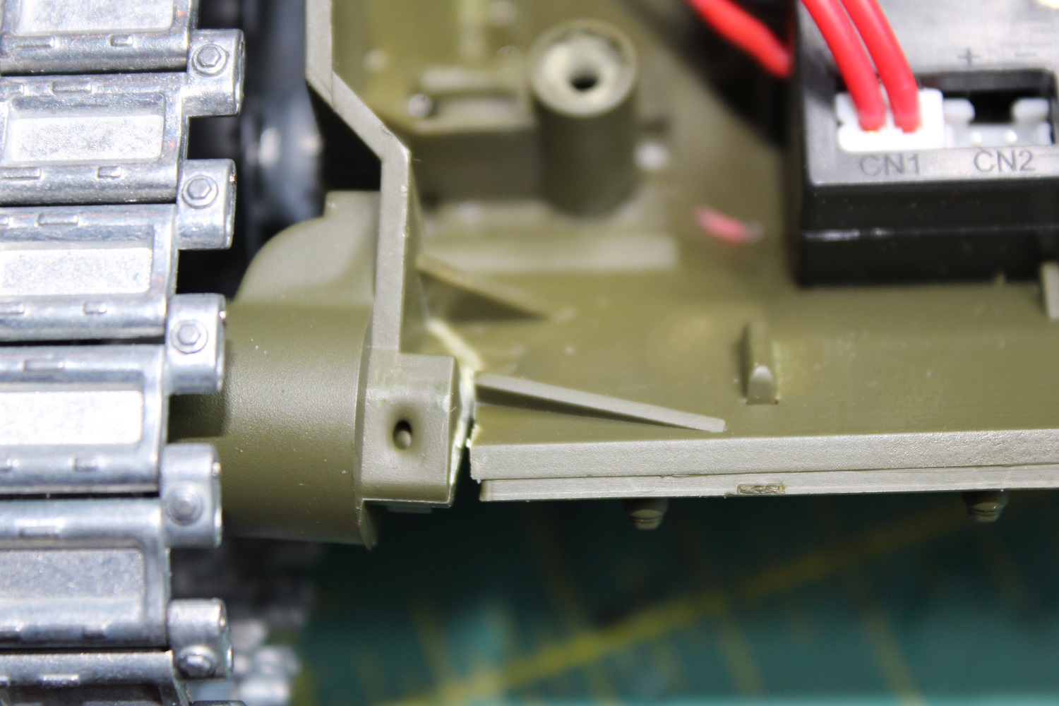

I found many problems. Both of the wires connect to CN 10 ( BB) were off the plastic insert that goes into CN10. I used tooth pick and reinsert them back in the socket. Quite difficult but I got the BB /cannon sound to work. Will ask Toucan to send me a new connector. There are two cracks in front of the tank and looks like someone drops the tank because one of the screw lugs broke away from the mount at the same area. I repaired by using CA and epoxy but now the idlers are at an off angle. Out of Heng Long tanks, one has motor issue that needs replacement (Panther G), one has defective rear light that needs replacement (T99A), and this with cracked hull. Will the cracked hull although repaired with epoxy pose a future problem? Should I ask TH for a new tank? Thanks Dai

Considering all the stress that is placed on the Idlers I do not think you can repair the cracked hull where it will last. In my opinion it is poorly designed though I am not sure it could be better designed given the shape of the T-72's hull at that point.
I am afraid you are going to need a new lower hull.
Barry
Barry

A good way to repair is to apply fiberglass cloth over the area with epoxy. The problem is that idlers are at about 5-10 degrees off center no matter how hard I proximate the parts together. Dai43rdRecceReg wrote:I agree with Barry. There's no way you should be trouble (and it is all a bother) by the consequences of somebody else's carelessness. If you can get a decent, functional replacement, you have a right to one. The problem then might be, that they won't agree to replace a model you've opened up and worked on.![]()
Nonetheless, you should demand a replacement.
You could bond in strips of (modelling grade) alloy plate or styrene to reinforce the hull but, and here's the kicker; you shouldn't have to![]()
Hope this hasn't put you off the hobby. We've all had disappointments at some time or other, I think.Perhaps more than at any other time, in recent years, we would like a few things to go right for a change.
Best of luck, and hope it all works out for you.

Consider the cracks and the mounting lug broke off in the same area I suspect the tank was dropped nose first. I hope Toucan will send me a new hull in case the repair does not do its job. Will let you all know what T says. Dai
