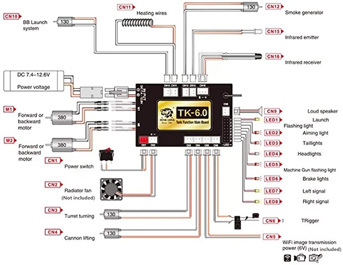

Hello. Does anybody know where plug 5 ( power input socket) on the HL cannon smoke function board should plug into the HL v6.0 motherboard. I have tried various spare outputs, they either make the heating chamber very hot or create smoke all the time. Anybody wired up the HL cannon smoker successfully?

whether what kind of platinum? it seems that the miter and the resistor of the smoker, have their own dedicated plug? may be necessary to modify wiring? To existe ?

I have a feeling that the barrel smoke feature is only on the V6.1s board, or the Haya 6.4 board. The TK 6.0 only supports the standard smoker; but that will need some confirmation... :problem:
Stanley, above seems to have all the answers. However, as I understand it, the HL recoil unit designed to be used with this barrel smoker won't work with the V6.0 unit because it needs a servo slot, which the TK6.1 has, but which is absent on the 6.0 board. :problem:

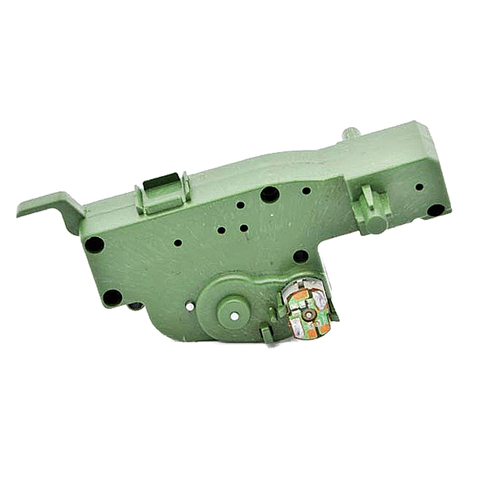

Here's the recoil unit designed for the barrel smoker, although with some adaptation it might be used with non HL recoils..

Indeed, but this arrangement requires quite a bit of work to modify the airsoft gun, to remove the airsoft function. However, there's no recoil function to replace airsoft, as is often the case. The HL unit (above) is designed to provide smoke, gunflash and recoil. This is the arrangement seen on the Haya Chieftain with barrel smoke.
The best example of the the smoking, flashing and recoiling barrel is here:
The unit shown is designed to allow the three features. The emasculated Airsoft unit only offer smoke and flash.

Hi Tank Legion has managed to make the smoking gun work with most boards, he has found a way of using a LED flash as a trigger.They do work with V6,1 which is probably the best for it as you can switch it on and off as with the main smoker.The trick seems to be the small circuit broad which sorts out when the pump switches on and fire the smoke.

I have a Heng Long Abrams and a Heng Long Tiger 1 both Version 6.0,
Having watched the U-Tube butchery needed to convert the main Gun to accept both Gun Flash and Smoke using a Version 6.0 board it beggers the question how easy/difficult is it to change to a Version 6.1 board and could I then have recoil and smoke and muzzle flash? and all without eviserating the BB unit.
