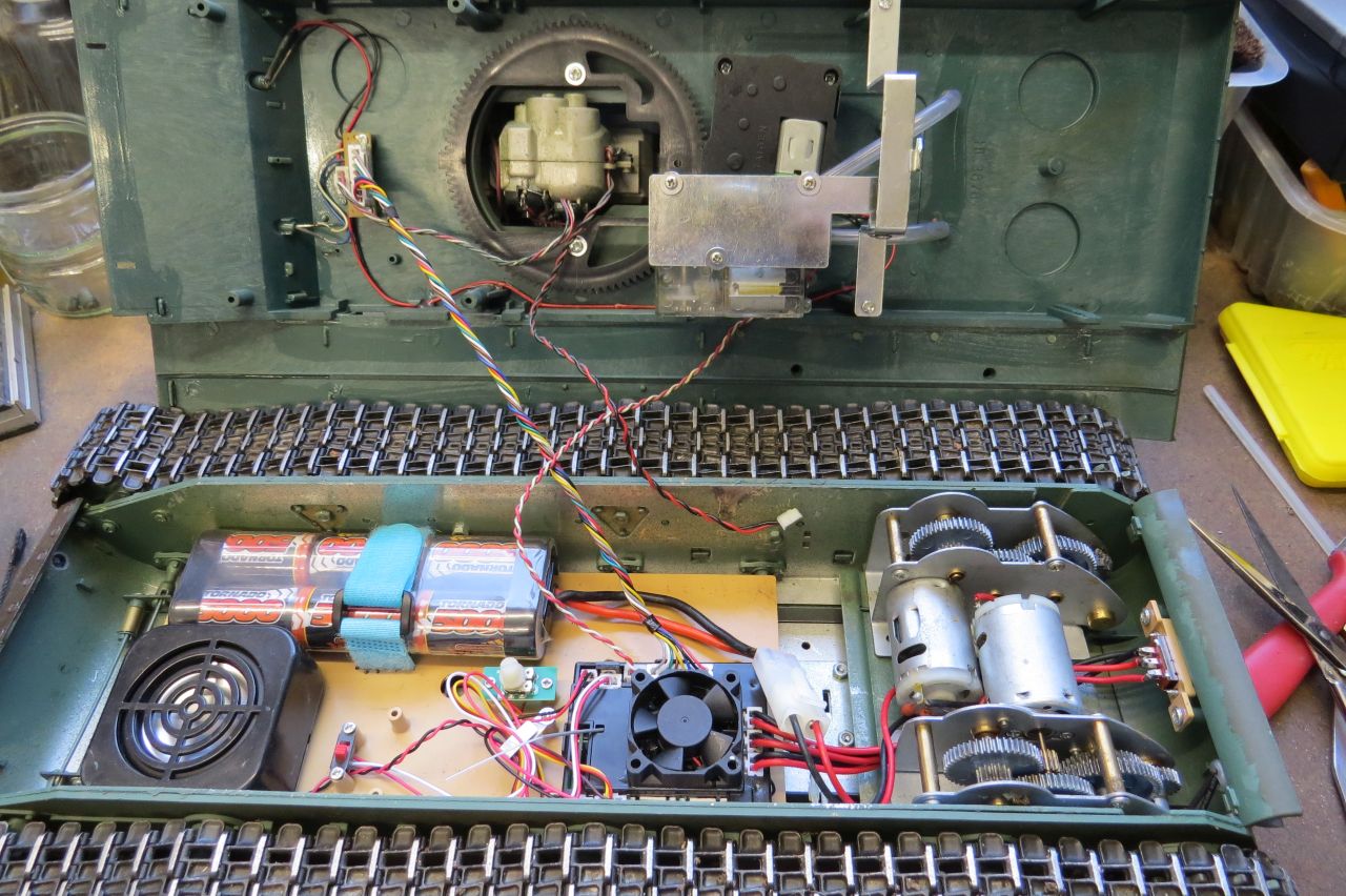

Hope somebody can help. When I took the top off my newly acquired KV1 two wires with two pin connectors on the end came adrift. There is a red/white combination and a red/black combination. I think I got the red/white wires from the smoke unit back in the correct place, although I could be wrong. However, I can not find another socket anywhere for the red/black wires from the turret to go. Any advice gratefully received.
Eric

They are for microswitch on the back of the BB gun

Thanks John, much appreciated.
Its no wonder I was confused as I was looking for a two pin socket for the two pin connector when it actually goes in a five pin slot.

That 5 pin socket comes into play when you go down the barrel flash route, a very low cost enhancement if you are running with the IR battling system.
