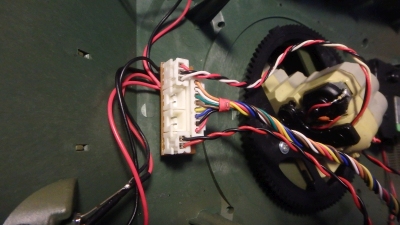

can you post a picture of the upper hull wiring

Yep...john1970 wrote:can you post a picture of the upper hull wiring

ok you have 5.3 8 pin connector but have a pre 5.3 turret your bb gun and elevation are on a 3 pin plug and are plugged into headlights and mg socket your turret rotation is plugged into gun elevation.
remove the 3 pin plug and move the rotation unit plug 1 across then check if you have lights,mg and rotation working
EDIT
its possible the tank has be upgraded from 27mhz to 2,4ghz but they didnt know how to wire the turret

No lights, mg led or turret rotationjohn1970 wrote:ok you have 5.3 8 pin connector but have a pre 5.3 turret your bb gun and elevation are on a 3 pin plug and are plugged into headlights and mg socket your turret rotation is plugged into gun elevation.
I think so - just found the instruction book in the box, it's for the 27MHz crystal version...EDIT
