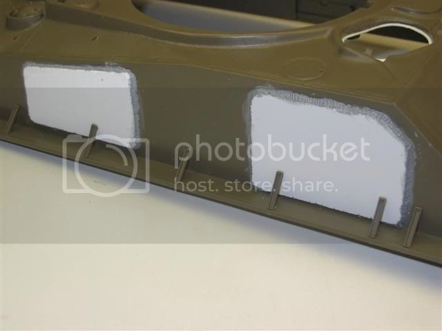

Good evening, can someone tell me what thickness of plastic card to imitate the plates of a Sherman's armor, please. :thumbup:

Hello, and thank you for the answer and the pictures :thumbup:
I am writing off the plates on the sides of the upper frame, as well as the right side of the turret seems to me ? I own a Sherman Tam, and I admit not really knowing how the improve, even if very nice achievements on this forum, good day

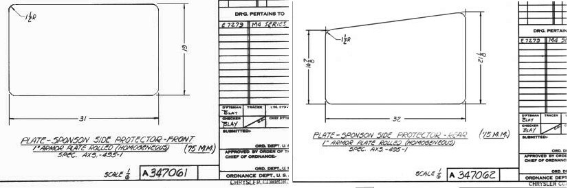

i was talking about this

I used 2mm plasticard on my Sherman.

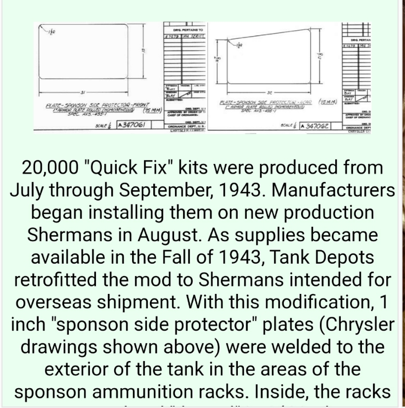

Posts: 7594
Re: Surblindage Sherman
Looking at this on the Shadock site, it appears to have been one inch thick. Therefore 1.5mm will work :thumbup:

thank you to you :thumbup: but the super, even the dimensions? and yet have I been through the Shadock’ :shifty: site many times? but so much information that not everything noticed

1 inch is about 1.5 mm, I find 2.5 personal?
the coats on the photos are in inches? I think
Posts: 7594
Jofaur86 wrote:I find 2.5 personal?
Sorry, what do you mean?
Jofaur86 wrote:the coats on the photos are in inches? I think
Do you mean the measurements are in inches? Yes they are.

i meant i found 25.4mm for 1 inch, instead of 1.5mm? but maybe not good?
