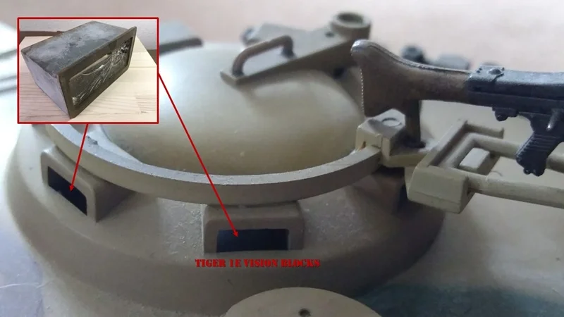

I've tried using bits of clear perspex in the past, with a backing colour- but does anyone have a tried and tested means of making Tank and AFV periscopes look convincingly glass-like?
This would also apply to vision blocks for the Driver and Commander's cupola.
These (taken from Rock Steady Militaria) are said to be real Tiger tank vision blocks:
This Tamiya Abrams has the sort of look I'd like for some jagdpanther periscope lenses/blocks. How can they be simulated?

Schumo make periscope kits, for example, for the Tamiya Panther Ausf G:
They look okay, except that they should reflect light at certain angles. These just look like-well, grey bits of plastic. They need to have lustre. But how?
