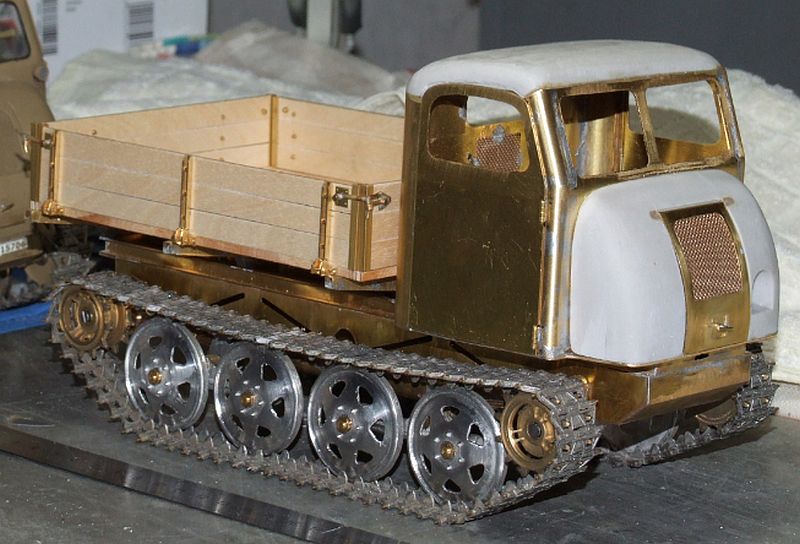

Manfred Zinnecker builds metal RSO´s on request:

jhamm wrote:Hi,
They are beautiful
I would love to see one of those working in RC, is he on RCTW?
I wonder if a set or tracks and sprockets would be available, he looks like a talented man

jhamm
Posts: 1101
Location: Germany
Re: 1/16 RSO & variants
Post by jhamm »
Will01Capri wrote:
They are beautiful
He is at the German "HengLong Panzer Forum" active, as the User "Willi" .

You can also reach him on Facebook:
https://www.facebook.com/pages/category ... 713159712/
he had formerly a Modelbuilder business
