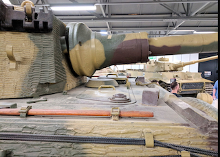

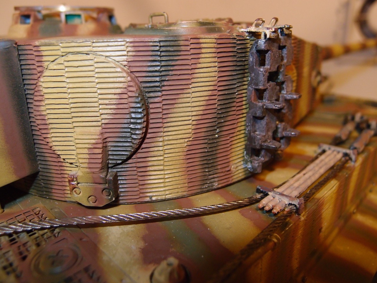

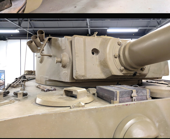

Here are some pics , its all about how high the turret sits and are the headlights the correct size. It would help if you posted a pic of the gap between the deck and turret :D
The gap between hull and turret
The tank museum KT gap
Screen Shot.jpg (120.26 KiB) Viewed 1834 times
The tank museum Tiger 1 gap

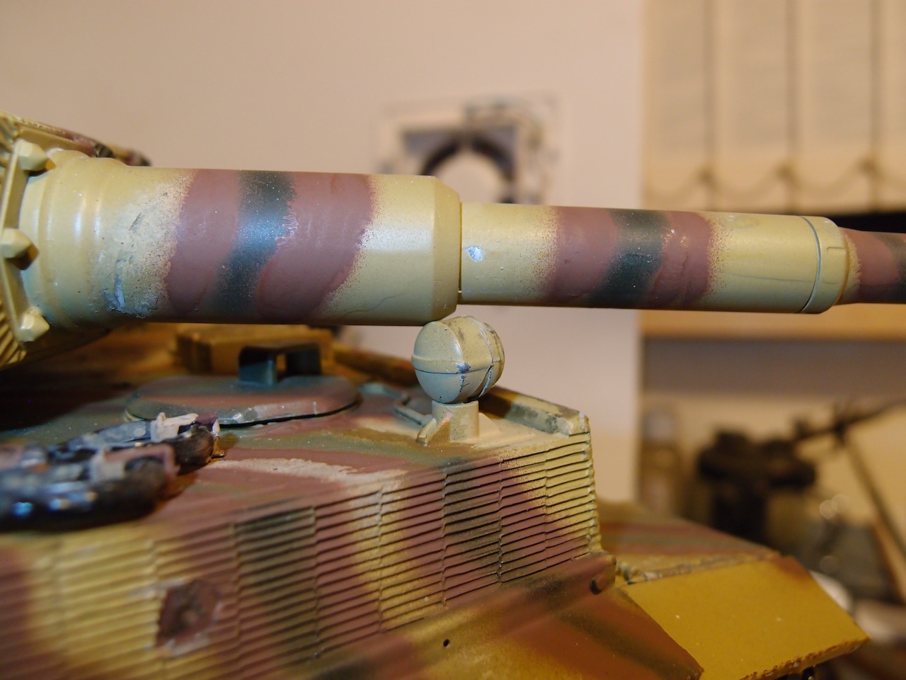

This is the problem, cant see the German engineers putting headlights on that can be knocked off when the gun is level.

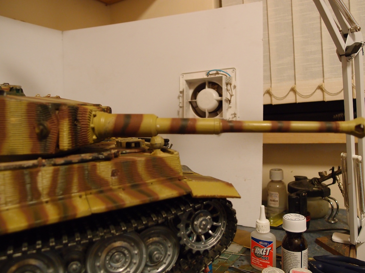

Hmmmm. Here’s a pic of my old bucket with the gun very slightly depressed and still barely clearing the headlight. The upper hull is Heng Long, the headlights are some aftermarket metal lights and the turret and barrel are Taigen.
