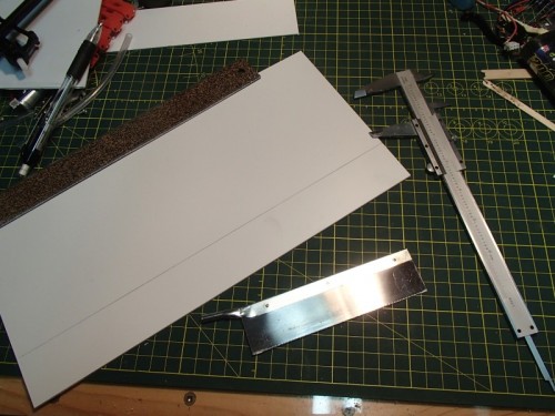

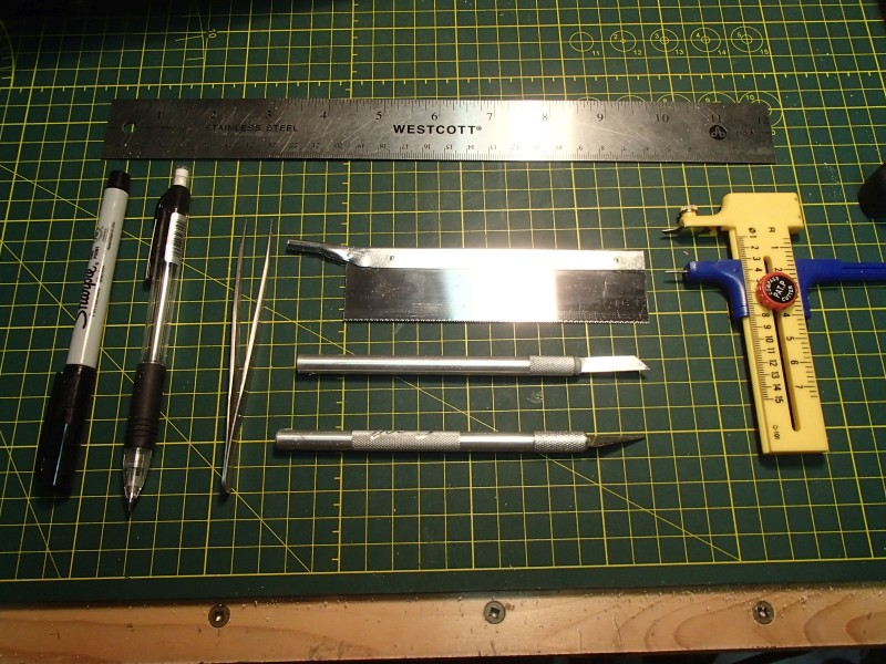

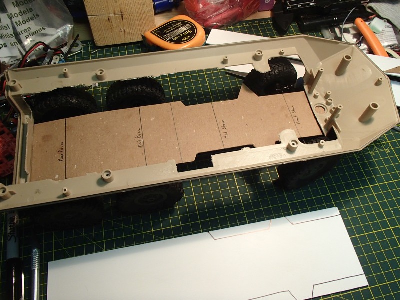

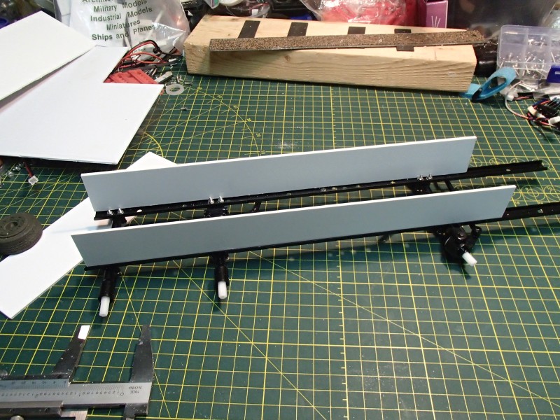

Maybe a Proxxon 37006 KS 115 Bench Circular Saw or similar...
Just a old school Vernier caliper for measuring... No fancy digital here.
Read the graduations! READ THEM!

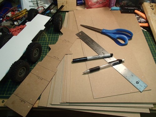

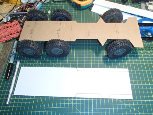

Basic straight lines are pretty simple, but when I start having to do coping or more intricate details.
Layout is key for me. Make a simple template, go scissors!
Thankfully I have an ample supply of cardstock for layouts.
And way more from my place of employment. (They literally throw these away!)

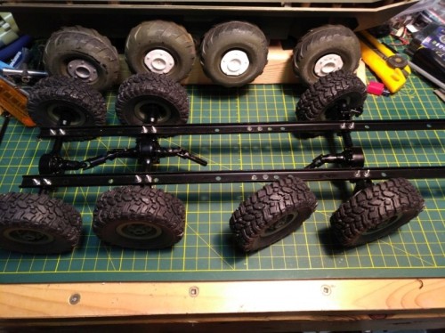

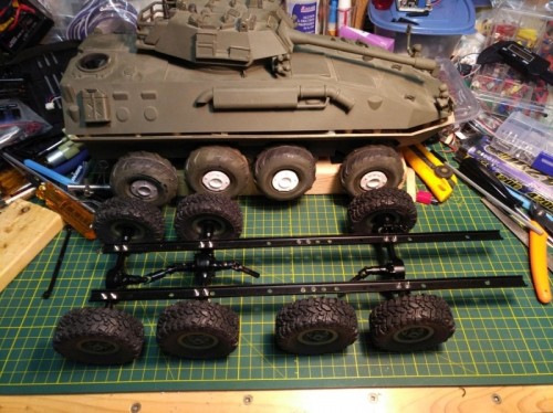

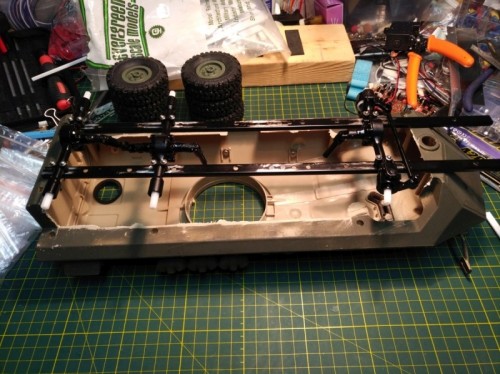

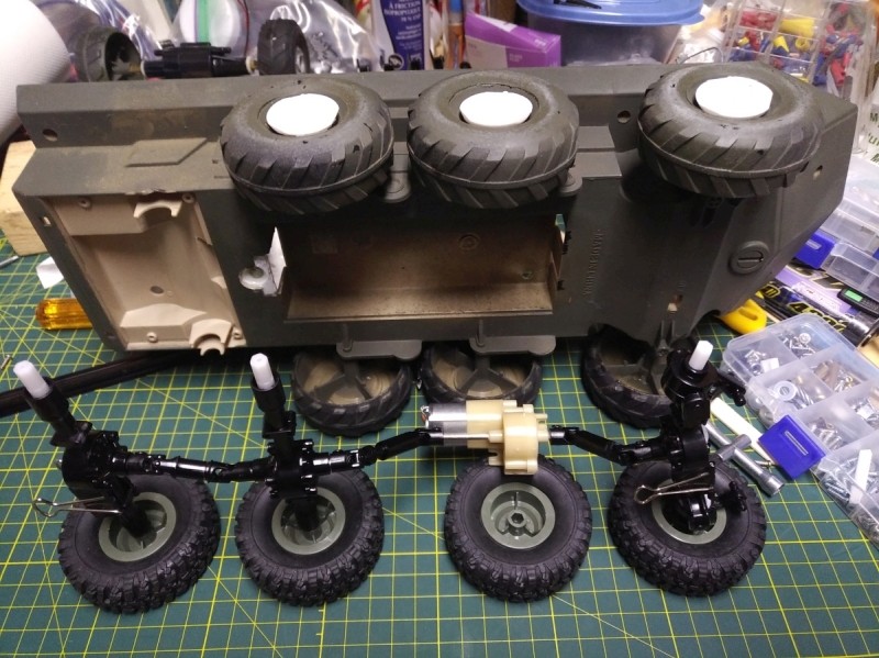

A small bit of advancement (My buddy Chris from NY sent me some spare axles and a whack of spare tires/rims from Dean = progress.)

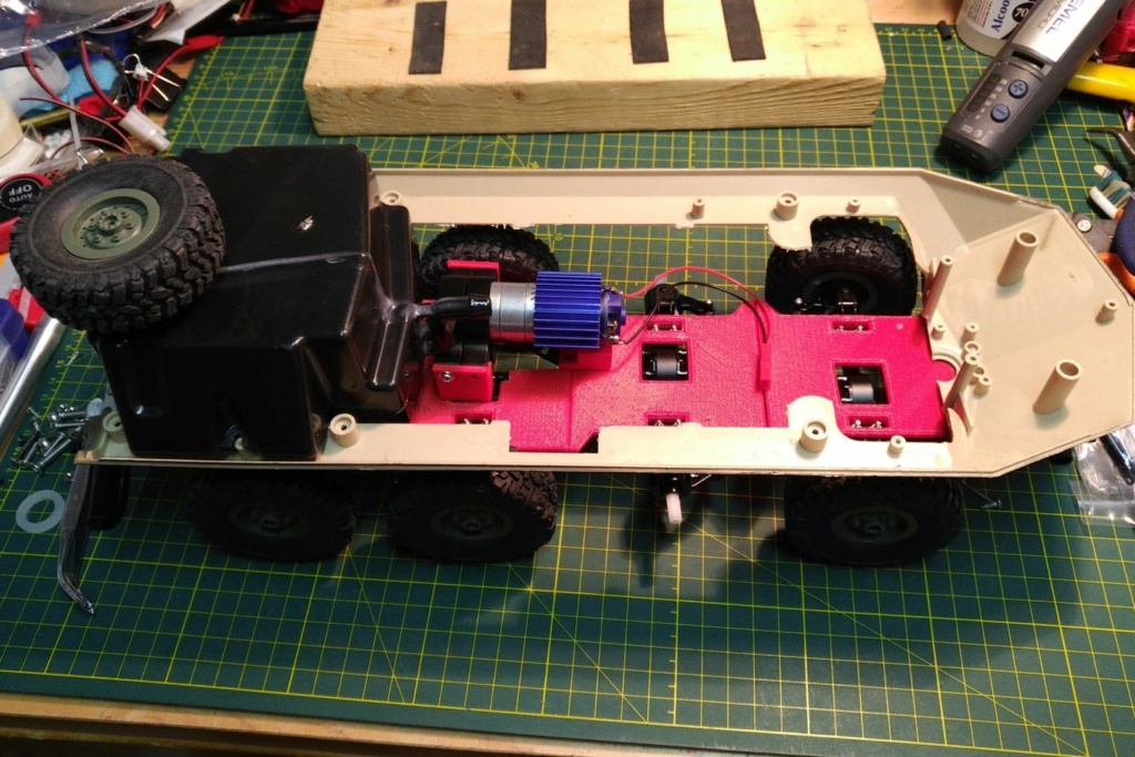

Still unsure If I'll reused the old water tank. It fits. Barely! Trimmed down the existing water cap with the "tire" and fit it into a WPL hub completely. A Full sized spare!
Yes that is a "full size" spare tire now used as the water cap for the tank portion. I think it looks good. I'll likely have to limit turret travel now however.
How it looks with the upper hull loosely put into place. RAR! Upper hull will be the last pieces to be revised/rebuilt/tampered with...

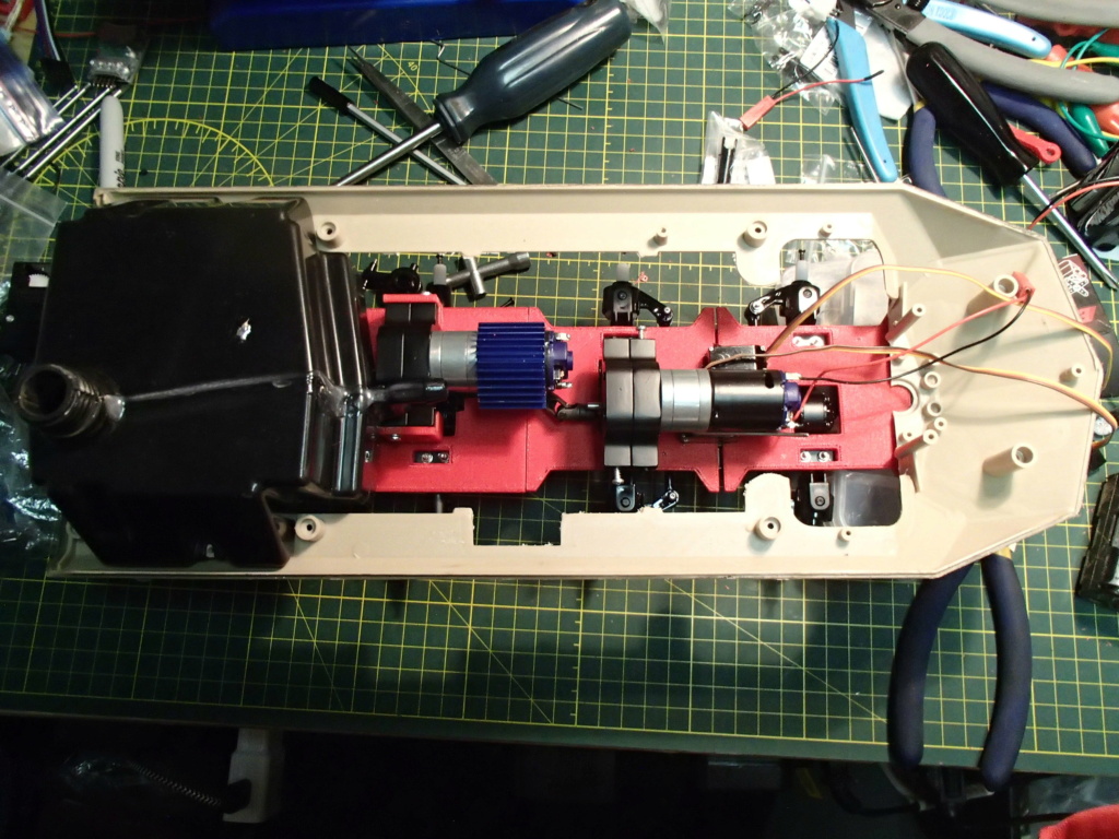

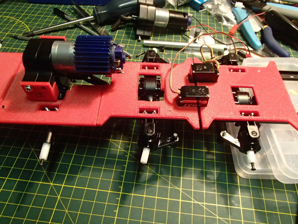

Adding in the 2nd servo for steering since all the other concepts for single servo/dual steering were lack lustre in final forms.

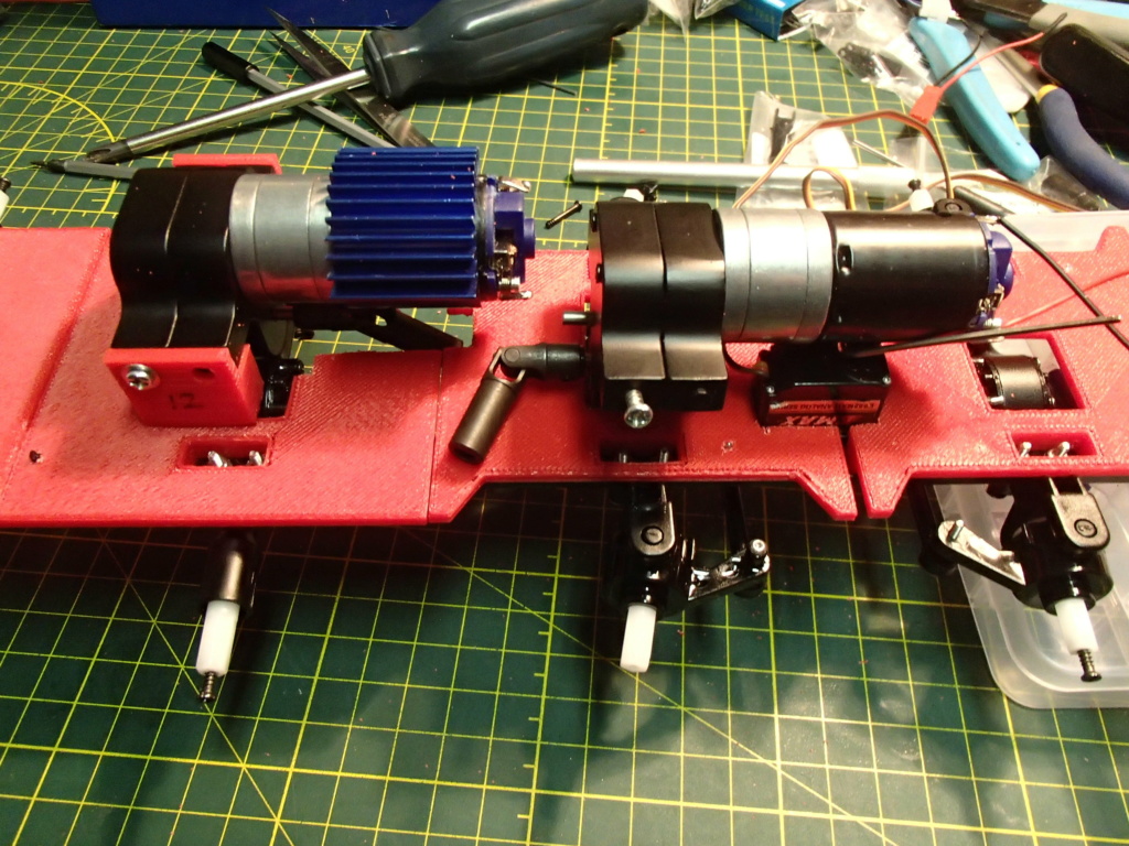

Rough concept placement for the 2nd drive motor (Mounted one with heat sink drives the front wheels)
Steering linkage under the chassis in it's final configuration.
Again rough concept of the existing water tank space claiming. It is a VERY tight fit... May need to be modified.
Side shot showing the height. I may also need to use Heng Long rotation units due to possible interference fron the new drive motors.
Showing the conceptual test of steering with a "final linkage solution"
The driveline test! Both motors hooked up to a 6V battery pack (4xAA). You can see the tails of the Z-bends in the steering linkage video above. Forgot to trim them and they fit right into the universal joints of the driveline. (Whoops. Now trimmed down to avoid interference)
