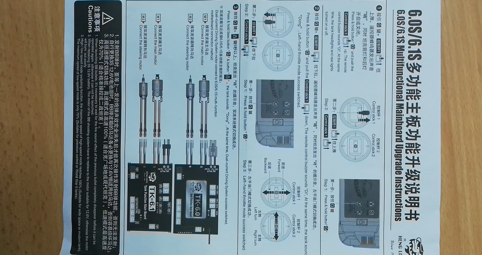

Now found the solution, it was in the manual, which I didn't have. A couple of button presses and the v6.0/v6.1/v6.1S will all function with the DKLM gearboxes.
These boards are quite amazing, light years ahead of anything HL has produced previously.

I’ll be damned! That surprising but it’s definitely welcome news for many. Especially DKLM!

I had looked through my HL 6.0 manual and I didn't find that page. Mine is from the T-72. I had heard the PDSGB were compatible with the 6.0/6.1 gearboxes, but like you I couldn't verify it last night. There it is in black an white though.
