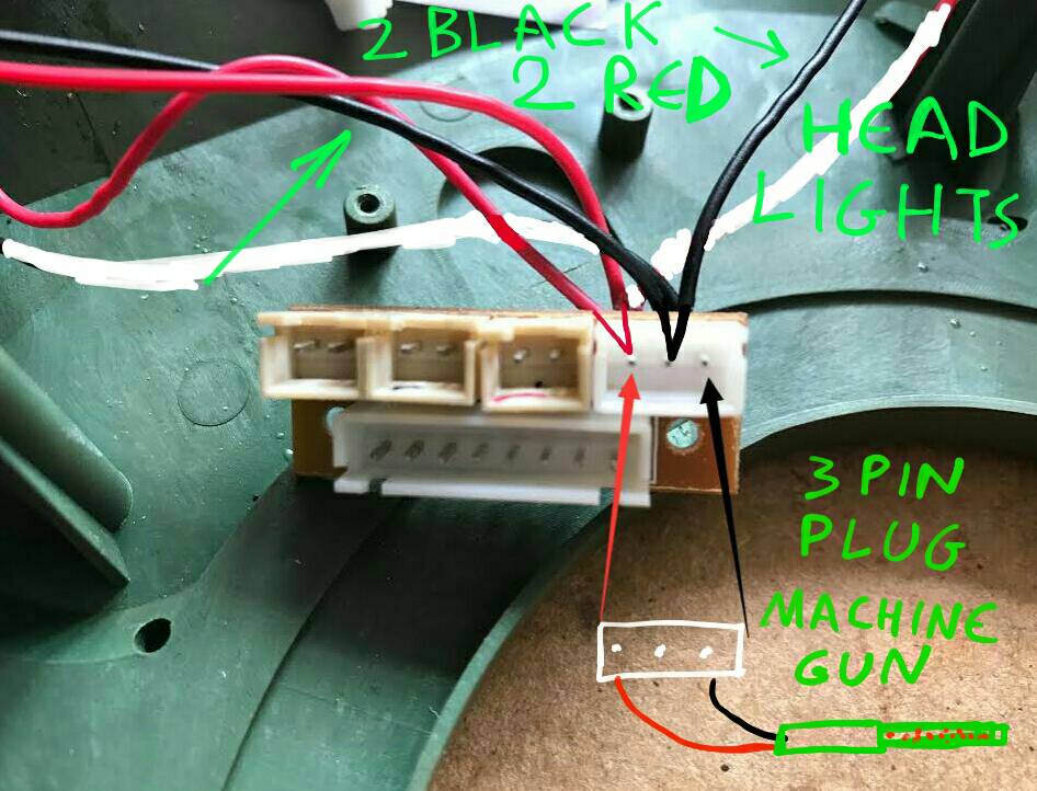

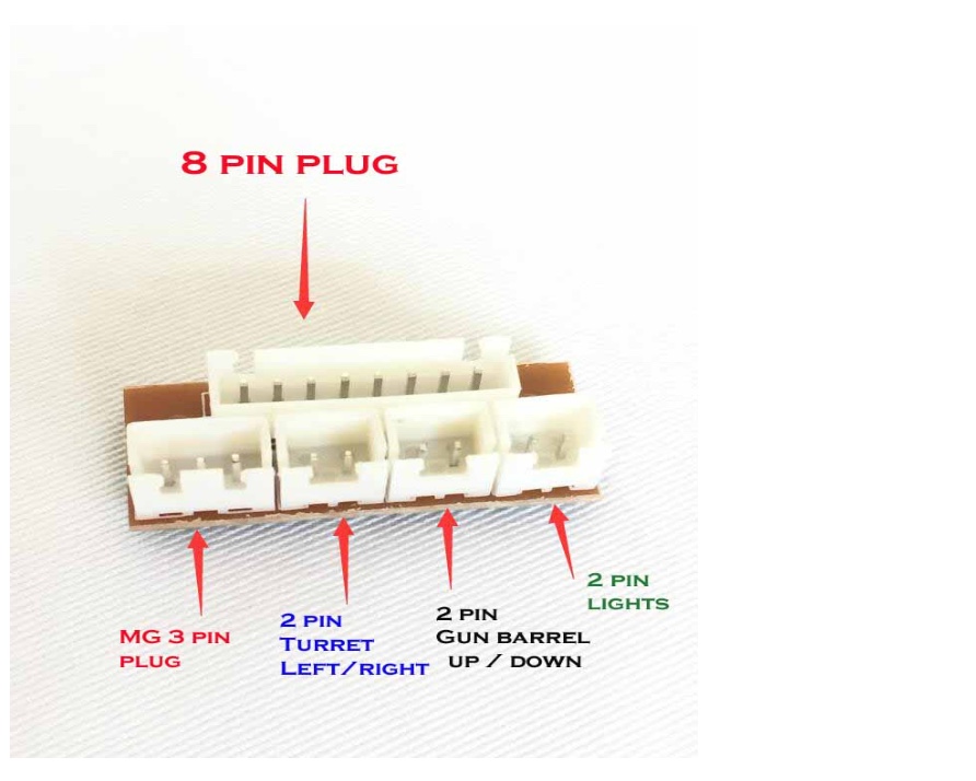

Don't cut any wires. !!! It's generally possible to extract wires from their respective connector blocks with a thumbtack, or a small watchmaker's screwdriver. If the need arises, that is. You may simply have inserted the connectors into the respective connector blocks the wrong way round. :problem:
5.3 systems require this upper hull 8-Pin connector block. If you have an earlier one, you will have compatibility issues.
HL 8 Pin adaptor for 5.3 systems
HL wiring new adaptor.jpg (96.12 KiB) Viewed 861 times
HL V5.3 8-9 pin upper hull connector
