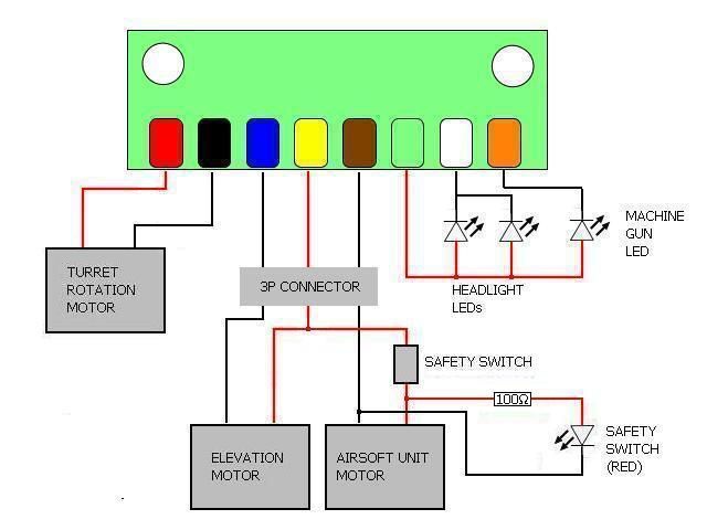

Schema principle HL,Taigen,Torro,color of the tablecloth betwen turret and RX hope can help :thumbup:

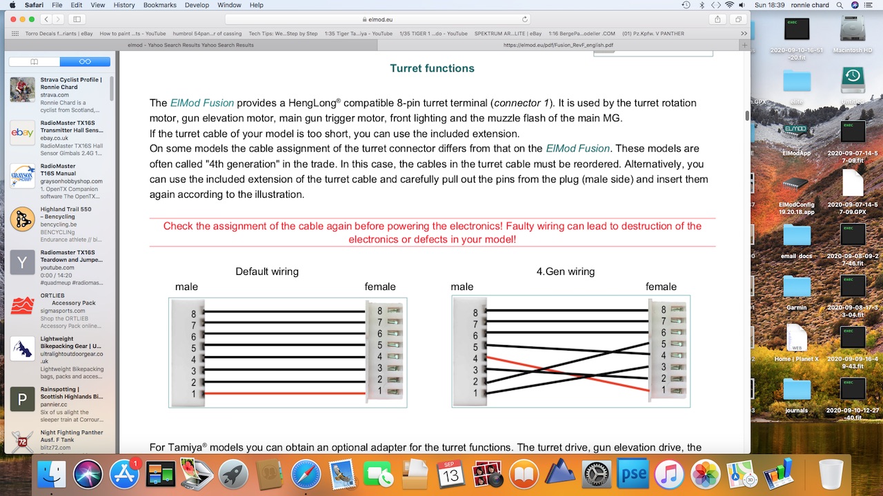

If you think its the 8 way cable look at the manual pic here.
Re: HLong Tiger 1
When you say 'new' Taigen Transmitter (your 'handset'), and MFU, do you mean the V3 iteration? It would help a lot if you could post pics of the internal wiring layout of your venerable Tiger.
Simply changing the controller and transmitter on an old model is unlikely to be straightforward swap,and certainly not from a wiring point of view. Older tanks, as in Jofaur's diagram had the elevation and airsoft units linked. The latest ones don't. That may be the source of your problems. There's also a three-pin plug on older models, and if you insert it into the block connector (8-Pin ribbon connector block) the wrong way round, the gun won't function.
Going a little back to older basics, have a look at this video from Erik 'Taigentanks, it may help a bit. :wave:

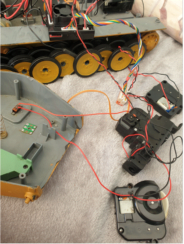

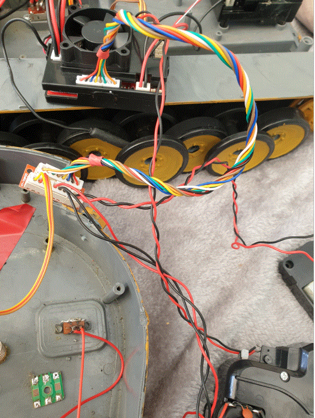

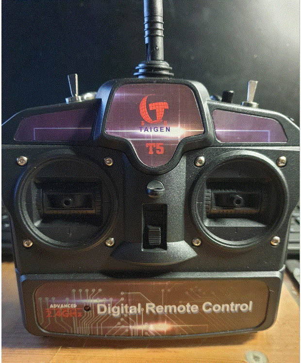

Thanks again for all the advice, please see below pics of my setup, including my Digital Remote Control handset. I haven't connected up the lights
3a
3a
2a
2a
1a
1a
Rhat
