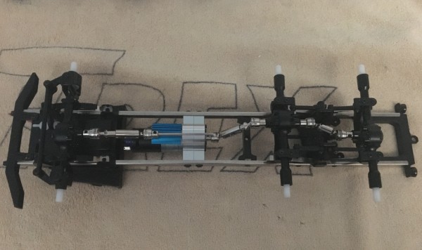

So, the first step is the usual; strip down a WPL B36 and upgrade some parts; I chose to just do the drive train as well as the metal gearbox with 370 motor (the inner axles themselves are metal meaning I do not have to worry about splitting gears, hopefully... :crazy: )
image0 (3) (1).jpg (45.94 KiB) Viewed 2564 times
I had some issues with the front axle however, most namely constant friction and slipping/ sticking. The cause turned out to be a misaligned hole in the axle itself, which meant that at random intervals it would slide out of place and prevent both gears from moving. Luckily I had a working front axle laying around that I was able to replace this with.

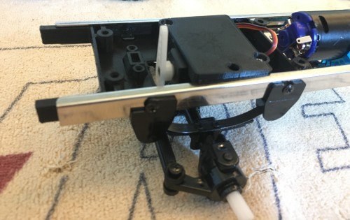

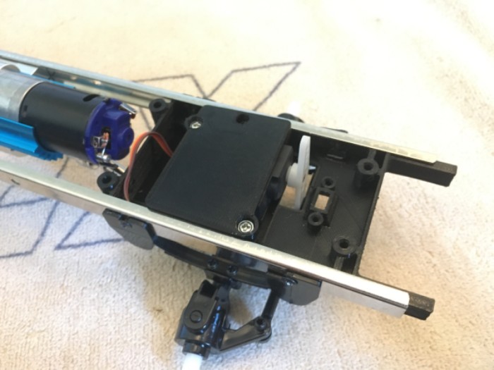

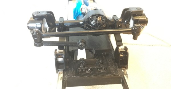

Made a tiny bit more progress: 3D Printed and fitted the servo clamp, cross member, and steering rod from another one of TheDiyGuy999's thingiverse posts: https://www.thingiverse.com/thing:3251633/files
I also fitted the wpl servo which you are sent for the kit version of the b16 to this member, replacing the awful standard binary steering with proportional steering. (I apologise for the bad image quality.)
image (13).jpg (44.44 KiB) Viewed 2534 times
image (14).jpg (31.57 KiB) Viewed 2534 times
image (15).jpg (64.67 KiB) Viewed 2534 times

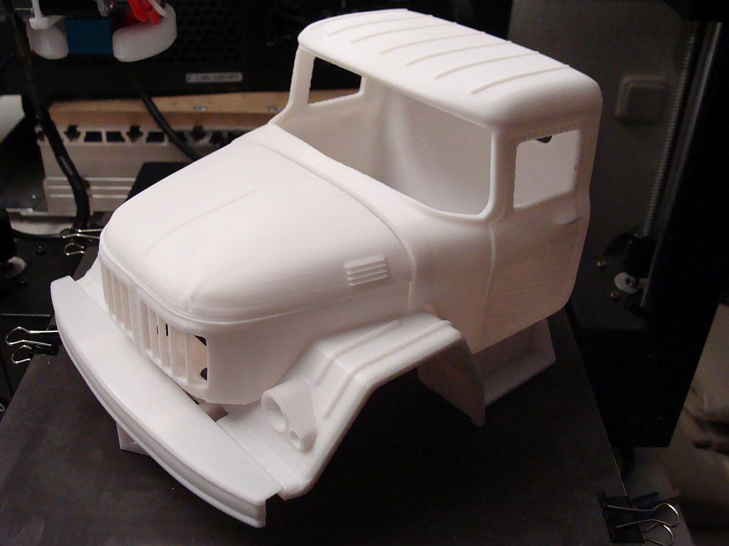

FYI
at Thingiverse is a ZIL 131 CAB in high Qauality.
need arround 45 hours print all Parts:

jhamm wrote:FYI
Yeah that's the cabin that the DiyGuy999's trailer system is based on, of which he designed tons of extra attachments for the cabin as well as a battery tray etc
