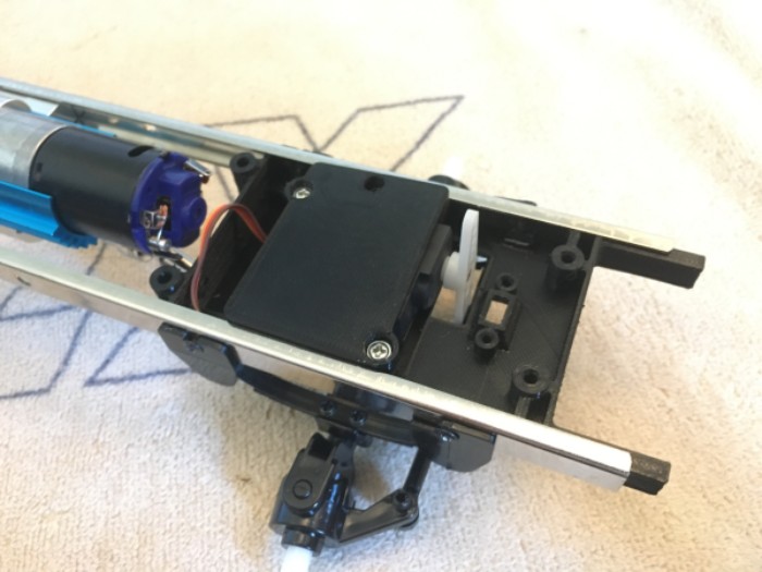

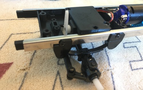

Evening all,
Made a tiny bit more progress: 3D Printed and fitted the servo clamp, cross member, and steering rod from another one of TheDiyGuy999's thingiverse posts: https://www.thingiverse.com/thing:3251633/files
I also fitted the wpl servo which you are sent for the kit version of the b16 to this member, replacing the awful standard binary steering with proportional steering. (I apologise for the bad image quality.)

I will return to this project once my Dasmikro TBS and other electronics have arrived.

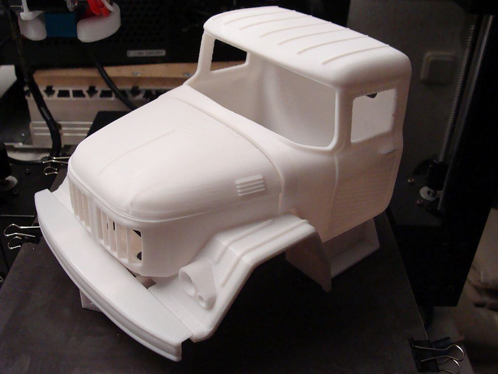

FYI
at Thingiverse is a ZIL 131 CAB in high Qauality.
need arround 45 hours print all Parts:

jhamm wrote:FYI
Yeah that's the cabin that the DiyGuy999's trailer system is based on, of which he designed tons of extra attachments for the cabin as well as a battery tray etc
