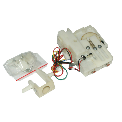

I really just want a slower more crawly tank, this might seem a little weird to ask, but is there a way to have the tank barrel recoil, while keeping the airsoft unit in tact? (It is a Heng Long Pershing M26 tank)

Nos it is not possible to have the recoil
by keeping the airsoft.To have the recoil it is necessary to opt for an Asiatam system,but in this case more shooting balls
On the other hand,the plastic barrel must be replaced by an aluminium one,plus some other parts,for the speed,there practically no some progressive variation,and it nécéssary to have a light finger on the joystick,to have a suitable result
