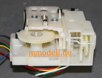

I want to replace my RX 18 Taigen ? On my Jagdtiger,with an Elmod fusion eco ( 1 ingle servo ) and Asuatam recoil system?what do you think :'( the servo output will be used for the machine gun :|

The AsiaTam (or Taigen) recoil units are a solid system if you don't want to use servos. I have them with Elmod in my Tiger and Sherman Jumbo and they are very reliable although the elevation range is a bit limited. I haven't wired one up for a while so I can't remember what needs to be done but if I can do it without killing any components you shouldn't have too many issues.
There is an easy mod I would also recommend. There is a raised section on the cog that turns to set off the recoil. This needs to be trimmed back (shortened) a few millimeters otherwise there is a slight delay between the gun firing and the recoil happening. It takes a bit of trial and error to get it right as if you cut too much the barrel wont stay forward but it's not difficult and makes a big difference.

Thanks a lot B.man :thumbup: although not all figured out what to do ? Attached photo,if you were kind enough to tell me :{

Not reed weal ? ( read too fast )Your answer!!!is there any importance for the cut ?? Which side :thumbup:

The starting point of the recoil unit wheel needs a little trim.
When the fire sequence is triggered, the delay in movement is noticeable.
If you trim a fraction off, it will move more in time with the sound & flash.
Its under the gear you see when the unit is in its normal installed orientation.

Thank you for your advice :thumbup: OK Herman,will try it out :D good day

Herman is correct but just so it's clear this is what I'm talking about.
