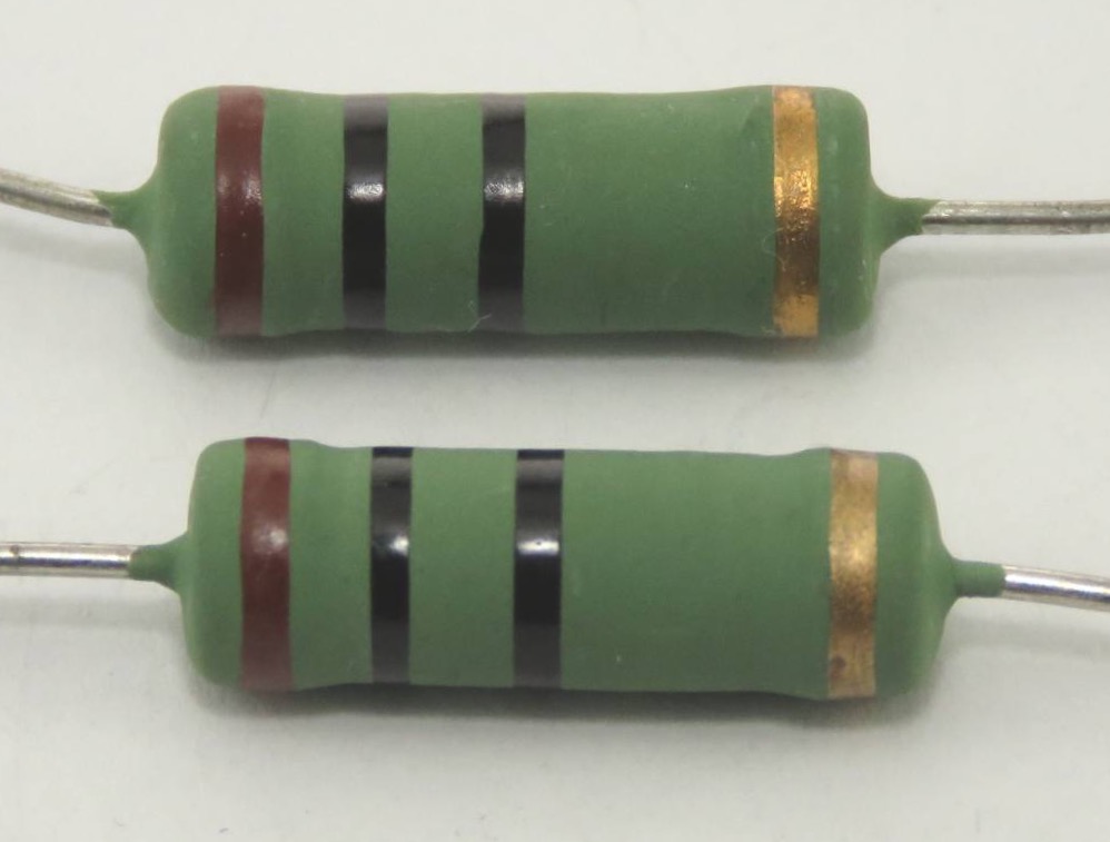

Question to Mr. Rad ,
Is this kind if resistance ,suitable for you systéme smoke ??tank you in advance for you help :thumbup:
10 Homs 2 w

Question to me? I feel honored, lol.
The first entry I wrote on my website was about the smoke generators. You can take a look at it, under the tutorial section. It has some things that will be corrected and expanded very soon.
What a coincidence, last week I started researching how to make better, more reliable and less hot smoke machines, so I kept asking all the experts. RCtanks australia, IBU, open panzer, clark... I'd say the general consensus is to use nichrome wire, about 20-24cm long, 0.1mm thick or so.
Mi personal experience with resistors is they take more time to heat (and hence to produce smoke) than the nichrome wire, but once they do, they produce heaps of smoke... And also heaps of heat, making the plastic enclosure almost untoucheable and risking the tank electronics.
If you are using a hobby grade radio it is safe to do any experiment. Just get a 2.50 free shipping ESC and test giving several voltages to it until you produce the smoke you want. I have that system in some of my tanks. I manually control the smoke output with a potentiometer.
For standard heng long electronics it seems something between 7-10 ohms 0,5w can work, but there are a lot of variables, like if you are using a pump or a fan, super smoke oil, baby oil or glycerine, what kind of wick...
What I can tell you is at this very moment I am planning to do experiments with a 12v fan, nichrome wire, kevlar as a wick and baby oil as fuel.
Il publish the end results but it will take a lot of time until the parts arrive from china. Hope it helped somehow.
