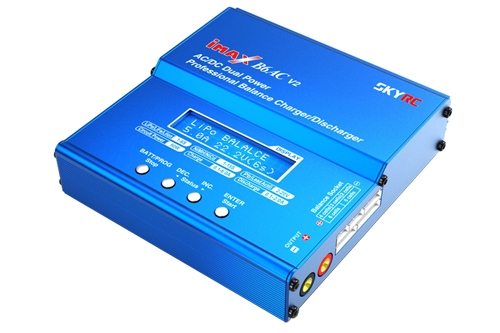

If the original batteries ? It is Nicd...and certainly at the end,of its lifes ? I recommend Nimh and a good chargeur :thumbup: not the original one wich is a vulgar power supply :thumbdown:
Chargeur :thumbup:

I recommend the charger shown above and the NiMh Overlander Tornado range sold by Jadlam models (UK based). These come in modest to high mah types, are plug compatible and great value. They have their own website and are on ebay

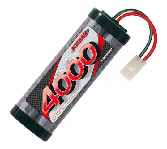

Here’s a screenshot of the Ebay page I ordered mine from. These were recommended to me by Rad. I love them and they last several days of after work tank driving in my backyard. I haven’t actually measured their exact time used before needing recharged but its a big improvement over stock Heng Long style batteries. One of the best upgrades I’ve made. These are enough to to make two 2cell battery packs.
