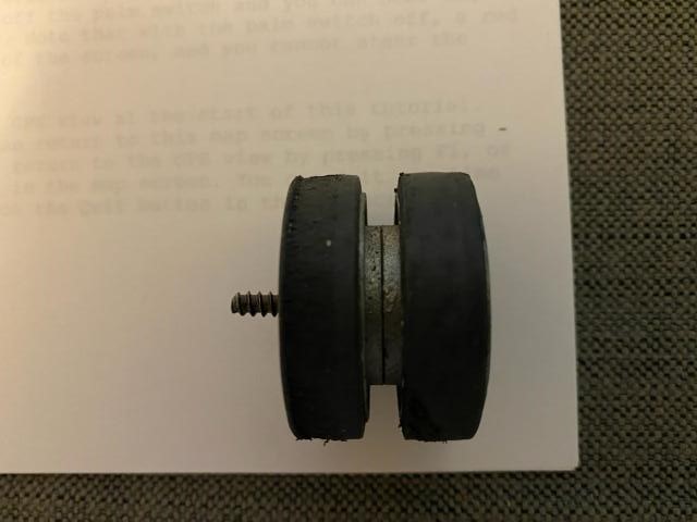

I took my M1A2 out for a run. Its been quite a while since I ran it. It ran like a Jagdtiger. Very slowly and sluggish. I also heard it emmiting a high pitched whining noince that I don't recall emitting before

I also checked the treads and noticed one side ran more smoother and freely than the other.

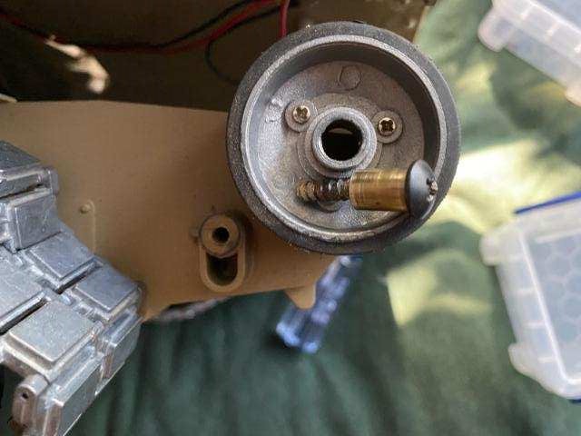

I took apart the problem side and noticed the front roller wheel was jamming up. I took it apart and it doesn't look right. Looks like a part that dissolved?
In any case something doesn't look right like I'm missing a plastic washer or 2?
When I inserted the screw that holds the wheel in place, into the roller wheel I noticed it would freeze up after a rotation or 2 so I've scraped off some junk and cleaned it up so it will rotate freely.
I have a few questions for anyone who might know off the top of their heads.
1. Should this front roller wheel assembly have washers? Plastic or metal?
2. I have some white grease. Should I apply that to the upper brass part of the screw that holds the roller in place and fits snugly inside the roller to assist in a smoother functioning?
3. I've heard it mentioned a drop of locktite is good to hold screw in place to prevent it coming off during operation. However I've also heard that locktite and plastic is a very bad idea. It can cause problem. Some have suggested fingernail polish or GE silicone caulk.

The screw looks bent on this photo try grease and some have washers others don’t tank dependant

If you use loctite make sure it's Loctite 425 for plastic. Otherwise it may eat the plastic. I have a bottle here, it's a shame you can't pop round and borrow it, because this stuff is expensive, like $25 a bottle. Works great, though. Have you thought about a henntec? Not cheap, but I put one in my Abrams and it worked great. I was well satisfied with it's performance, and it made having the hi-quality tracks easier when it came to tension adjustment.

The screw does look bent on the original picture. I did a double check and took a couple more pics and looks ok. Sounds like you were able to see sound file? I wasn't sure if it actually uploaded. Its a native .amr file created on an iphone and I'm able to play on my Windows 10 machine.
I noticed the price on the Locktite 425 on Amazon. Man that's not cheap stuff. I guess I'll have to bite the bullet.
