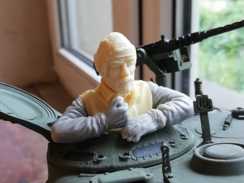

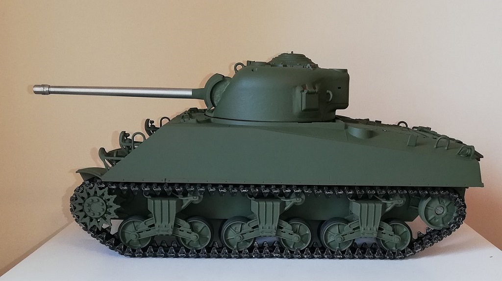

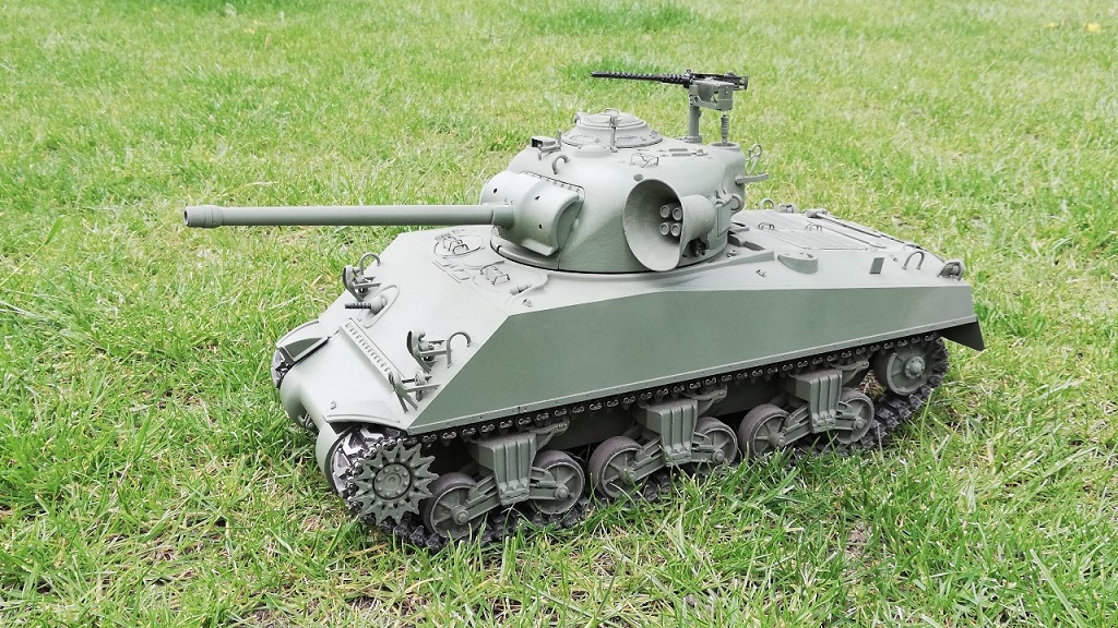

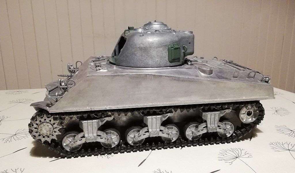

My longtime project (still in progress). Base was Taigen chassis and turret and Mato metal hull. It runs on Open Panzer TCB.
Barrell thread protector was made on lathe by my dad.
3D printed speaker:
Back mudflaps made of brass.

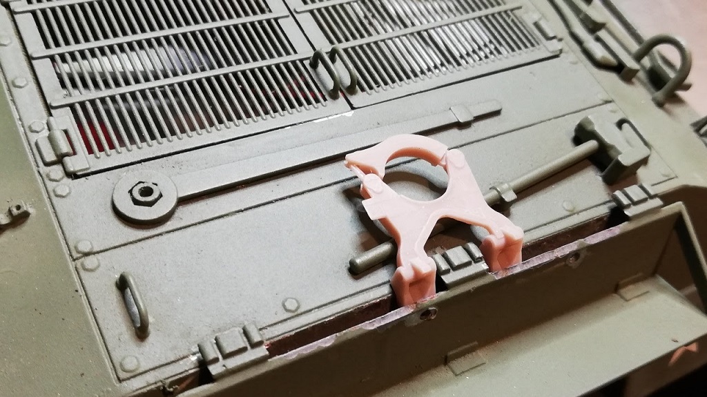

3D printed spare tracks and 50 cal barrell:

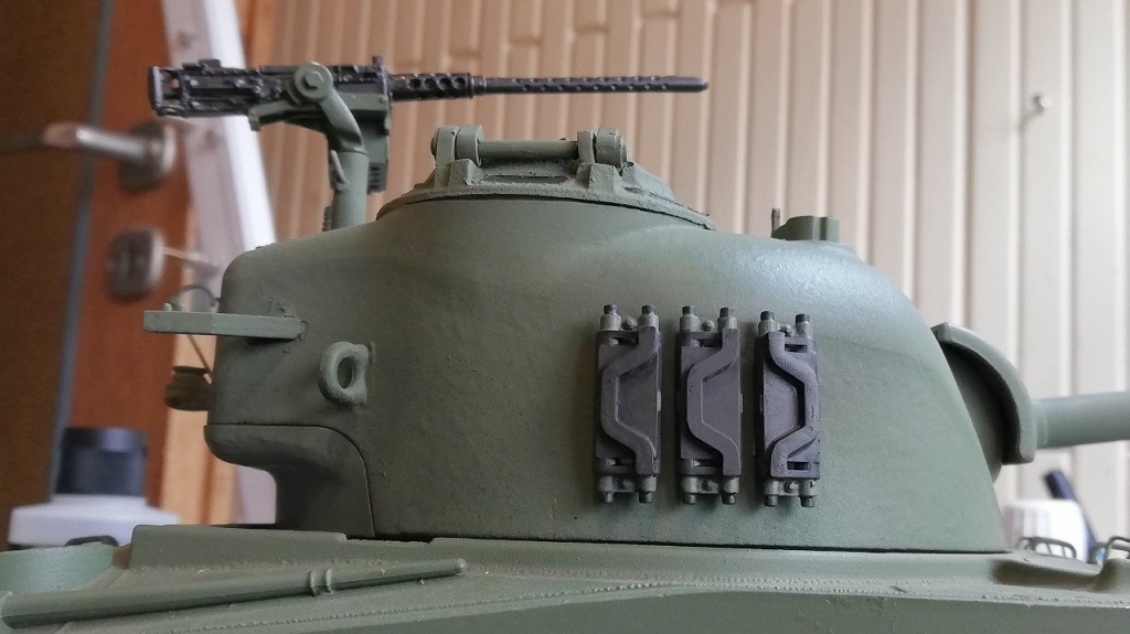

3D printed travel lock specific for M4A3E4 version.:

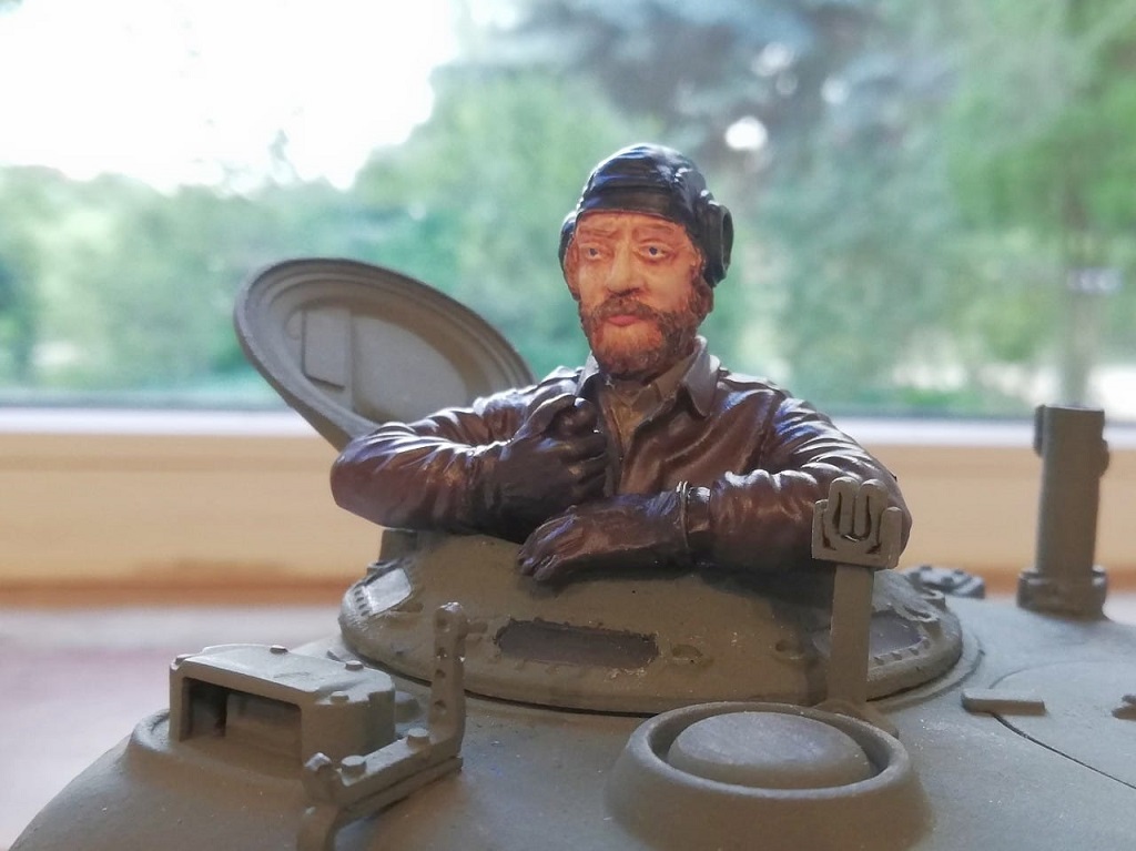

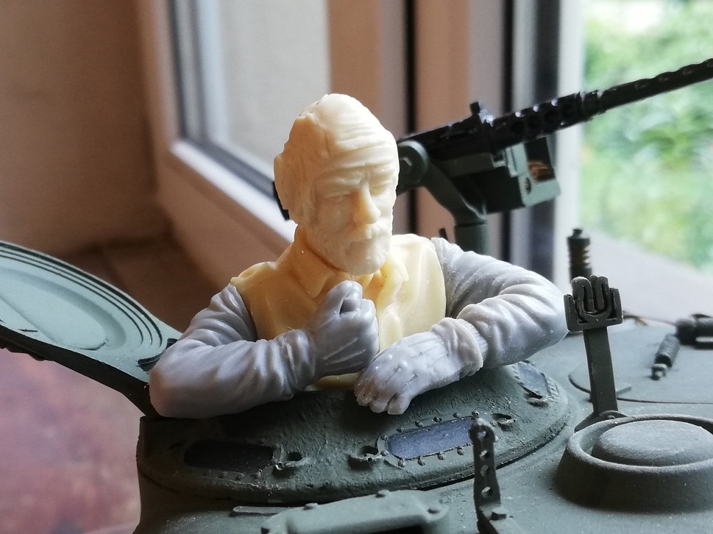

Oddball made of three figures:

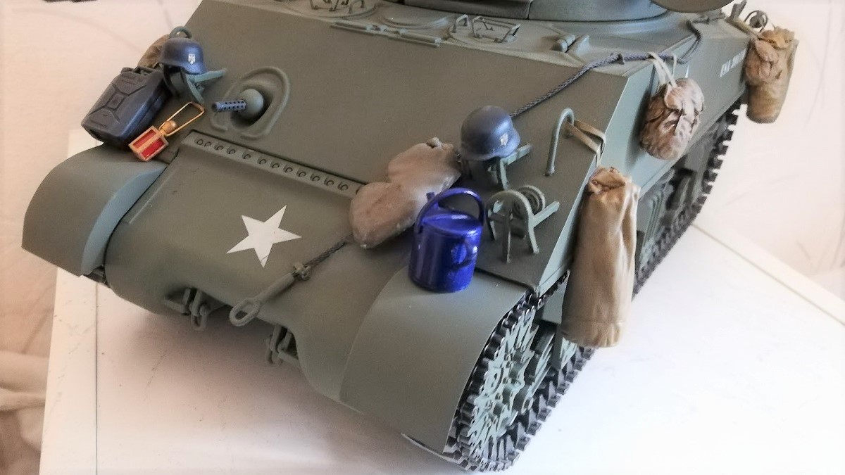

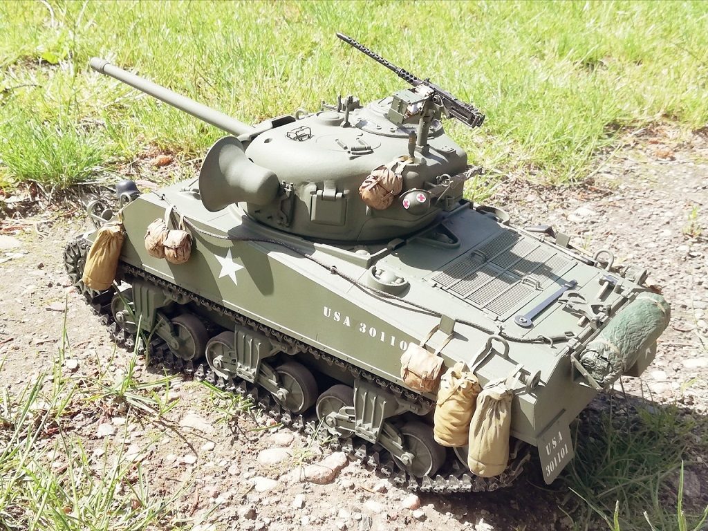

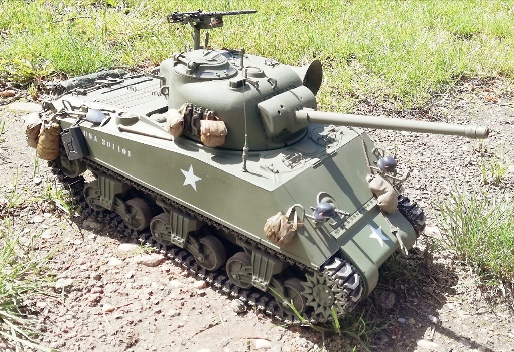

Some resin stowage added, marking was made using masks.
Songs from "Kelly's Heroes" added ;)
Still to do: front fenders, more stowage, weathering, painting Oddball. I don't have speed of Frankie so it will take some time.

Thanks :) My painting skills are not the best so Oddball looks little "stoned" :haha:

Kaczor wrote:Thanks :) My painting skills are not the best so Oddball looks little "stoned" :haha:
A really nice job sir! I would not worry about Oddball looking stoned. I should imagine that given the chance the film character would have spent most of the day stoned!

Wow, that is where your Avatar picture comes from.

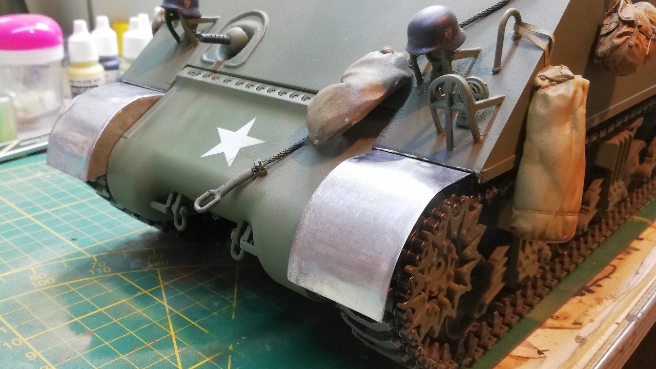

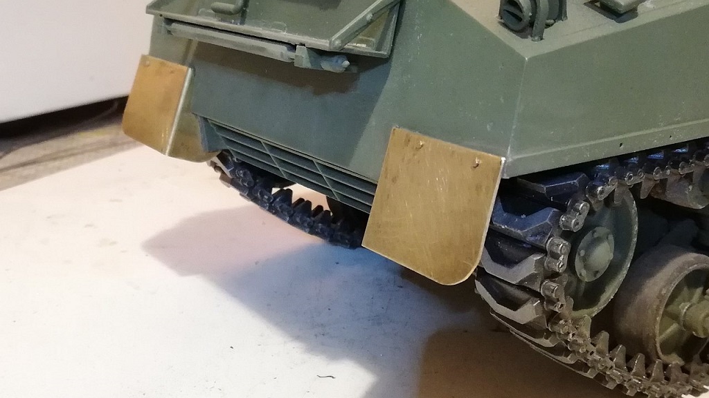

I returned to construction and made tin fenders.

Looking cool man...
No negative waves at your place obviously...
Woof Woof.
