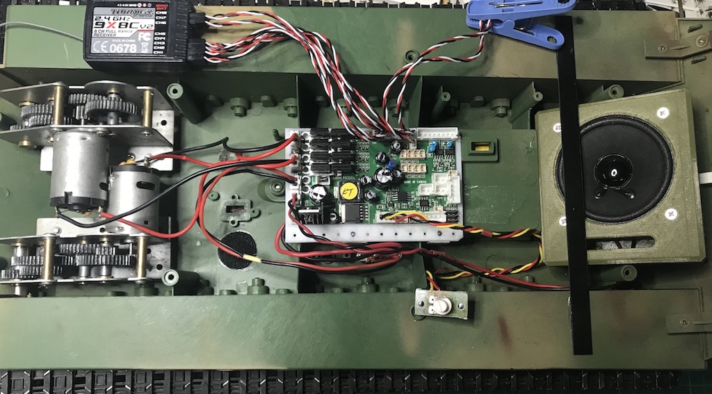

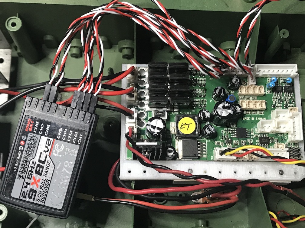

I have just started to install a new Clark TK60p into a king tiger and all was going well until it came to programming my transmitter.
I am using an old (grey) turnigy 9x and turnigy 9X8Cv2 receiver. I use this same combination for my TK20, 22A and 40 boards with no troubles.
However, with the 8 chanel tk60 I cannot work out how to program the mixes. I have tried the 8 chanel and the 6 chanel set up instructions from the clark website, but I cannot select the neutral gear or engine sound settings.
Does anyone have some other suggestions, or can someone with a similar rx and tx combination tell me the chanel/mix setup that they use.

Thanks for the replies.
I have exhausted most of my options, trying 4,6, and 8 channels.
Everything works except for the neutral gear and engine sound. No track movement.
The seller said to return the board as there could be a fault with it.
Also, from what I can see, most people use a FS-i6s transmitter.
Unfortunately I have a Turnigy 9x transmitter.
AK
AK

Re: TK60P help!
I did plug Ch 3+4 from the Receiver to Ch4+5 on the TK60 board, so you can use the second stick to start the engine and switch the gear.
