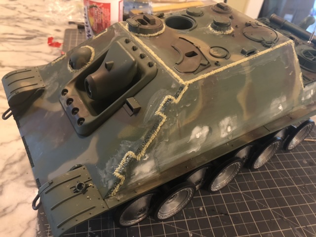

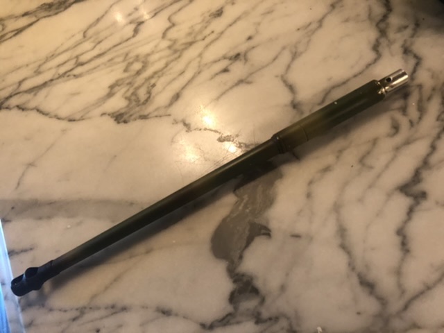

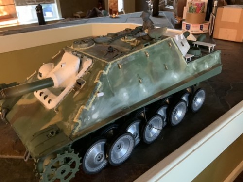

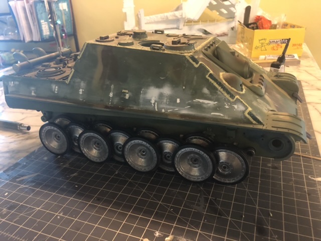

After a few years hiatus from the hobby, I ran across a smoking deal on a few incomplete, but decent shape HengLong tanks. The Jagd I am working on will be getting the full treatment. Upgrading all suspension and drive train. Converting from BB to IR battler. I just happened to have a recoil unit that was brand new for it. Modified barrel and insert into the recoil unit.
Metal wheels in place. Waiting for driver and idler as well as metal track and 3:1 gear boxes. I have some older electronics around that I hope I can manage to get to work. Will be running 2.4 radio with it. 6 channel probably for a few bells and whistles to be added. All the infrared sighting will be created on my 3D printer.

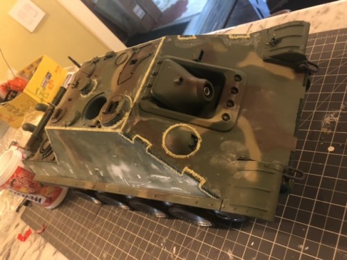

This weekend has been mostly working on the welds and flame cut plates. Going through what is missing and what needs to be fabricated. Generally forming a plan of attack and research work. Should be a fun battler with out the rotational turret.

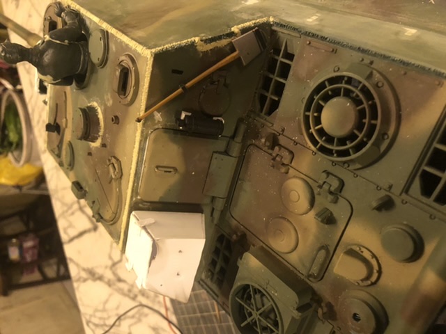

This eve I spent fabricating accessory tool box on back of upper hull. I also worked on the cast textures up front. Debating on zim or not at this point. I’m sharing some of the reference photos I have as well.
Waiting on some goodies from Across both ponds.
Pale

While you are at it, make sure to delete the ‚eye' im the mantlet.

Soeren wrote:While you are at it, make sure to delete the ‚eye' im the mantlet.
I’m not sure on that yet. Have considered using it as a port for the IR transmitter With flash in the barrel. Not certain if I can use the IR and flash both in barrel.

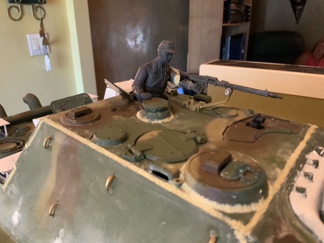

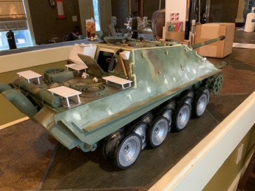

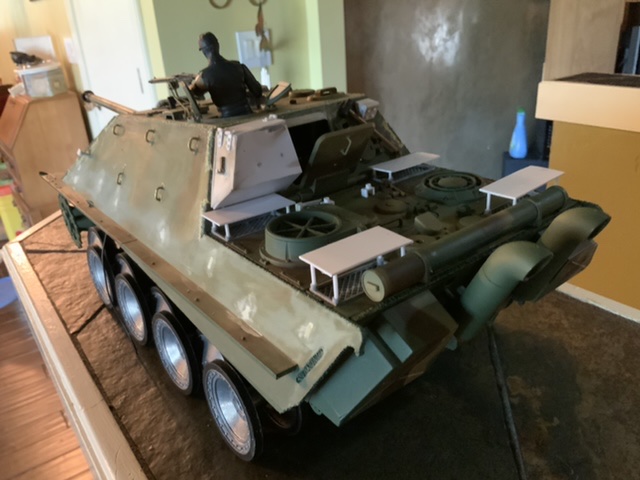

Made some progress on some of the fabrication and tid bits. Modified one of the crew to man the MG. Working on supplemental armor and waiting on metal drivers and idlers. New Mato bearing motors are in. Additional outboard support bearings in place on drive axles.

PalePainter,
It is shaping up to be another Beauty indeed. The extra armor and stowage box are a treat!
