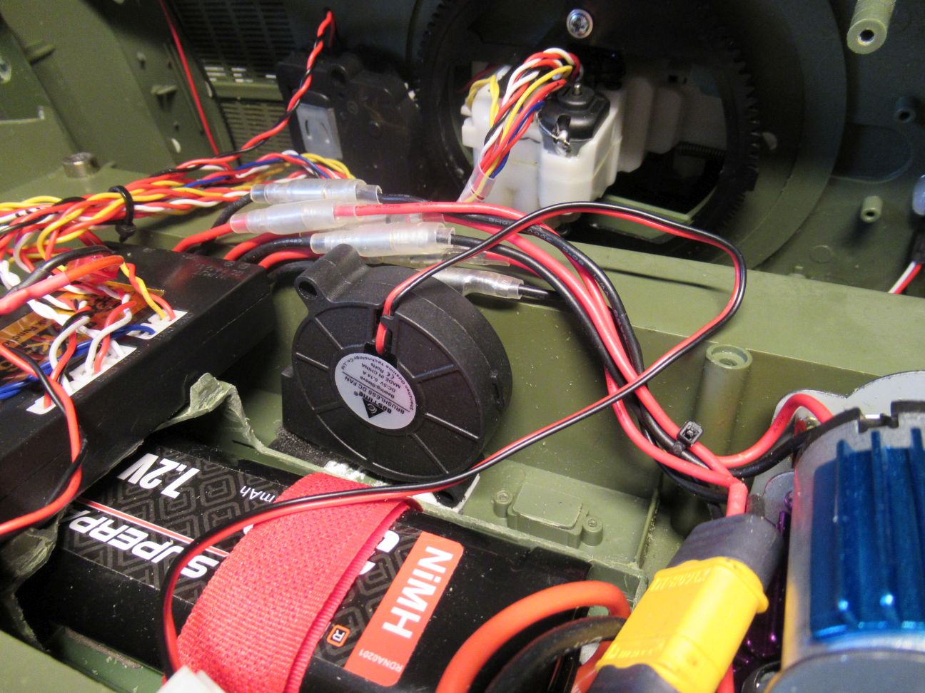

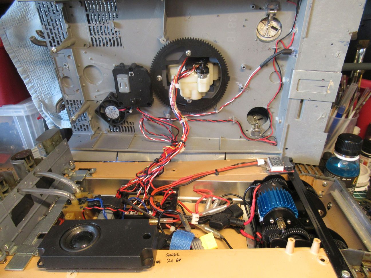

I have three HL tanks (Tiger, with Taigen hull/gearbox/motors, T-72 and Sherman) all of which have full metal running gear, and are heavy as a result. I started worrying about the electronics overheating, so all three have 5v fans plugged into the output on the 6.0 board directing cooling air. I noticed that the motors were getting warm also, so I added some heatsinks (Tiger pic attached). Having run my Tiger for long enough to deplete a 2s LiPo, I found that the heatsinks on the 390 motors were much too hot to touch! The Tiger has open grilles at the rear, and I’ve fitted opening front hatches, which I now leave open while running for air circulation. I’ve also vented the cases of the 6.0 MFUs. The Tiger also has in-line fuses on the motor leads, just in case.
I’m thinking of adding a second fan in each tank to cool the motors. I’d be interested to know what anyone else may have done, and if there are any good ideas I can steal….!

Thanks for the info. I'll worry less about the motor heat, but I think I'll look at some additional cooling anyway. Directed cooling is certainly the best - I'm using it in a temporary installation in my Sherman with a blower fan (pic attached), and I've yet to vent that MFU. I've drilled holes in the hull side by the fan intake, and the air can exit via the deck grilles. More fans on order....!
