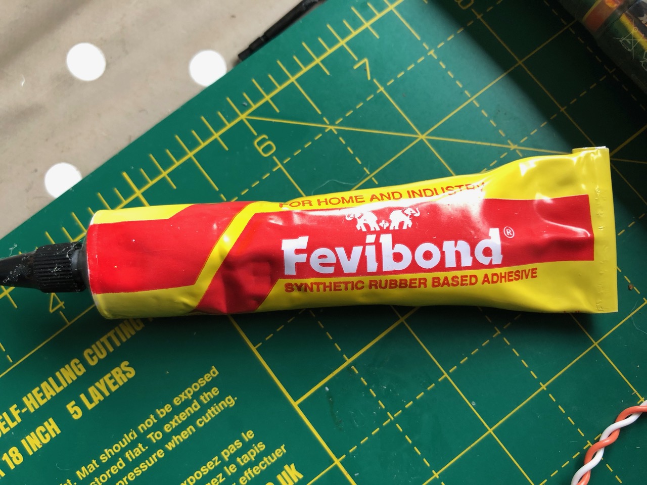

Synthetic rubber glue, on 1/16 scale Tamiya models, is used to assemble the MG components, and to bond the unit into the glacis plate. It's rarely used elsewhere. On 1/35 models, it's used to bond the tracks together, in the main, and perhaps in places where it may be necessary to remove a part in future- for maintenance, or repair. The bond is, thus, fairly flexible compared with cement. Cement is used to form a permanent plastic weld.
I use this rubber adhesive product:
Fevibond synthetic rubber adhesive

43rdRecceReg wrote:Synthetic rubber glue, on 1/16 scale Tamiya models, is used to assemble the MG components, and to bond the unit into the glacis plate. It's rarely used elsewhere. On 1/35 models, it's used to bond the tracks together, in the main, and perhaps in places where it may be necessary to remove a part in future- for maintenance, or repair. The bond is, thus, fairly flexible compared with cement. Cement is used to form a permanent plastic weld.
With that in mind, do I apply the adhesives whenever I can as I'm building the tank?

Look at it this way; if you need to bond plastic to plastic (ABS to ABS or Styrene to Styrene) use plastic cement. This will probably apply to a large percentage of the model. Elsewhere, specific non-plastic parts may require super glue or epoxy, and the rubber glue (fitting tyres on wheels, for example).
