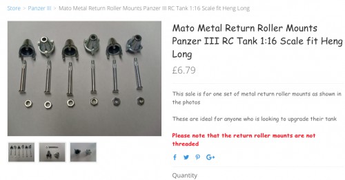

This is a screenshot and paste from Forgebear's website. It will give you another option, should you damage your existing rollers.
Mato Pz 111 return roller set
Click on the pic to ENLARGE it!
https://www.forgebeartanks.com/store/c1 ... ducts.html
Forgebear is a highly valued member of the Forum, and top vendor too- just in case you hadn't noticed. :thumbup:

Morning I've just realized I didn't answer.
Firstly Herman they didn't come with the metal mounts.
I got everything in the picture above bar the mounts so I got the spindles and bolts. got inner and outer rollers.
I take it I have to glue the two rollers together? as they don't hold together.
