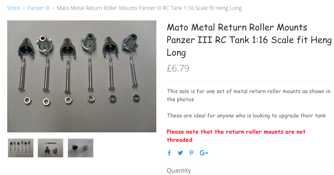

This is a screenshot and paste from Forgebear's website. It will give you another option, should you damage your existing rollers.
https://www.forgebeartanks.com/store/c1 ... ducts.html
Forgebear is a highly valued member of the Forum, and top vendor too- just in case you hadn't noticed.
Click on the pic to ENLARGE it!https://www.forgebeartanks.com/store/c1 ... ducts.html

Re: Stug III return rollers
Morning I've just realized I didn't answer.
Firstly Herman they didn't come with the metal mounts.
I got everything in the picture above bar the mounts so I got the spindles and bolts. got inner and outer rollers.
I take it I have to glue the two rollers together? as they don't hold together.
