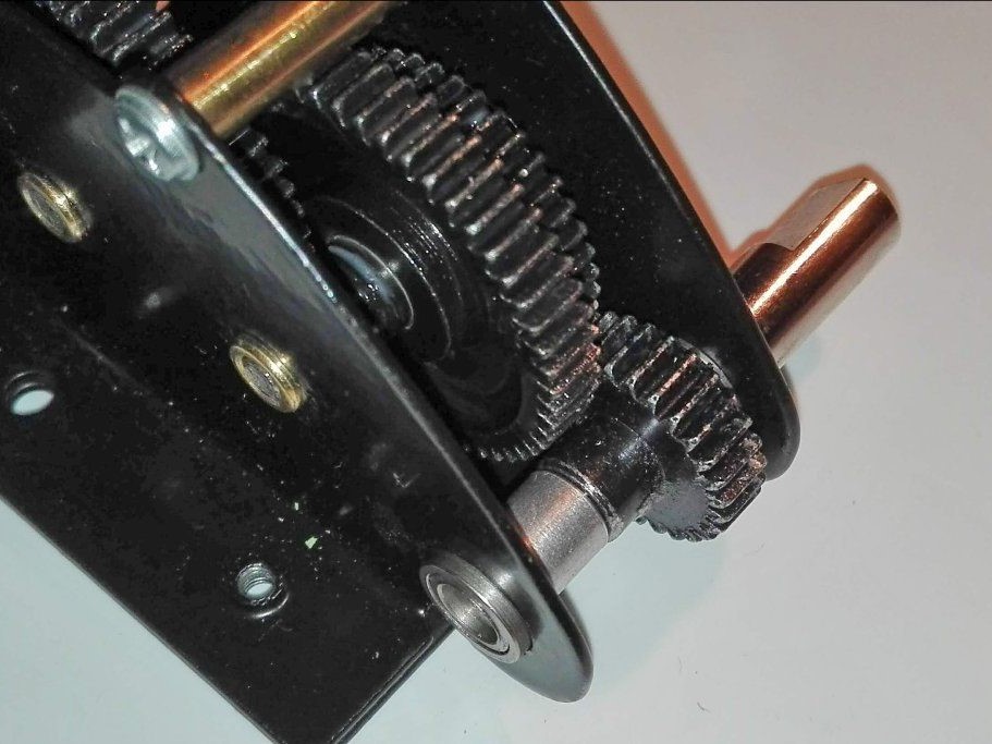

In case of Panzer III there is room for modification of gearbox. My father modified last gear. It required some cutting an using lathe for new shaft. Now it have lower speed, bigger torque and lower usage o power. Photos before and after.
